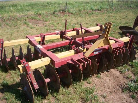

There is an auction coming up in my neck of the woods, and I am wanting to buy a cultivator with 3 or 4 feet, and a 6 foot harrow. My uncle will teach me how to farm a little garden with the tractor. I found these that may match what I am looking for:
Here are the cultivators that are listed:
KMC 6RW cultivator (hyd fold)
Taylor-Way 6RW cultivator (hyd. fold)
(2) Pittsburg 6 row cultivator
(2) Pittsburg 2 row cultivator
they will be used on a 55 engine hp tractor. I did a google search for images for 6 row cultivators, and they look too big. The picture of the 2 row Pittsburg cultivator looks like what I need. Here is a picture in attachment.
Here is a picture of the disk harrow that is being offered, which looks like it will work. the auction offers two discs that may work:
Tufline 6 offset disc
Taylor-Way 6 3pt. bog disc
by th way, the auction is at Mason Auction & Sales LLC. Mason Auction & Sales LLC
will this equipment match up well with my tractor?

You won't have any probem pulling either one of those pictured with 55hp tractor. Just measure the overall width of rear tractor wheels to make sure it isn't over 6', you want the implement wider than tractor so not running over the fresh truned ground.
   / need advice for auction
Thanks, makes sense:)
