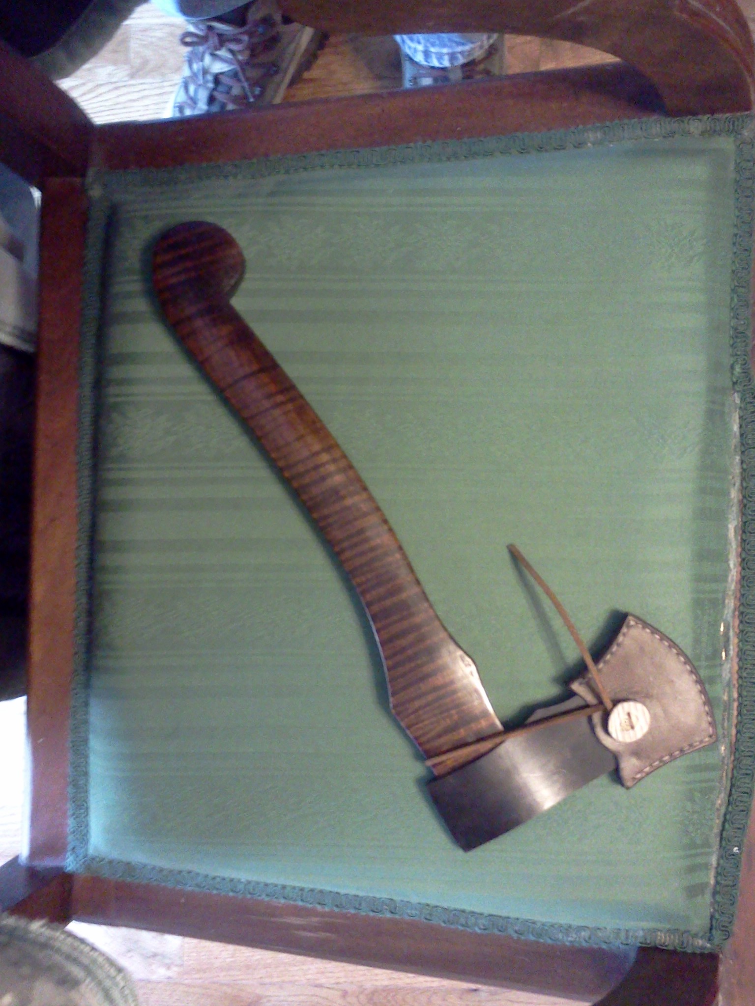

You can make one faster than you can find one. Rough it out on a bandsaw and use a drawknife or belt sander to get it to shape. You will be surprised how quick you can make one. I like the thinner handles and I like the octagonal flats on a handle. Not many people really use an axe anymore and that is one reason the factory handles are so clunky.
I made the belt axe and handle in the picture below. The handle is curly maple. The handle is pretty thin.

Very nice, I use to make pistol/revolver grips.

No need to remind me to never to cheat at cards in your parlor!
Do you always keep an axe under your chair?
Nice looking handle.
