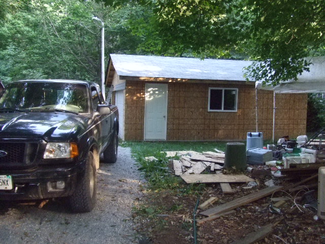

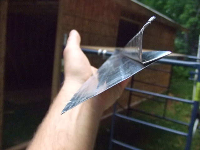

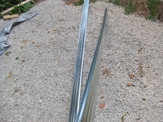

Thanks for your response, hope these few pics give you an idea. I think doors and windows are fine, just that I have about 24- 8 foot lengths of the flashing (all the same) just wondering what to do with it all?
I hear what you are saying on the shingle, I think now that I can get the flashing on under the starter row. any thoughts on the other spots? Thanks :)
oh and the garage is 20x24
siding is vinyl I tacked a piece on the front just to give idea

The metal is a starter strip for siding, snap a level line around bottom of wall to were the starter will hang below the foundation about an inch.The vinyl siding snaps on the starter strip and nails on the plywood wall, but don't nail to tightly. The house wrap should go on before windows are installed but you can get some tyvek tape and apply around them. You also need J channel to wrap windows and door trim and outside corners for your four corners. If you are enclosing your soffit you will need vented soffit panels and fascia wrap either pre-bent or borrow a aluminum brake to bend fascia cover.
Sure it's not a drip edge for roof shingles, that's what I've used it for, could be a multiuse I guess. For drip edge, you flip it over from the way you've got it held so the long edge goes up under the starter strip :2cents:......Mike

Yeah it looks more like vinyl starter strip. It also looks like you forgot to put drip edge on the roof along with alum over the fascia, unless you are just going to paint it. Hard to tell from the pics
Thank You
As suggested I managed to get the drip edge ion today, slid it under starter shingles. Yes I have fascia just have not put it up yet. The package I got for 5 grand almost exactly came with everything, including nails/tape, you name it.
