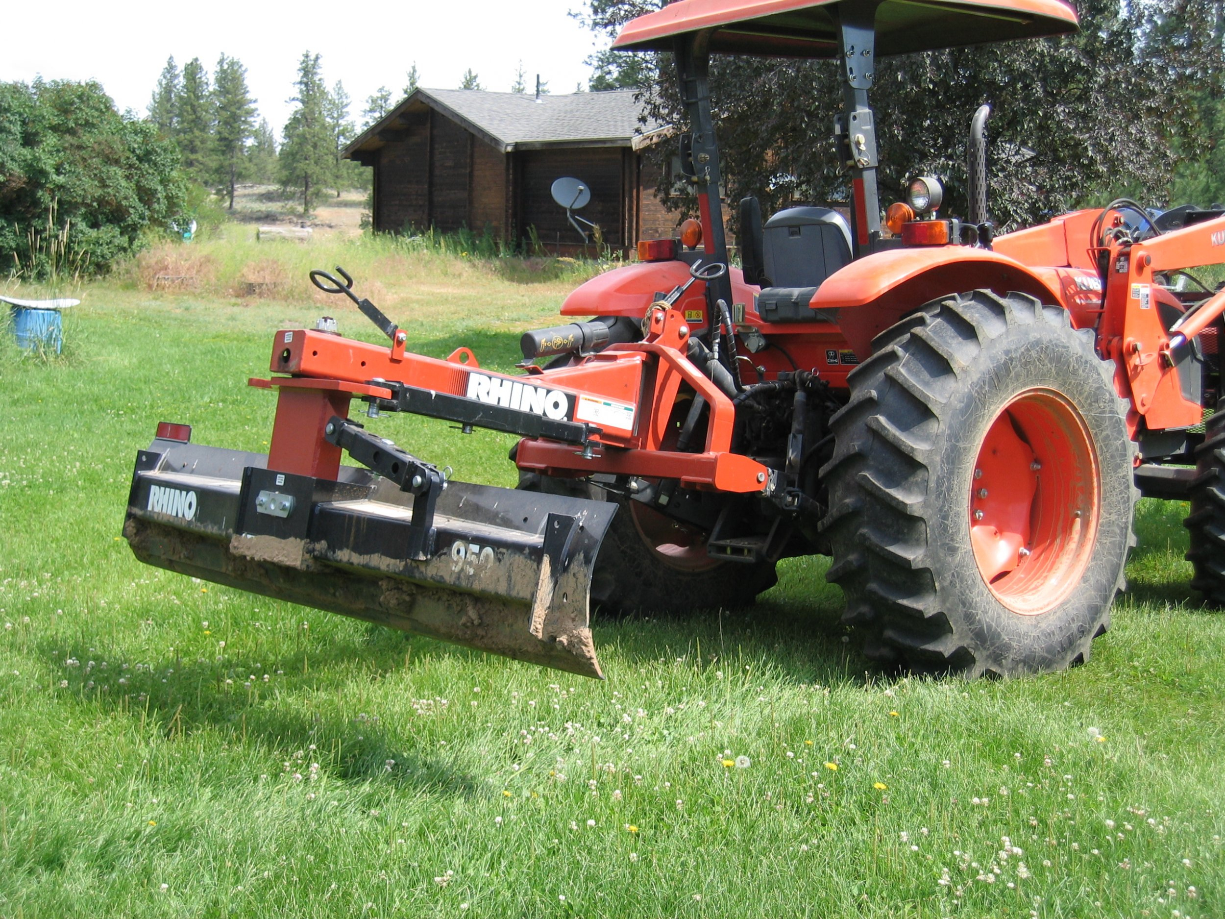

For 25 years I had a rear mount - PTO driven - snow blower. My driveway is a mile long and gravel. I can vouch - this setup is a real PITA.
Consider getting a heavy rear blade. You can go like the wind and curl that snow completely off the driveway.
I have a Rhino 950 @ 1050# and 96" - behind my Kubota M6040. It's very fast and very efficient. Offset and angled - don't have to get right up next to the edge of my driveway. A rear blade sized for the tractor you purchase would be a very efficient snow machine.
