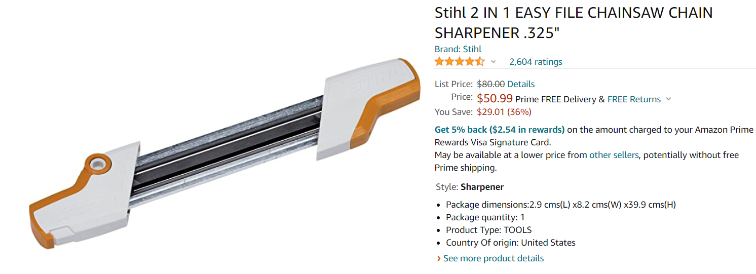

I am a few years older than you and have been clearing an acre of dense woods this past summer with maple, oak, and pine.
I have 20" Husqvarna so I have been doing similar work with similar equipment.
This isn't what you asked for but this may fix part your problem if you haven't used one before.
I can do it while on the bar, it is fast and accurate.
I keep a small vise mounted on a table to clamp the bar and it takes maybe 5 minutes.
I make about 4 strokes per tooth and it is as good or better than new.
I saw a noticeable difference in how much I could do in a day,
Others can help you pick out a chain saw but I would recommend getting this to help with fatique.
Hope this helps.

I've got one. It is great. I've also got files and an electric on bar sharpener. The one you showed is the one I use the most. Quick and easy and does a good job.
