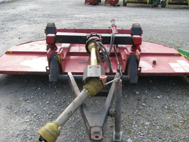

Hi, I just bought a used Bush Hog 2510 and am trying to match it up to my Ford 5900. My question is this, in the on line bush hog manual it appears the pull bar point must be 14 inches past the PTO shaft on the tractor. It also says you must have at least 6 inches of overlap in your driveshaft. The way my pull bar is right now, I only have about 2 or 3 inches of the one shaft inside the other. I know I can move my pull bar in some, but I would need to move it in at least 4 inches to have the adequate lap, but this may only leave me 12 inches or so of distance from the shaft to the pull bar center hole. Will this work, or do I HAVE to stick to the 14" recomendation?? Thanks for any help

The way mine is set up, the shaft I am talking about is pretty short, Im going to try to show a pic, kinda seems like there isnt a lot of room to play with. I also want to add I really appreciate your guys input, I dont know much about this, but with some help I will figure it out. I have bush hogged quite a bit before with a smaller tractor and a 5 foot bush hog, there just a lot more things to consider with a larger machine. I also noticed that with the draw bar in the position it is in now, that the hoses were a little snug when I hooked them up to unload it off the trailer, so that too suggests the draw bar needs to be shortened.

In the order of cost to you I first hope your draw bar is adjustable like mine. I can pin it long or short. Hopefully yours is the same. If yes, push it in and pin it with the least amount possible sticking out. Downside may be the pull bar hitting a tire in turns. If not, the PTO adapter and ORC will give you a short extension - but don't expect more than about 4". On the negative side, there's the potential wear increase factor involved with this option. Third would be to modify the shaft segment that goes between the tractor and the pull bar. You can buy a splined coupler and female shaft alone, but get a shaft that's considerably longer than the one you're replacing. That will in effect get the tractor end of the shaft closer to your PTO spline. It does however, make the forward non-overlapped section vulnerable to twisting. Last but most expensive (yet safest), would be to replace the whole PTO shaft section between the tractor and the pull bar.
//greg//
   / need advice on bush hog driveshaft #10
The actual ASAE standard distance for a 540 RPM PTO is 14" from the end of the tractor's PTO shaft to the center of the drawbar pin hole. If the new to you cutter has a conventional PTO shaft (not a Constant Velocity joint at the front yoke) the driveline will chatter like mad in a moderate turn with the hitch attached as per ASAE standards due to the hitch pin not being centered between the front and rear PTO shaft U-joints. Shortening the tractor drawbar, or adding a shaft extender or slipclutch to the tractor's output shaft will cause more driveline chatter and EXPONENTIALLY increase the possibility of twisting/breaking your tractor's PTO shaft off.
The correct course of action is to replace the cutter's PTO shaft tubes (and shielding, if necessary) to provide the required minimum overlap when the tractor drawbar is set to the 14" ASAE standard. If longer hoses are required, add short hoses, or replace the existing hoses with longer ones. Ideally, the R/C would have a PTO shaft of the proper length and a CV joint at the front. Cost of this option would likely be prohibitive.
