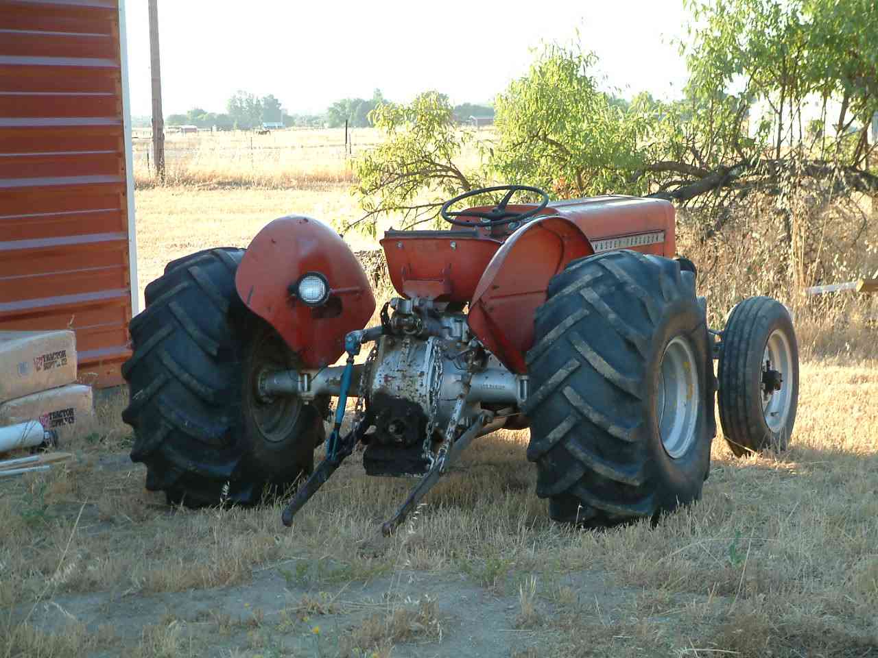

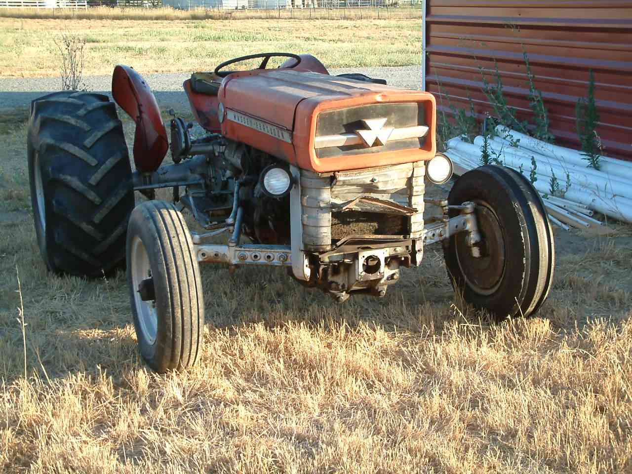

I paid $3600 for a 1964 MF135 diesel with Multipower in 2006. Showed 4600 hours. It ran fine. The sheet metal needed work.
I stripped it down and repainted it.
The previous owner had modified it to squat low for mowing and discing work in his olive orchard. The rear tires are 18.4-16 6-ply (16" dia rims) that he salvaged from an old combine. The front axle spindles were shortened to keep the tractor level.
There's a weep hole on the bottom of the clutch housing. There should be a loose fitting cotter pin in the hole. A few drops of oil or transmission fluid leakage is normal for a 60+ year old tractor. If there's more leakage it probably means that the rear crankshaft seal or a transmission seal is leaking. It's a major job to fix these since you have to split the tractor.
Check the 3 point hitch for proper operation. This can be a problem area for those old MFs.
If that 150 has Multlipower, check it out thoroughly in all gears. The MP on my 135 only operated in the Low range--High Range was not operative. No problem for me since I used the 135 as a parade tractor.
Good luck.
