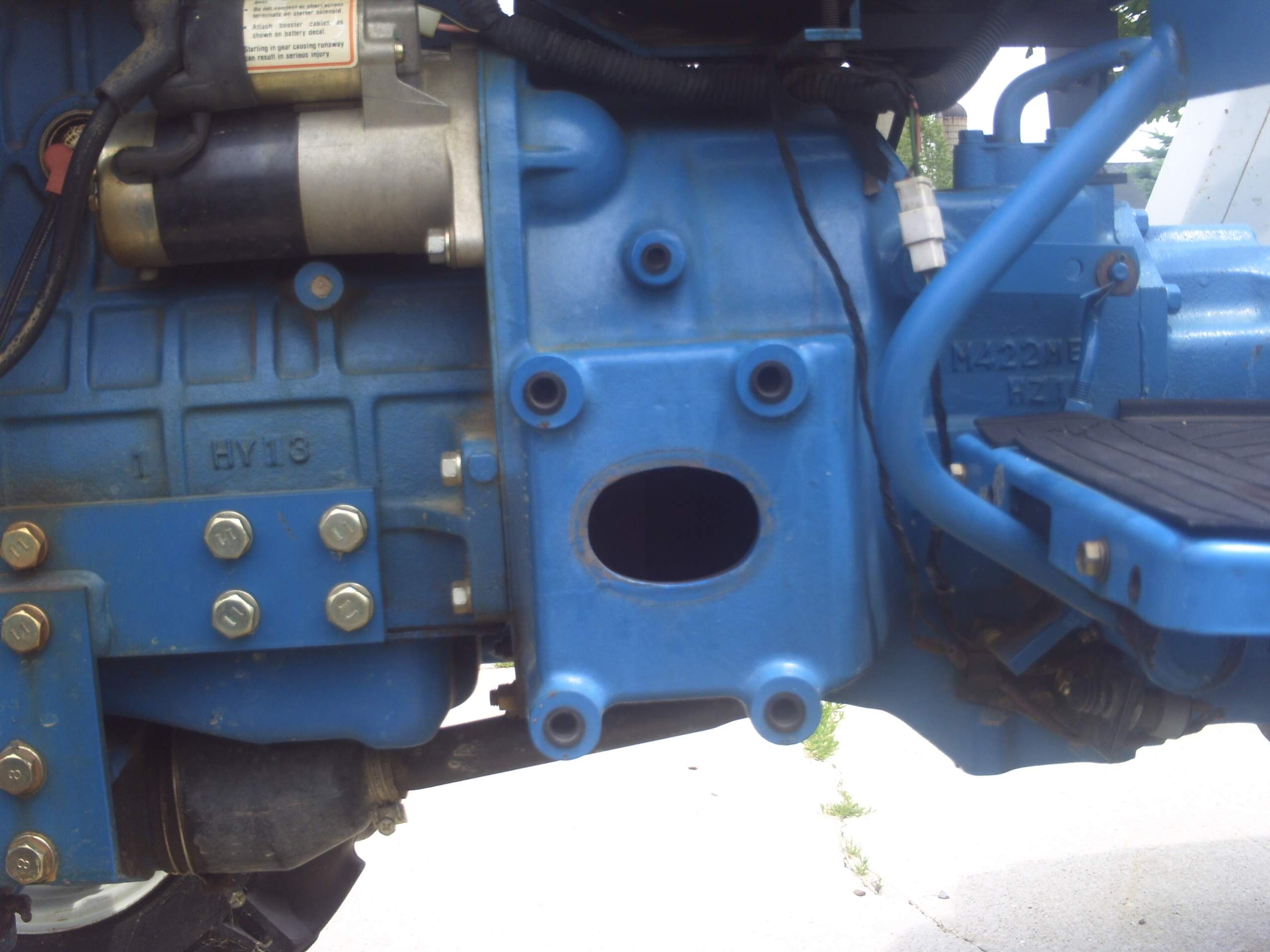

1993 1715 bare bones. 600 hours maintained well. Very low torque when PTO is turning deck mower, for example. At normal power, RPM's remain normal, but PTO rotation and tractor speed slow considerably, especially on inclines. The deck mower has always slowed a bit in thick grass, but this is different - the PTO rotation and tractor speed almost stop.
I know better than to attempt this repair myself, but I'd like some advice on some simple checks before I have the dealer come out and pick it up. Also, if the clutch on this is bad, how can I keep the dealer honest on repair costs? What's reasonable? Thanks.

Not sure if it's live, but. . . There is no inspection hole/window anywhere on ther right. An large oval rubber bootie on the left, but it's located in the middle of a hole pattern so I suspect thats for hydraulics which I don't have (loader).
When transmission is in nuetral, pto still spins - does that indicate live or single? Cluth pedal connects to linkage above pedal and pushes an actuator when fully depressed. I can post a picture if needed. Thanks.

In transmission driven (single clutch) PTO, the pto will continue to turn in neutral if PTO handle is engaged. same happens with live clutch. One way to make sure is to do the following:
with tractor running, clutch all the way, engage pto lever, put the tractor in gear, let go of clutch and start moving . you should be moving forward and pto turning. While you are moving clutch halfway, that should kill the power to the wheel, tractor should come to stop while pto remains turning. in that point while stopped if you push the clutch pedal all the way down then PTO is stopped. if you can duplicate it then you have live Double clutch ) PTo.
post a picture on the oval boot that you are talking about. on 1700 oval boot is on the right side and you can inspect and adjust clutch in the clutch housing.

   / Need advice on NH 1715 PTO Issue
Based on what you describe, this is a single clutch system. PTO and transmission both stop simultaneously.
I took the boot off the access hole on the left side I described, and it may provide access to adjust the clutch. Picture provided which also shows the pedal with linkage and actuator. Thanks.
Kgiovann,
Yes that is the access for clutch adjustment only if you have double clutch. clutch adjustment on single disk is done outside and basically is adjustment of release bearing surface to pressure plate fingers. no adjustment as far as pressure plate can be made. In other word if clutch disk wears out beyond it's spec then pressure plate/flywheel and disk in between will not be able to maintain adequate torque.
With single clutch, engine off, PTO engaged, gear in neutral, clutch pressed in by help of a block of wood and then you can simply turn the clutch disk by help of a some sort of stick or a screwdriver. clutch disk is free to spin since pressure plate is not pushing against the disk.
Now one way to check if clutch disk is slipping or not is to maintain all the conditions above minus engaging the clutch ( clutch pedal all the way up) and tractor in some gear rather than neutral. In that fix you can have an assistant to try to turn rear pto shaft by using a pipe wrench. if clutch plate is gone and you do not have much grabbing force than you can see with the aid of a flash light the slippage of the your clutch disk. in this fix pto should not be able to turn unless clutch is slipping. don't put too much torque on the pto shaft, and keep watching the action thru the peep hole while your assistant tuning the wrench.
All I'm saying is that you might have enough torque to move the tractor but not enough to operate the pto using a heavy, torque intensive implement. You might have issue with your pto ORC (over running clutch) as well and that's a whole different scenario.
Replacing a clutch disk would be an easier endeavor. Test it out and report. I would not go overboard on turning the pto shaft with mechanical advantage. don't want to bust any gears just want to check clutch slippage.
