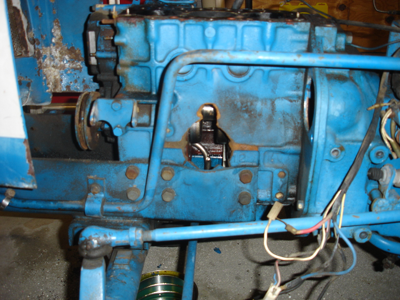

Just an update. I've done some disassembly and I don't think this engine is going to run again. :laughing:
I have gotten a lot of good parts though. The intent is to sell most of the parts but when you are taking apart a tractor just like the one you own it makes it hard. I keep thinking "that would be good to keep" on just about everything.
It has been good to see how this is put together and comes apart. One thing I will say about these Japanese tractors is that they use good fasteners. As rusty as this tractor is most of the bolts come out by hand after breaking them loose.
As soon as I figure out where to put all the hydro fluid after draining it I can start splitting it in half. Can't wait.
   / Need Advice on Smaller Ford 10 Series #3
wow, did this thing throw a rod. it appears the hole was caused by something from inside rather than out. same thing happened on on push mower ai had with a crappy Tecumseh pot metal engine. Without any warning while i was mowing I heard a big ole bang and something hit my picket fence and poke a hole thru it. i was the lower rods cap that came loose, poking a hole in the side of crankcase and out. It scare the the you know what out of me and I was very fortunate did not hit my kids or the neighbor.

BTW, that rod that let loose didn't just blow thru the cast block. It bulged the .25 thick steel frame. I bet that was very loud.

Looks like the Kubota at work that got a little to much starting fluid !
