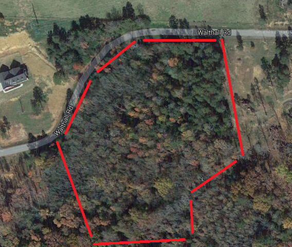

I've just purchased 6 acres of wooded land and need to get it ready to build a shop and house on. It looks to me like one of the skid steer mulchers would be perfect for probably 90% of the job that needs to get done. I want to keep it as wooded as possible, but still be able to get around with a bush hog (rotary cutter ?) to keep it tidy after it's all cleaned up.
I'd like to do as much of the work as I can myself to keep costs down. I was quoted $2,100.00 to rent a Cat 279 and MH 315 for a week, with 40 hours of run time allotted for that $$. Is it reasonable to think I can get 6 acres of underbrush and saplings thinned out in 40 hours of run time on the CAT? I have driven a skid loader before but have zero experience with a mulcher.
I'm open to any and all suggestions. I own a small Kubota 2350 and a 1990's era Long 2610 (approx 60 HP) with a front end loader on it, and a 6' bush hog on the back.

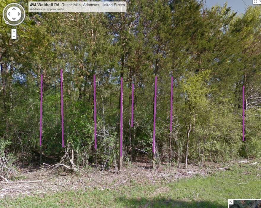

Here's a couple pictures of the property. The front view is typical of the worst of it (the most underbrush, etc) but it thins out quite a bit over the rest of the property. I'd like to keep the trees in purple, but they aren't as close as they look .. most are 8' to 10' apart.
Here's a top view of the 6 acres :

No ideas on mulching, but even 10 feet apart is too close for adult trees if you want them to grow and spread for shade. TOO close and all they do is spindle up tall and thin. Take out all the trees closer than 15-20 feet from each other by selection of the largest and remove the others.
Lots of the small stuff could be just bush hogged under from looks of your photos.

Maybe I should have a go at bush hogging some of it before I start spending money .. can do that for (nearly) free :)

I don't have a great answer for you (yet) but doubt if you can do that much by the look of the picture, in 40 hours. However I have rented a 299D XHP with a HM315 that I get tomorrow AM for a week and will be able to give a better idea soon. I have been doing everything by hand, Stihl large brushsaws and chain saws and am trying to get into the new mechanized mechanical world. Not quite the same issue as you, I have ice storm damaged 20 acres 14 year growth. Answers are few and far between as I have only had one response to my posting the other day as well.

I tried to use my heavy duty brush hog and quickly abandoned that as it was going to destroy the equipment. DBH of the stem will effect the ability to use a brushhog.

Not likely that you will be able to do 6 acres in 40 hours. It takes a long time to become productive with the mulcher, and avaoiding all the keeper trees slows you down. That is a really good rental price, but be sure to do the math. You will burn close to 4 gallons/hour in fuel. Pick up/Delivery if you can't haul around 15K lbs. They will probably charge you for any broken teeth, so be sure to ask how much they are. The machines also break, so be sure to clarify who pays that. When it's all added up, it will probably be close to what a local guy can come do it for without the risk to you, and your time can be spent doing something else. They will (should) produce a better finished product in less time than you, if they have been doing it a while and have a capable machine.
