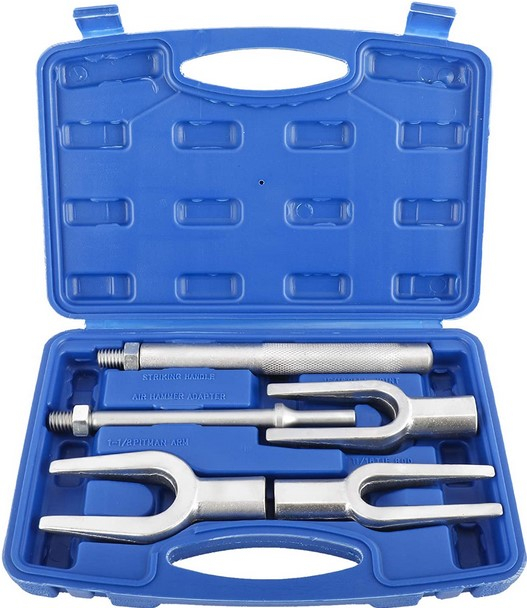

Get one of these kits. Available on Amazon for under $22. I wouldn't heat anything. I've seen guys that broke the tie rod hole or steering knuckle from heating and hitting with a hammer.

They make small pullers for tie rod ends. With a puller the force is on the end of the threaded stud and not sideways on the steering knuckle like with a pickle fork.
