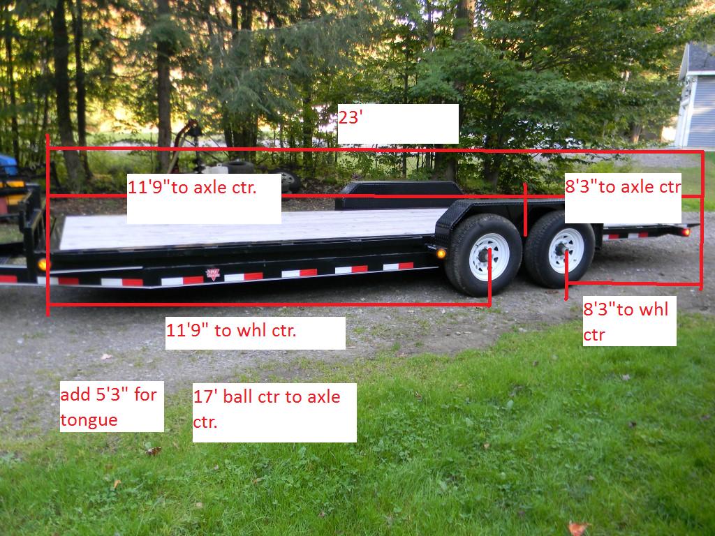

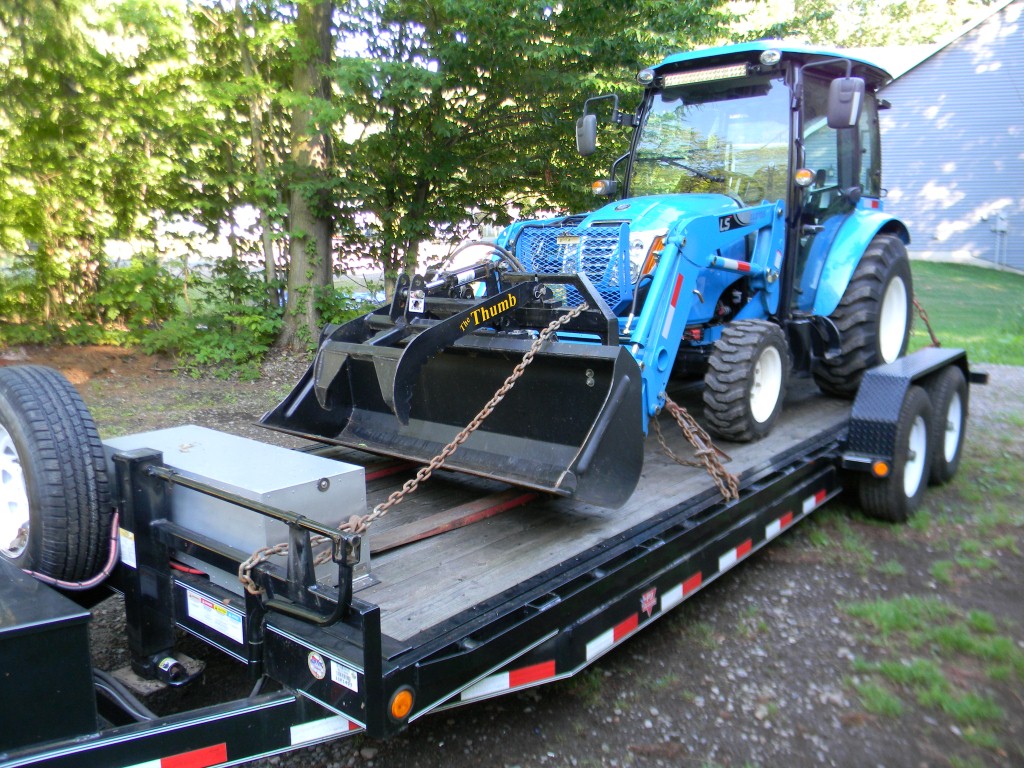

Sounds like you have all the bases covered. I've been very happy with my 22' 14k PJ model TF Full Tilt trailer for the past 3 years. Low 22" trailer deck height, easy to balance load, 82" between the fenders, axles are located back far enough, easy side loading. Even with my 2500HD and fully loaded trailer I'm under 26K. PJ has deckover tilts too. I've attached a pic with tractor on trailer and an empty trailer with measurement specs.

My fenders are fixed. PJ says the are easily removable but they are bolted on and have clearance lights so they aren't easy. They are also taller than fenders on my previous tilt trailer which can make it hard to open a car door.
The pivot point is behind the rear axle so gravity tilt would not work.
Axles are placed further back like a standard trailer allowing for greater tongue weight when empty. My PJ weighs around 3860 lb. empty but it is 14K rated. My truck has 15K tow cap.

That's a good looking trailer, my Stryker tilt bed is very tongue heavy but after hauling everything from a few hundred pound lawn mower to about 12,000 lbs. of tractor and equipment on it I think I like it. I have a wench on mine and when a couple of young fellows broke down just down the road from my house their Dad was real grateful I had it. I loaded them up so easy I did not even charge them for the tow. :)
