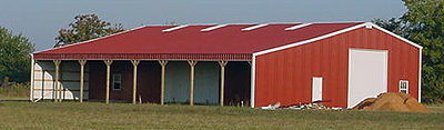

   / Need advice/suggestions on metal building mfg/install #6
What about 40' wide x 60' long pole barn with 14' sidewalls. Place a roll up door on each end, maybe 16'wide by 12' tall. Put a 12' lean-to (open) on each side of the building. You could back your deck-over and car trailers in from the end of the lean-to and put other equipment (tractor buckets, discs, etc...) in from the sides. You should also be able to get the dozier in from the end of the lean to. I would concrete the floor in the main building, but use #57 stone for the floor of the lean-to.
I would just let the track-hoe sit out in the rain. Too heavy to try to get on the concrete floor and that's what most people do anyway.
Look at the following picture. A building like this, but with a lean-to on each side. Your building would be 60'x64' total. You would leave one or both ends of the lean-to open to back in the trailers.
