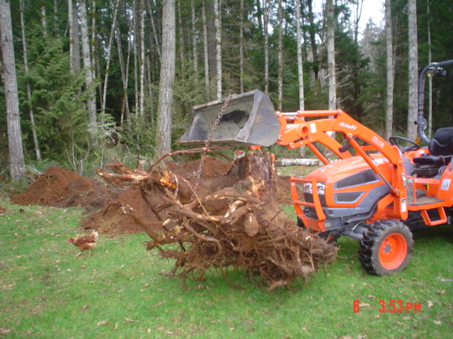

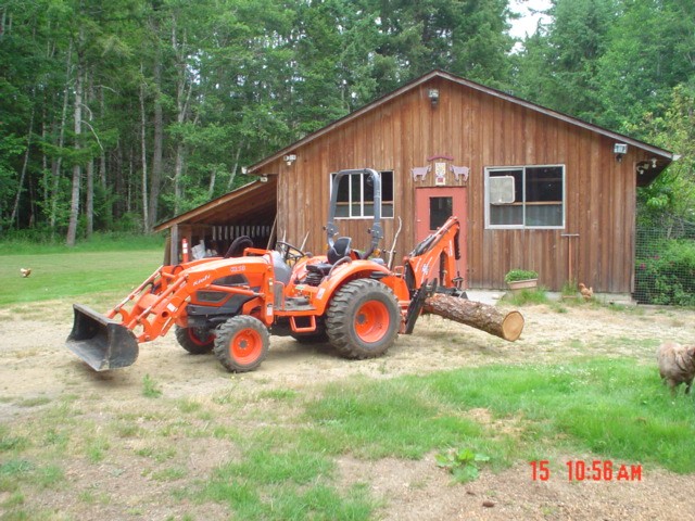

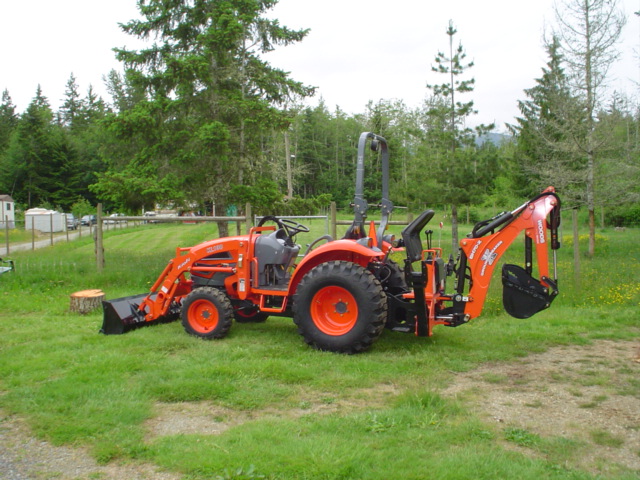

I have the CK35 HST and find it has exceeded my expectations for my use. The DK is a heavier machine and maybe what you need for the type of work required. It also has some features not on the CK models. I have a Woods 7 ft backhoe on my machine and have lifted and pulled logs out of the bush. With the backhoe it does add weight to the tractor. I'm one of those guys who wants (not necessarily needs) bigger and or better but in this case the CK35 has worked well for me. At some point how big a machine do you get? I went with the R4 tires and glad I did.
