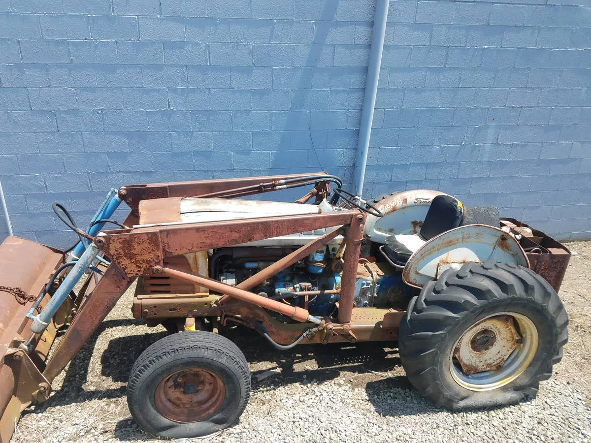

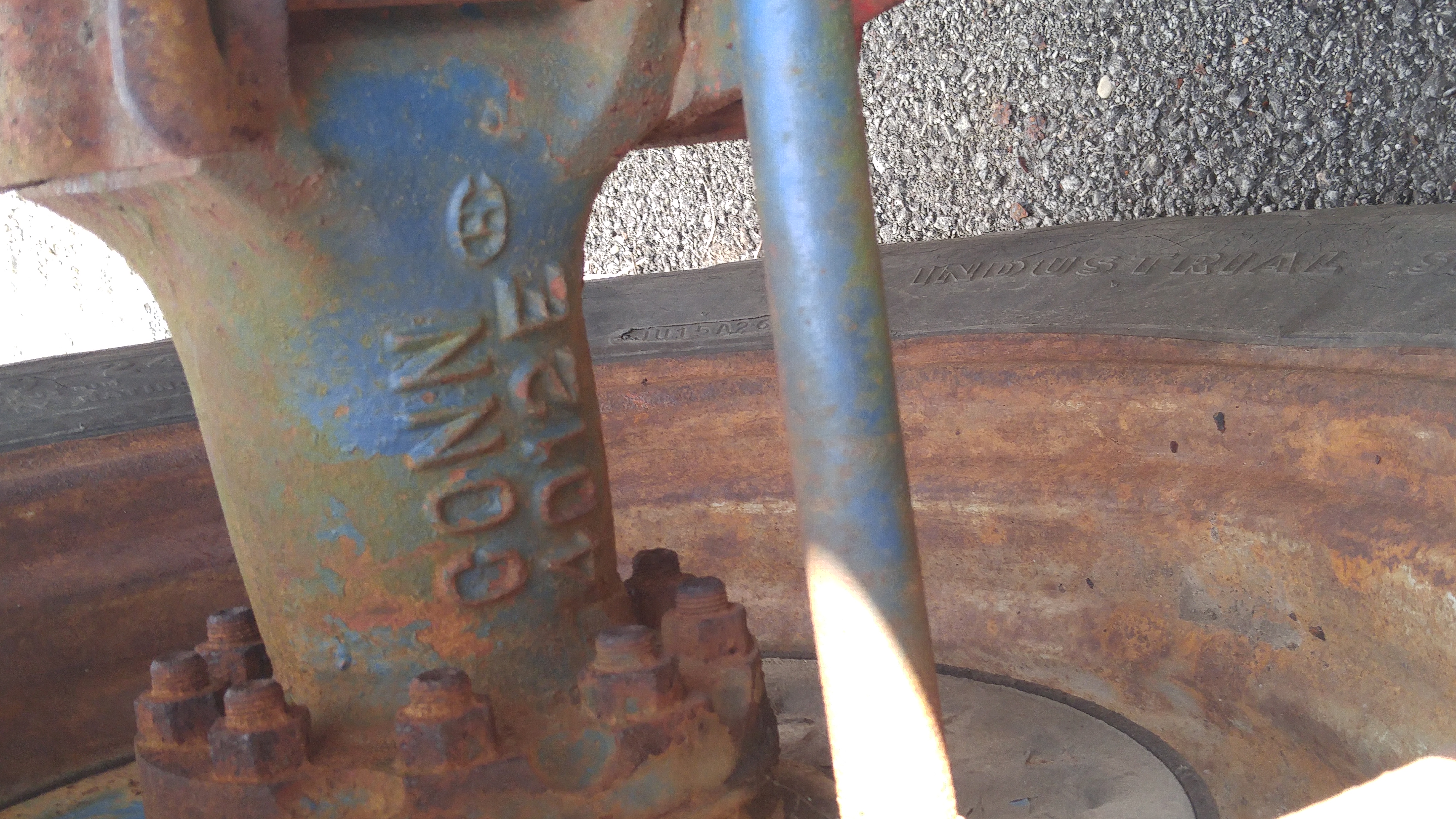

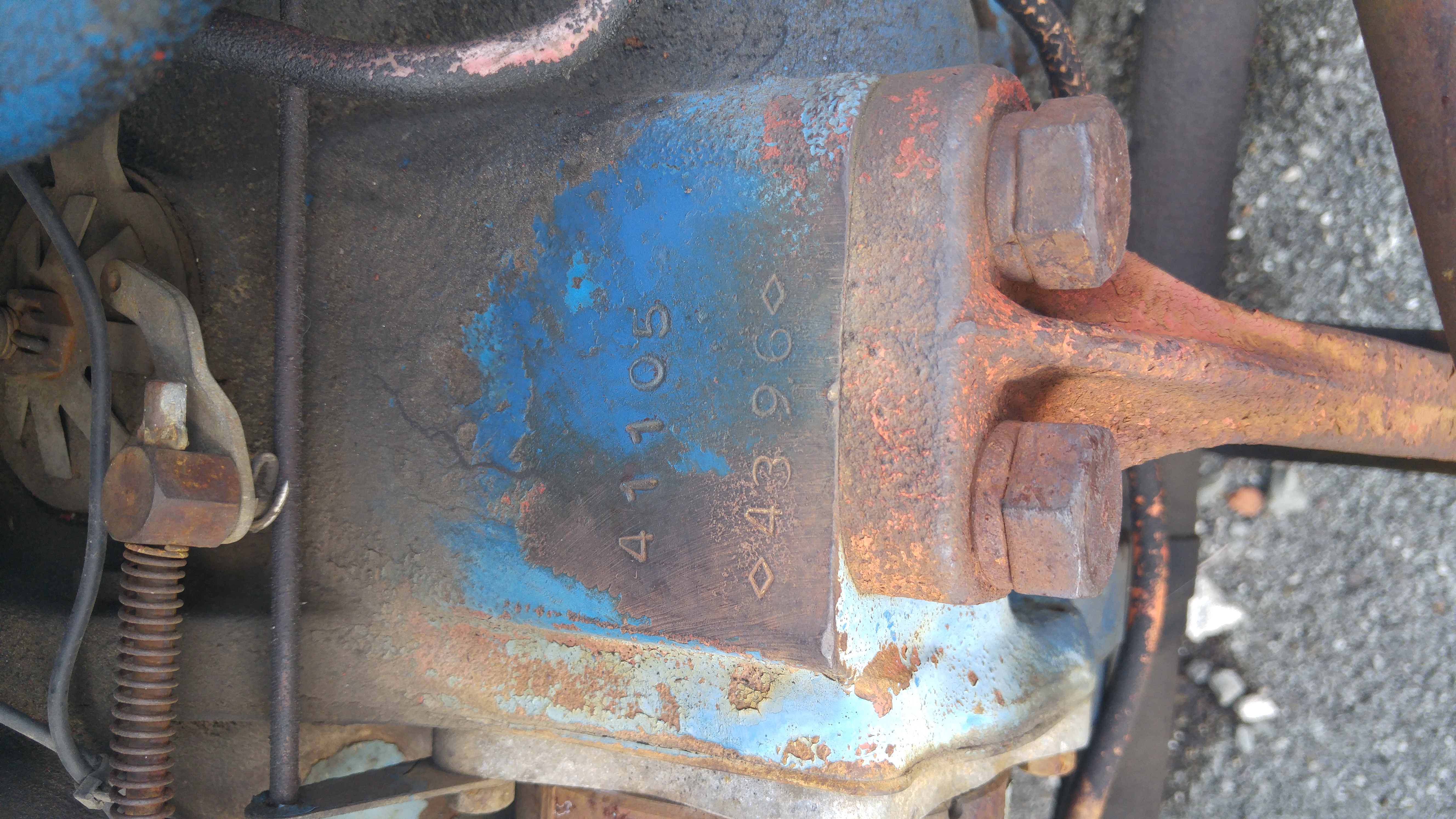

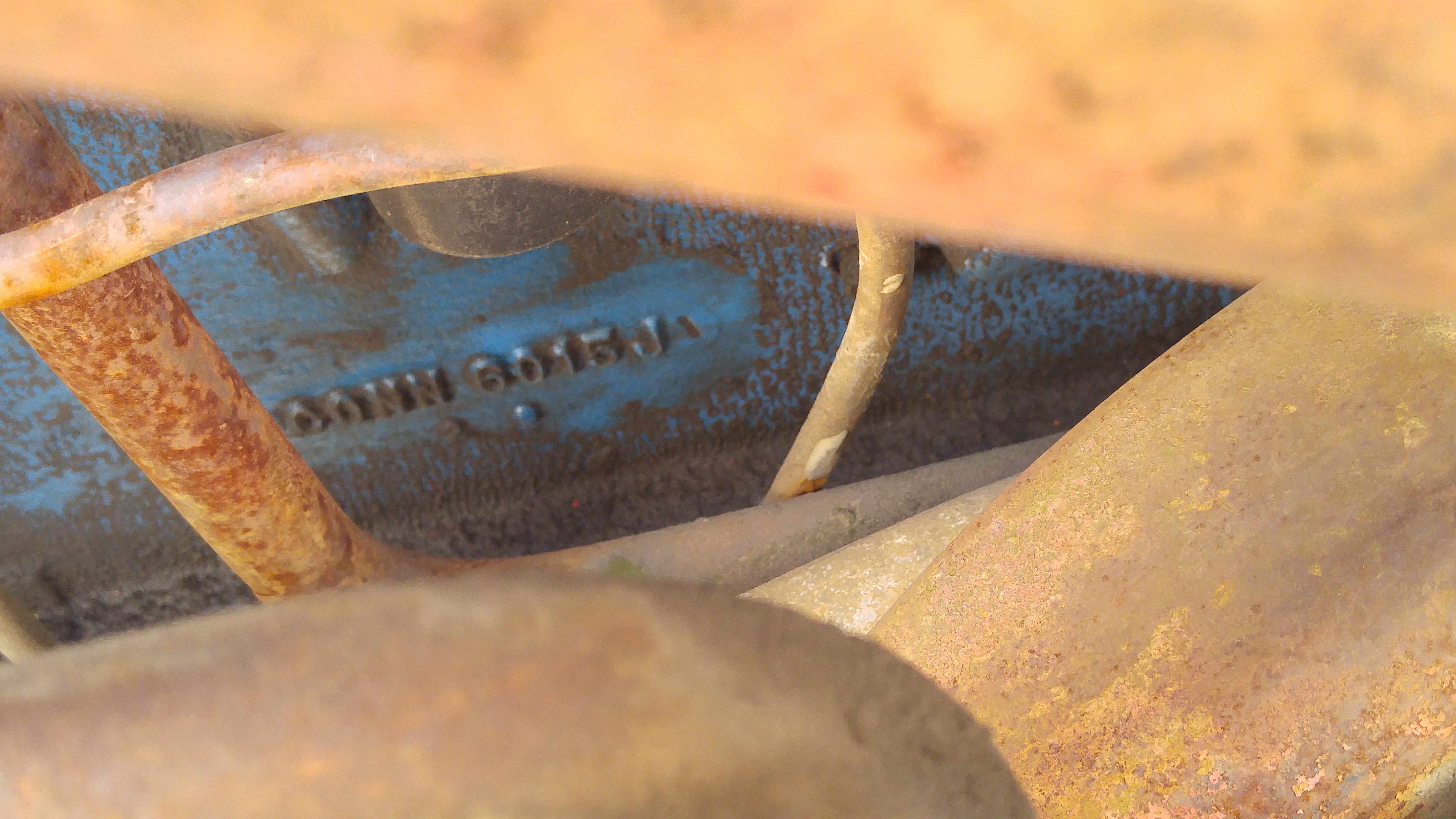

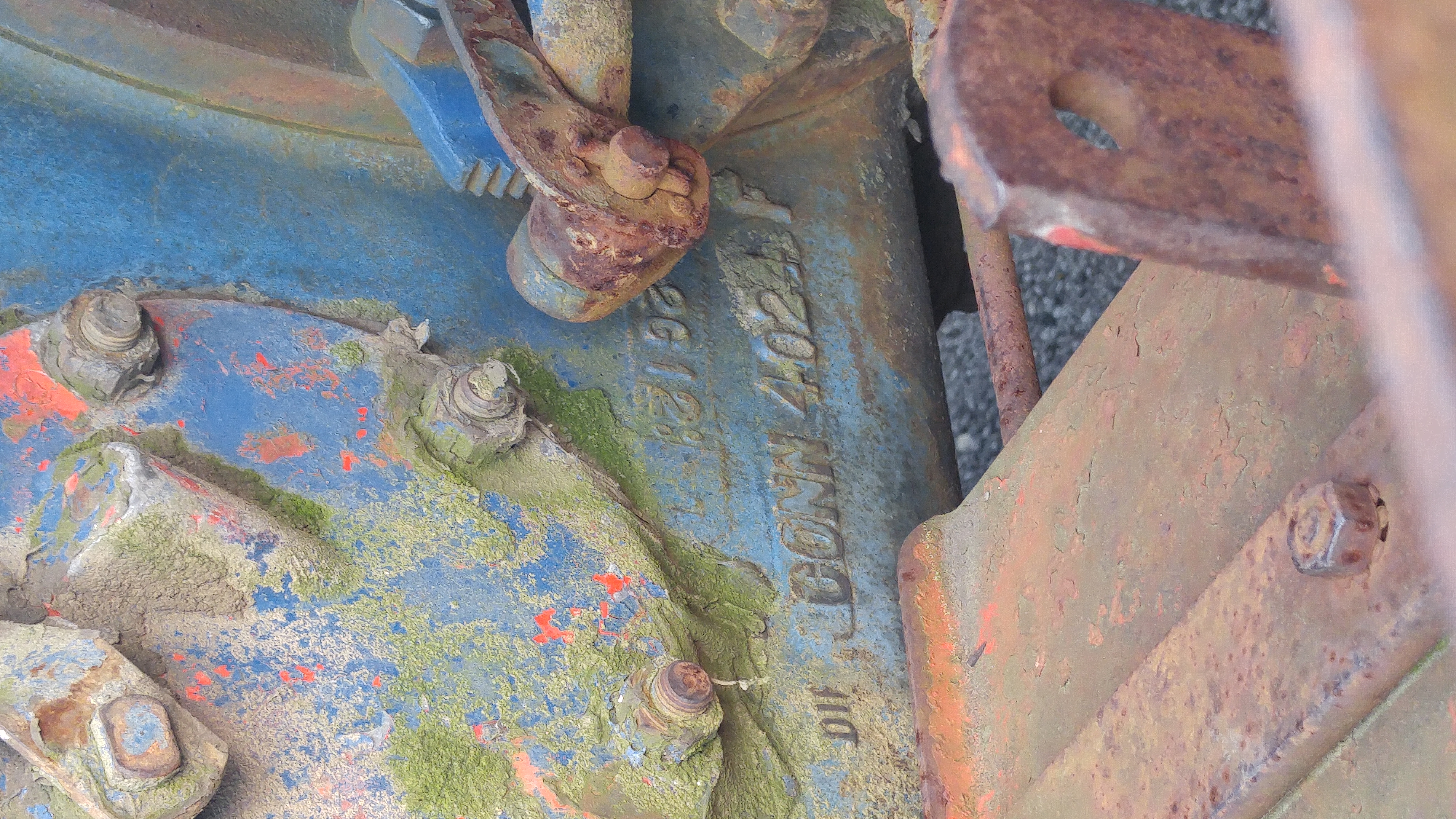

I am looking to pick up this Ford Industrial tractor hopefully this week,nothing big broken,runs,nothing crazy.Can someone help me determine what model,year and anything else about it.It appears Industrial tractors are harder to id then ag tractors. TRACTOR4.pngENGINEID.jpgAXLEID.jpgTRACTORSERIAL.jpg
TRANSID.jpgView attachment 515795

Scroll to the bottom and follow the link and you will see your info. I pasted the pertinent info here
You have a model # of 41105
(4) Suggests 172 CI engine
(1) industrial or ag made after 1963
(10) suggest row crop, but that doesnt look to be a row crop
(5) suggests Select-o-speed with 540 PTO and hydraulics
Could be a tranny of a different tractor

Part number identifiers cast into 134 and 172 engine blocks (lower right side)
EAE 6015 - 134 1953-1957
EAF 6015 - 172 1953-1957
310905 - 134 1958-1959
310609 - 172 1958-1959
B9NN-6015C - 134 late 1959 early 1960
B9NN-6015A - 144D late 1959 early 1960
B9NN6015J - 172 late 1959 early 1960
B9NN6015B - 172D late 1959 early 1960
C0NN-6015G - 134 sleeveless late 1962-1964
C0NN-6015H - 144D late 1960-1964
C0NN-6015C - 172D-G late 1960-1964
C0NN-6015J - 172 late 1960-1964

So I guess its a 1962 model 44105?

It appears my soon to be tractor is kind of a freak.lol

It's likely that the trans and maybe the rear have been switched out. Hood color would indicate an 1801. The steering rod would indicate a 4000. So basically you have a 4000 Heavy Duty industrial with an Select-o-speed trans.
Parts on these old fords get switched around quite a bit.

Looks like someone took the row crop front end off and put the industrial front end on the tractor.
   / Need alittle ID help #9
Where do you see that??
The pics Bigredbob77 posted CLEARLY show standard rear axles.. no drop boxes. for it to be a rowcrop rear end.. it would need drop boxes.
   / Need alittle ID help #10
Yeah, looks like a standard tractor with the S-O-S tranny off a row crop tractor.
