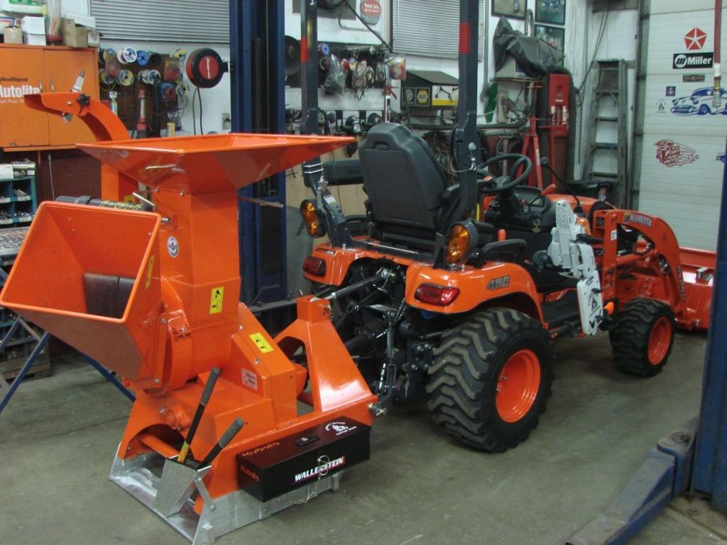

Back story, last summer my 6.23 acres of cabin property went up in a 40k acre wildfire. I now have thousands of charred dead trees that need to come down. My plan is to methodically drop the trees and harvest the bigger stuff for firewood, and chip the smaller stuff. What is going to be a good unit for the size and scope of this job? I figure I'll chip anything under 3 inches in diameter, but I want a unit that will run efficiently and not work too hard. Would a PTO type setup be better than a self powered machine? I have a BX24, so 17-18 HP at the PTO. Trees are pinion and juniper. Thanks
   / Need chipping advice #2
I've always dreamed of having a proper PTO chipper myself, but the price is holding me back until it becomes more of a necessity. Even with just 17 or 18 HP at your PTO, you should be able to hog through 3" limbs no problem. A big big branch could slow your engine speed down some, but I wouldn't expect any issues, from what I've read. I would look at a Wallenstien bx32 or bx42, they seem to really be the best value (not cheap though!).

With the size tractor you have...a Wallenstein Bx32 is the best you can handle...the chipper can take 3"...but your tractor will be working at it's max.They're very good well built machine.I have 42 on a 50 hp MF...very happy with it.
