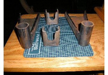

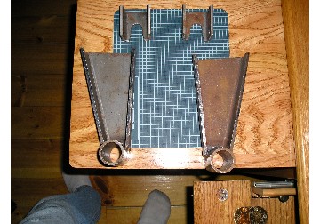

I did buy some parts off Ebay once that were for a dump body. I am not sure this is what your looking for. I think a couple of the pieces you could use with linch pins so you could open it either way. I am not sure if this helps or not. I will take some pics and try to post them for you.

   / Need dump trailer tailgate parts #9
Pictures were way to big, had to have the wife help me out :D
I don't recognize those parts. What where they for?
