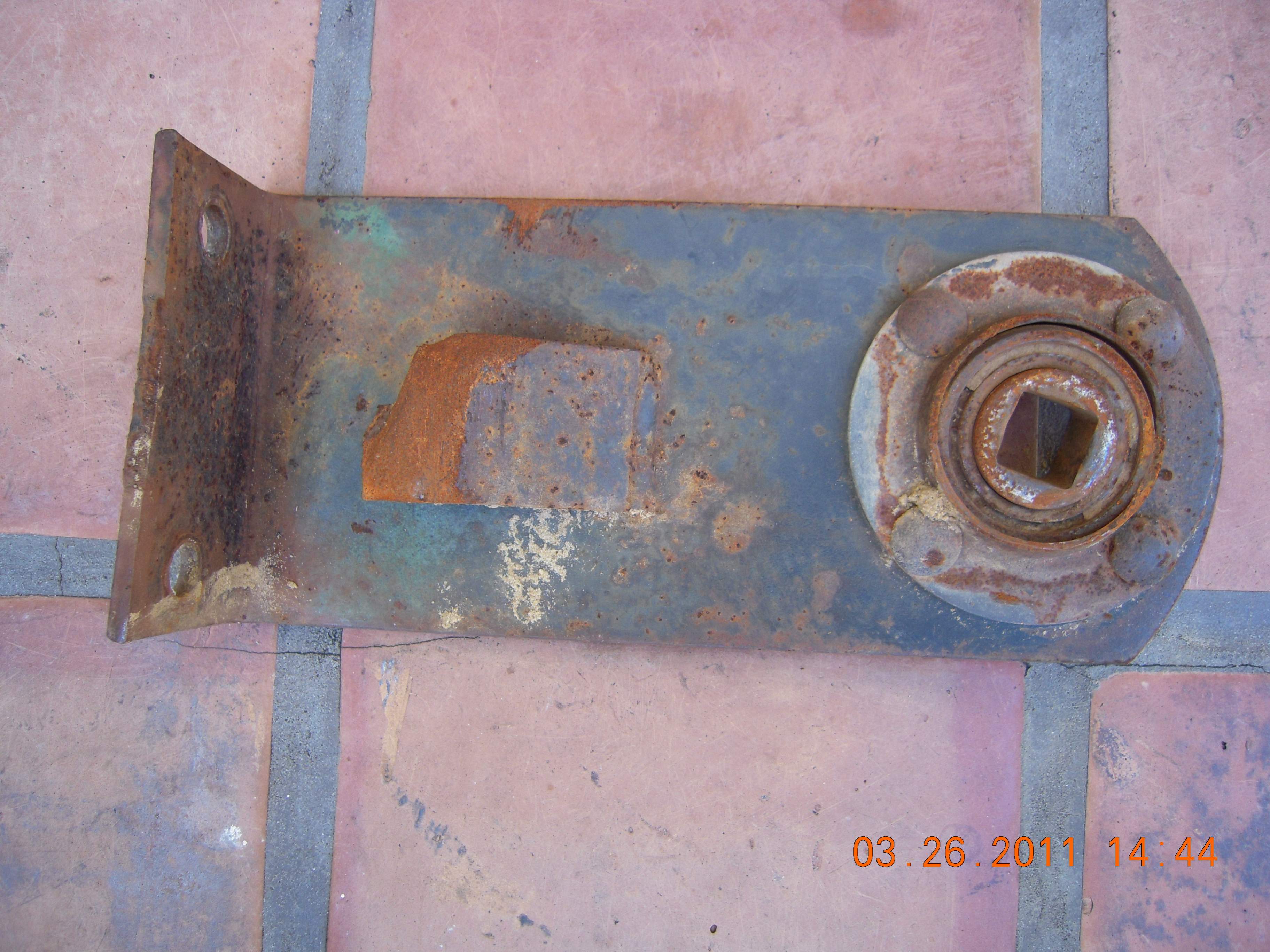

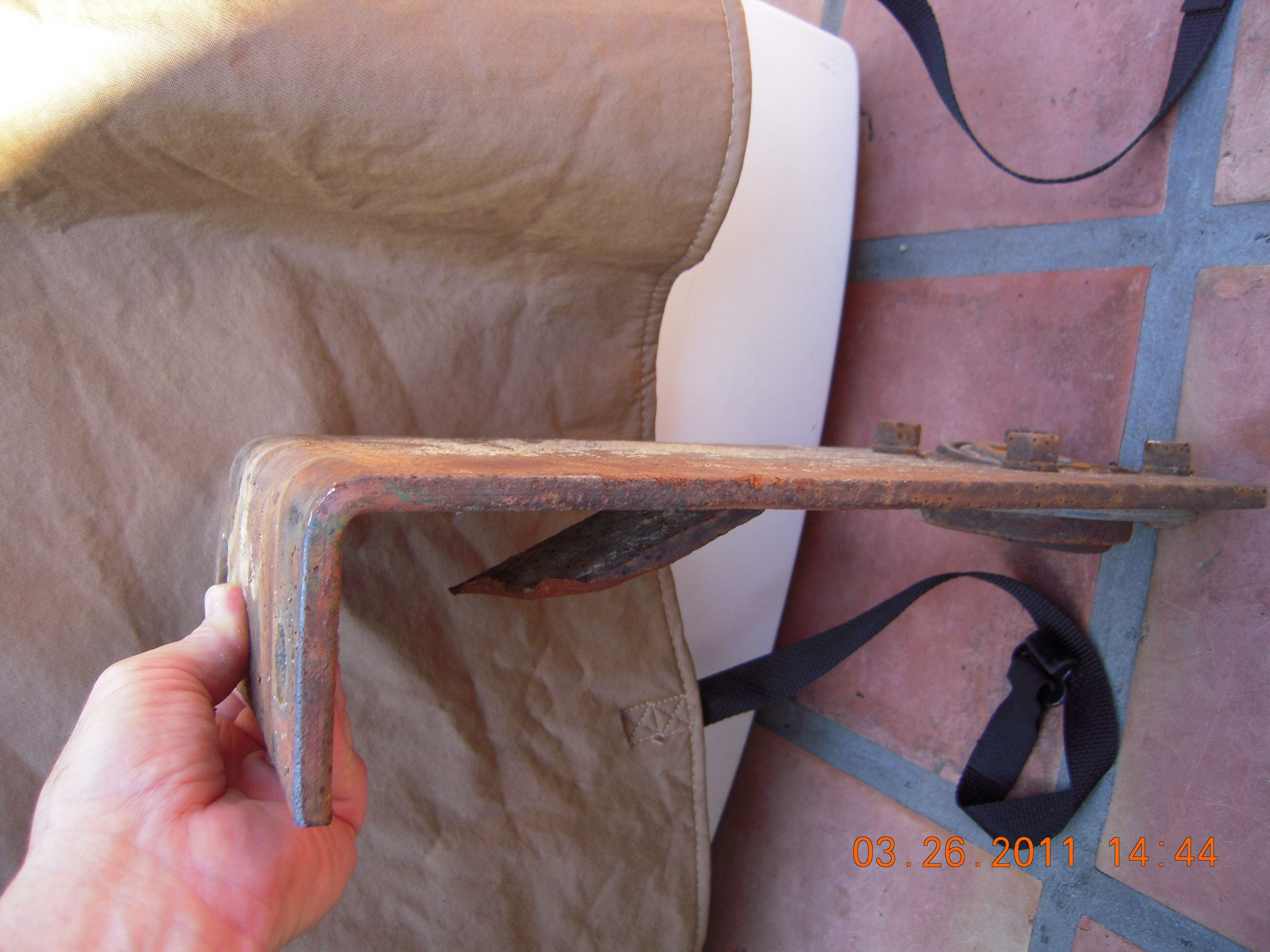

The gang hanger bracket on my disc harrow broke and I need a new one. I have posted info about this here before and ran down some leads - but no luck. Planting season is on us and I'd like to get this one back in service. Attached is one of the GOOD ones - need one just like it. Any ideas..???

Brand?
Model?
Is the hangup in finding the bearing with the square hole?
   / Need gang hanger attachment #3
I bet a good machine shop could make one pretty quick. Looks like it was cut out from 3/8" steel, then had the holes drilled in it, and then make the bend in it. You should be able to find that bearing at a good tractor dealer, or maybe even at TSC. Just a thought, if you can't find a place to sell you one.
   / Need gang hanger attachment #4
i used my log splitter to bend one up. made the "v" from 2 pieces of angle iron welded to a 3/8s x 6 inch flat bar bam! bending die.
