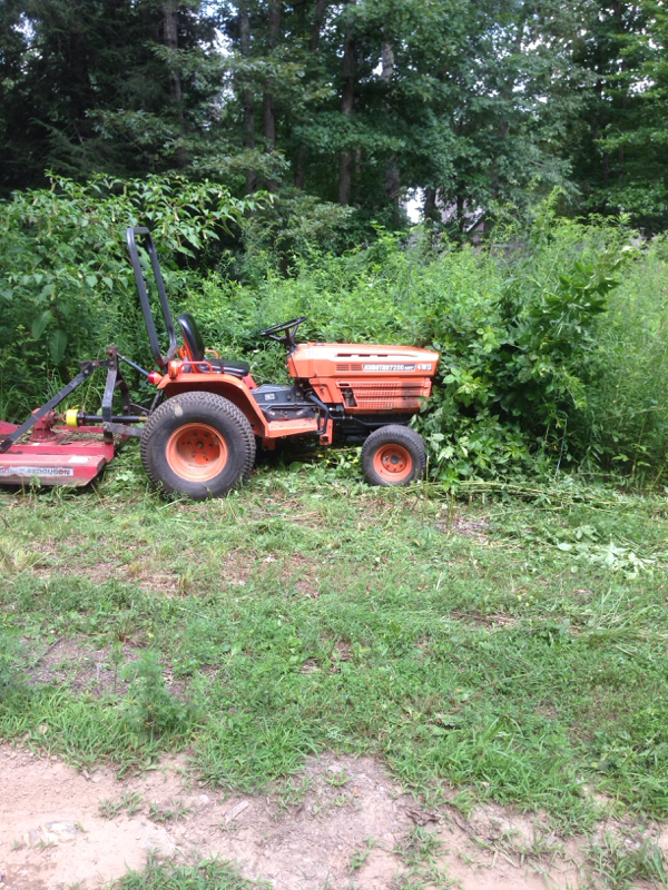

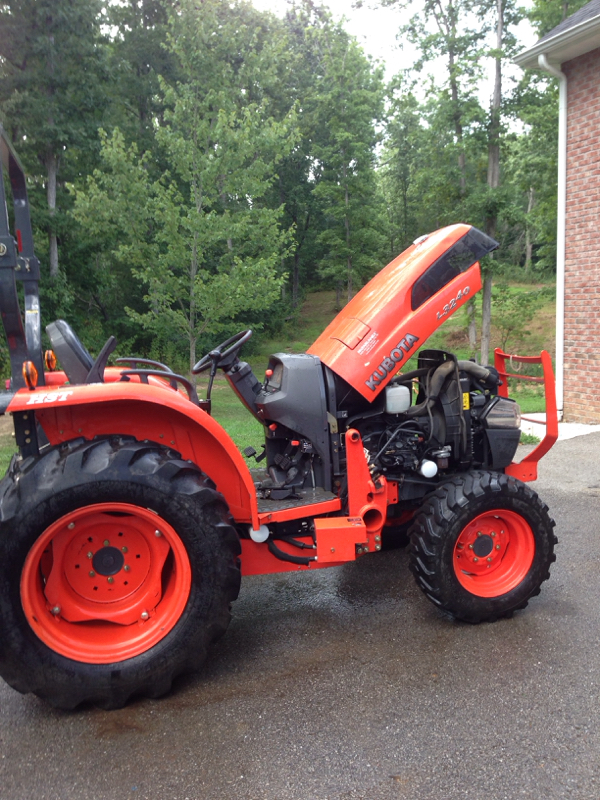

I think you need all three, but at that price you will likely have to compromise somewhere. Here is what a $3000 tractor looks like. I paid $16000 for the L3240 with a loader. image-3086676535.jpg
