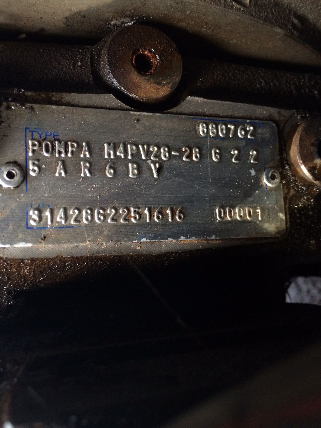

I haven't been able to get a direct answer. Anyone ever find a replacement hydrostatic drive pump part number for the EF-2 models? I need to rebuild mine and can't find a rebuild kit or a cross reference replacement. Any help is appreciated!!

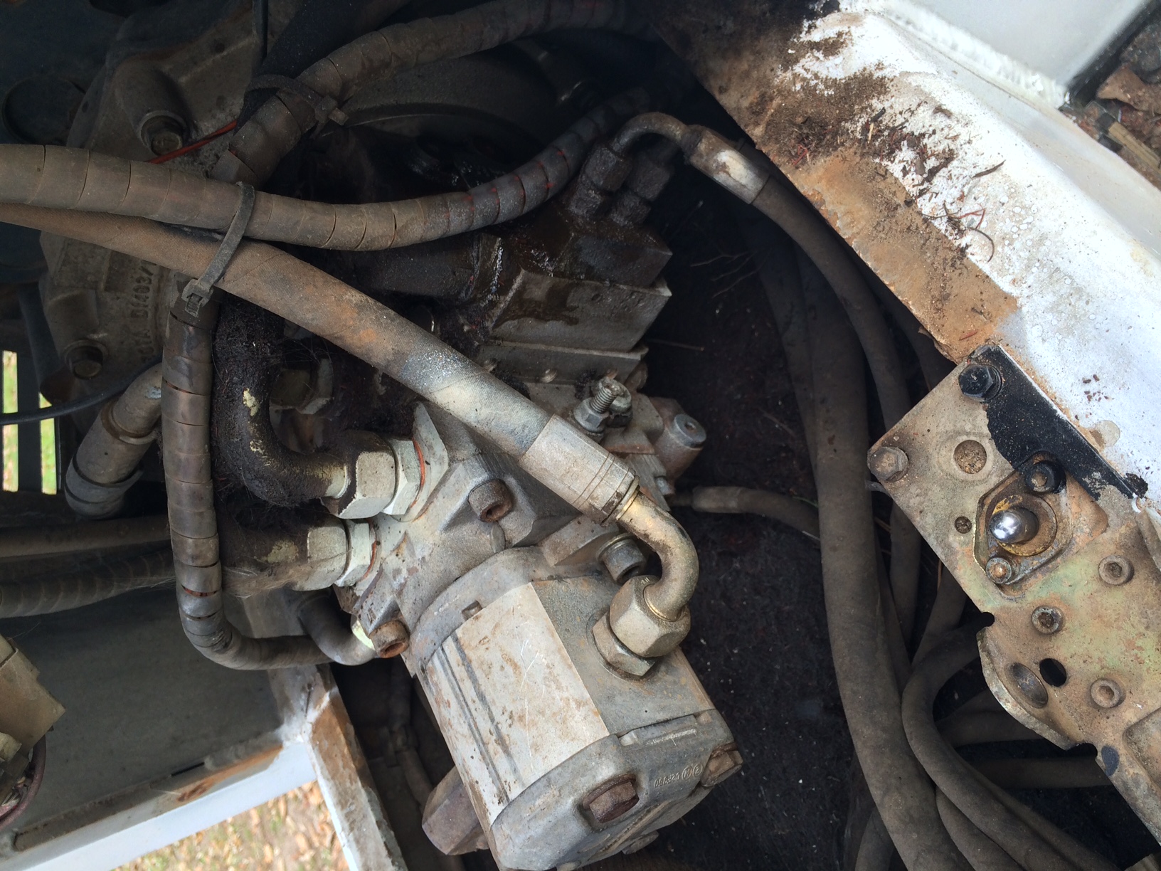

This is the pump that's on the EF-2. Doesn't seem to be the same pump that's on the B200.
   / Need help 1999 Earthforce EF-2 hydrostatic #5
How did this work out I'm having similar problem, I'm in Charleston. Makes a whining noise under load similar to power steering pump noise? 1999 EF-2
