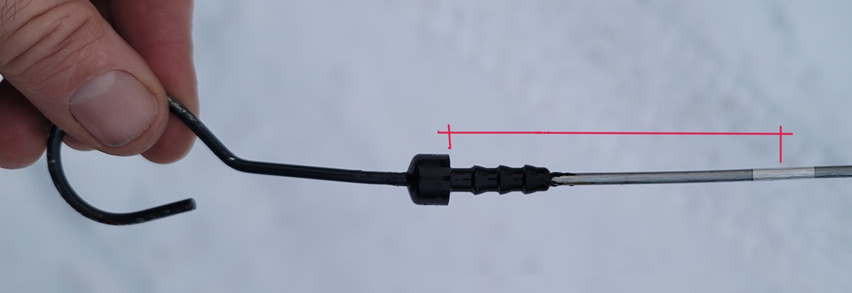

Hi guys, does anyone have a kubota F2000 in their yard? I am missing my HST transmission dipStick. I have an extra one but it's for the engine, I could mark it if I knew the correct length. If someone could do me a huge favour and measure from the bottom of the rubber stopper to the middle of the oil level indicator that would be fantastic! Kubota wants $200 can for a new one!

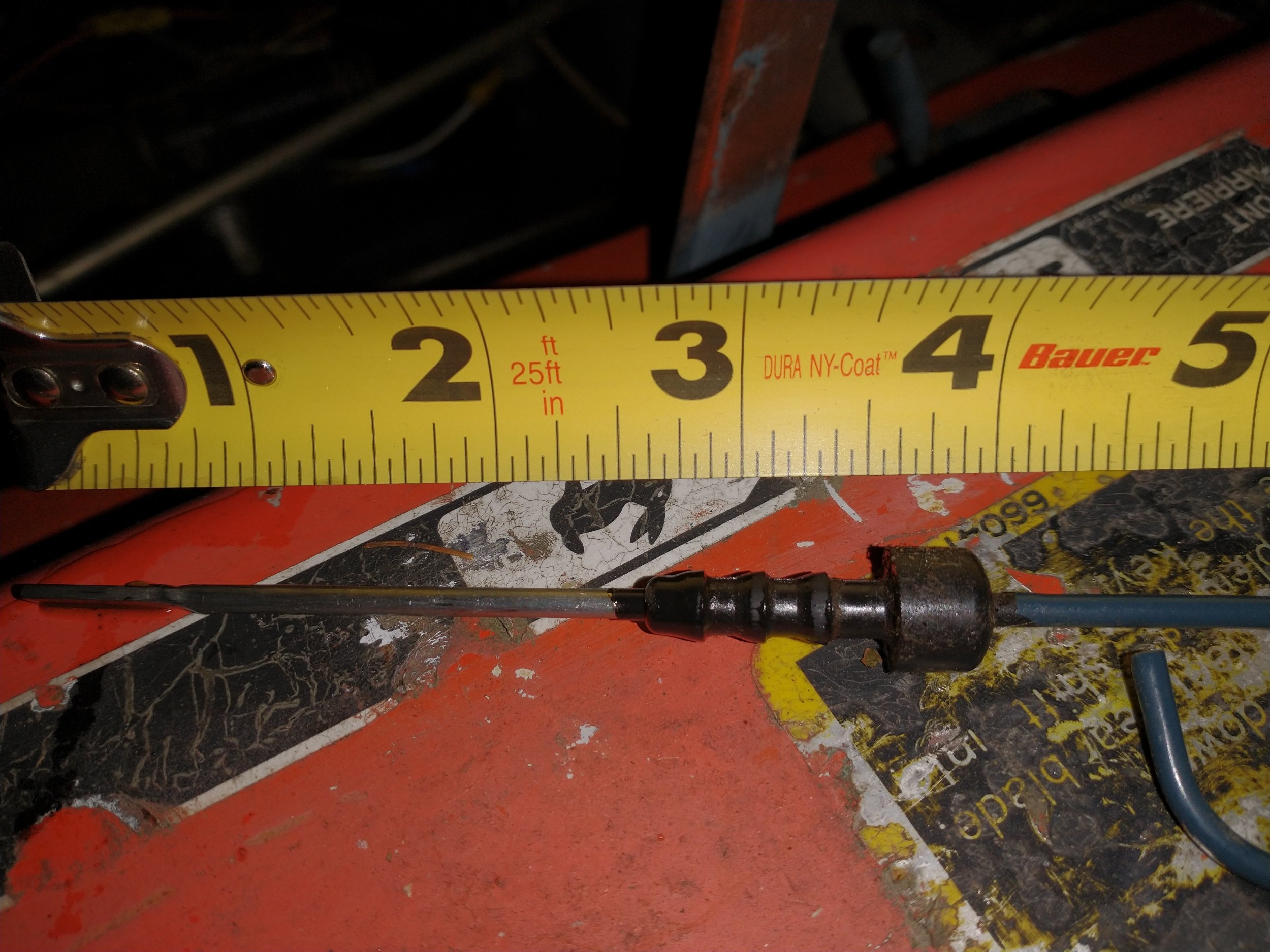

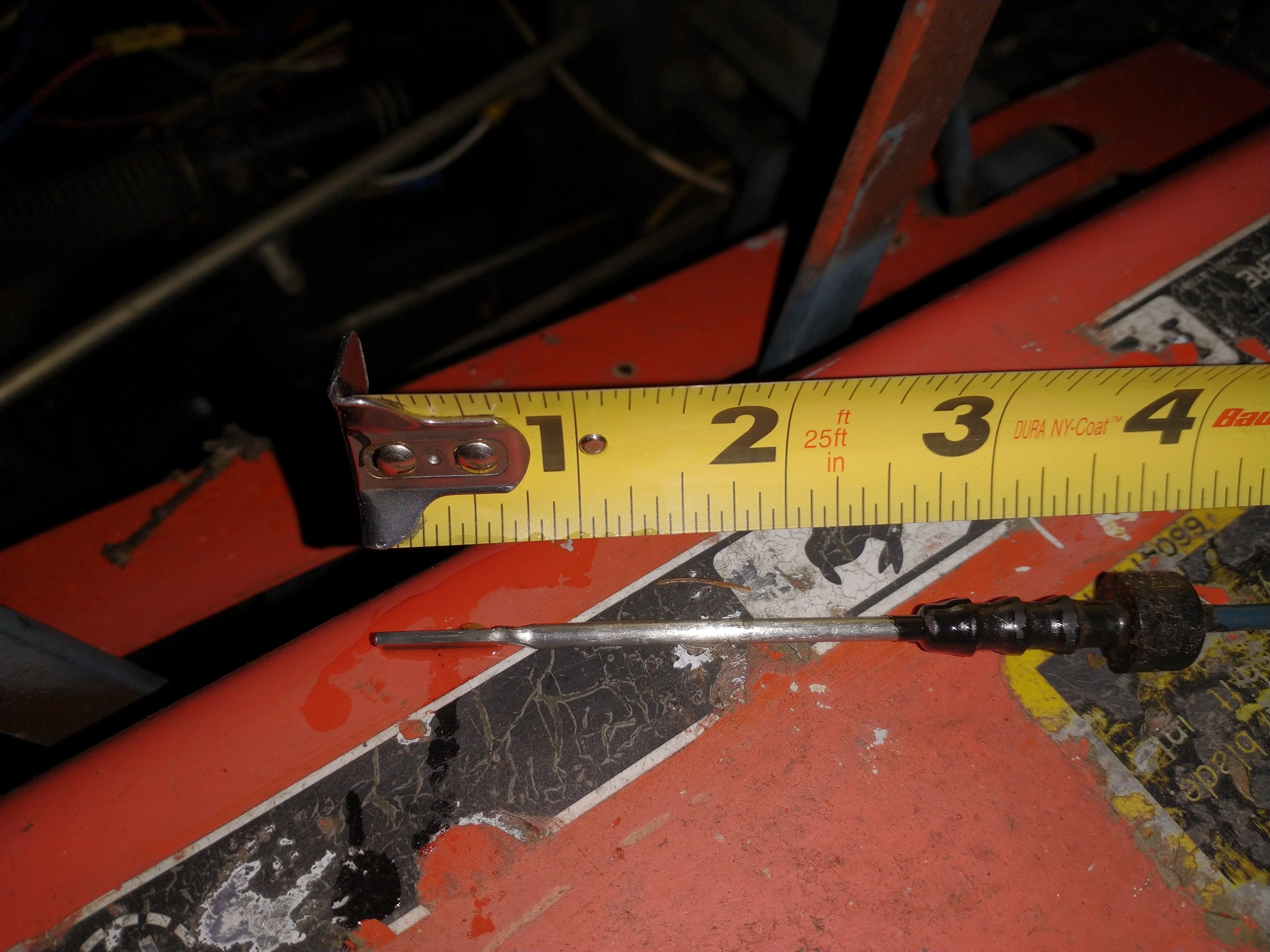

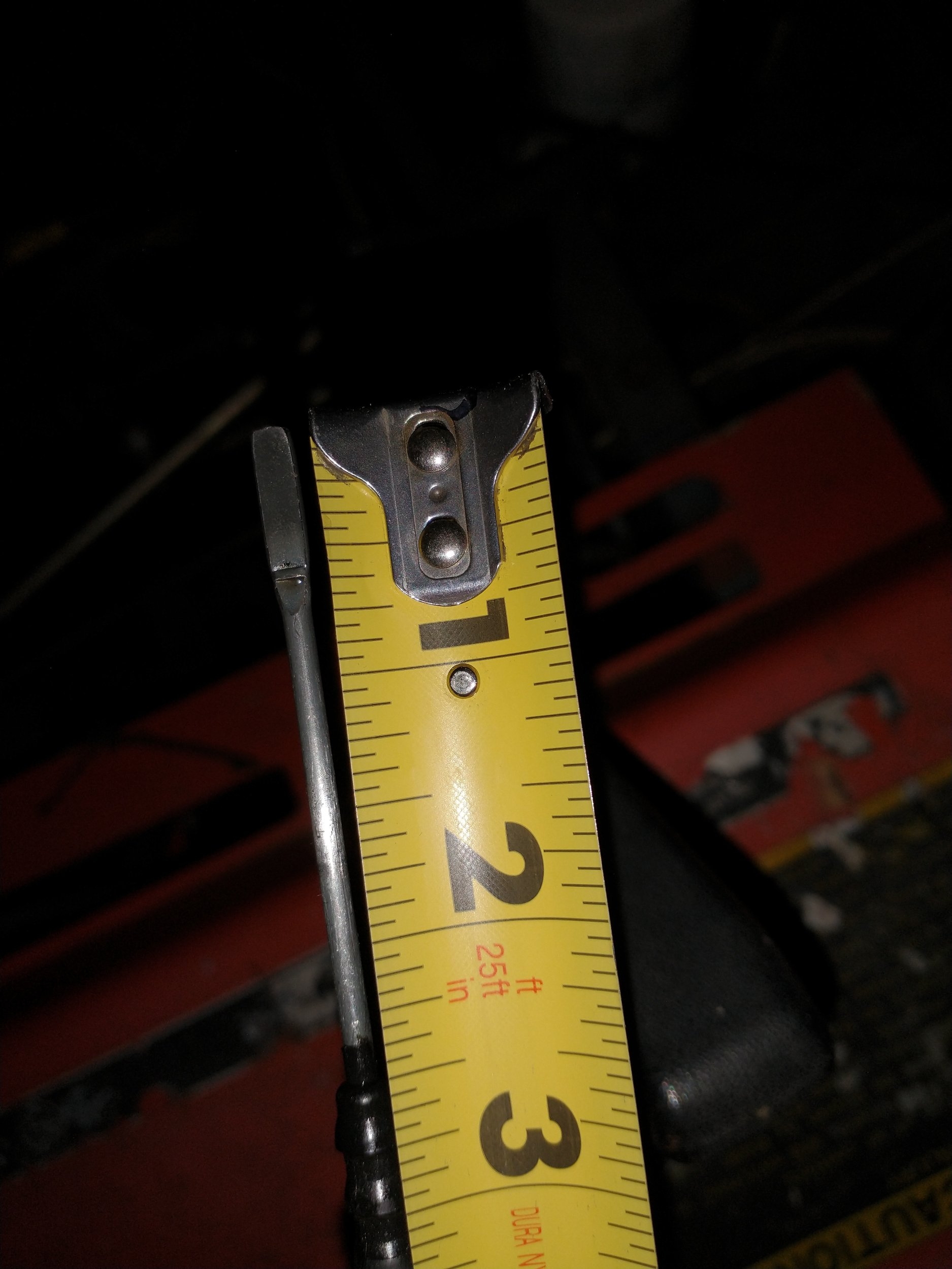

OK, here are a few pictures;
Full mark is about 5/8" from the tip
So about 3 1/2" from the seat to the tip

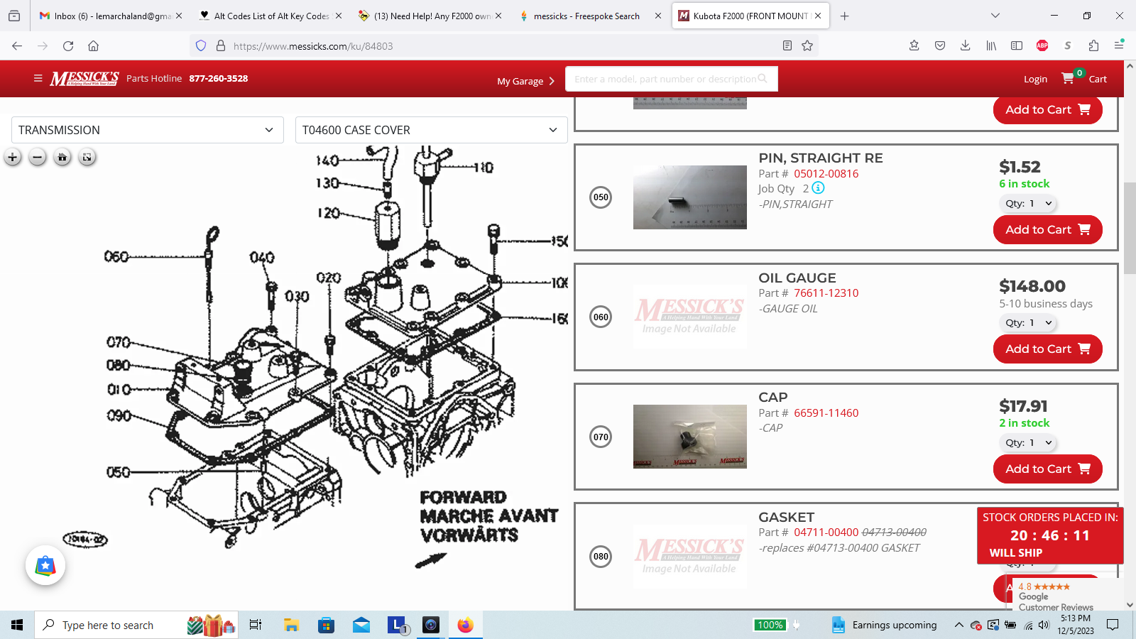

That is a ridiculous price for that little dipstick $148 US.

Thanks again and I agree the price is insane. They also said they have 2 in stock and when they're gone there's no more coming in ever.

The full mark is about 2&7/8 from the seat down to full right? 3&1/2 is the length of the stick from seat to tip correct?
