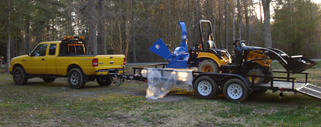

I started with 2007 4x4 Ranger and a Carry-On 16ft dual axle landscape trailer with an empty weight of 1600 .lbs for my Sc2400. Similar in size to your 1026. I think you're jeep would have no problem towing.
When I brought down the T2320 from our farm we're selling in ND, I needed a new tow vehicle from the 2010 F-150 I replaced the ranger with and trailer to tow that tractor. So I upgraded to a 2013 F150 4x4 with Max Tow and a Kaufman 22ft fixed tilt deck
I would get a trailer that you can haul your loader and an attachment on. Like Diamondpilot said,
First off taking the tractor without the loader or rear attachment is like going fishing with only the pole and leaving the tackle box and cooler full of beer at home.
There will be many times that you will have wished you had them with you.
