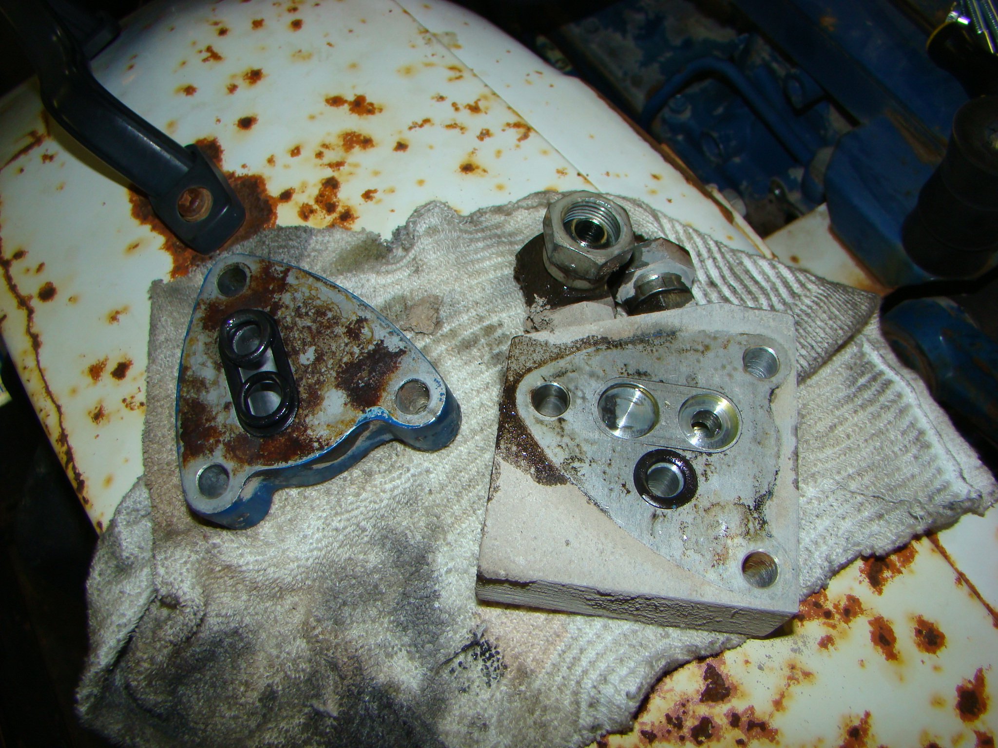

I'm looking for this adapter. I've called a couple tractor salvage yards and bought what was supposed to be this... I've yet to find any leads on anything used and don't really want to shell out 500 bucks for a "new" one.. Any help? leads?
   / need help finding a HYD tap adapter for a Satoh Beaver
#2
This is the one I was sent. They assured me numerous times that it would work but the bolt hole pattern is about twice the diameter. Any idea what tractor this one fits?
   / need help finding a HYD tap adapter for a Satoh Beaver #3
Is it perhaps from an S373? The adapter doesn't look impossible to make, if it came to that.

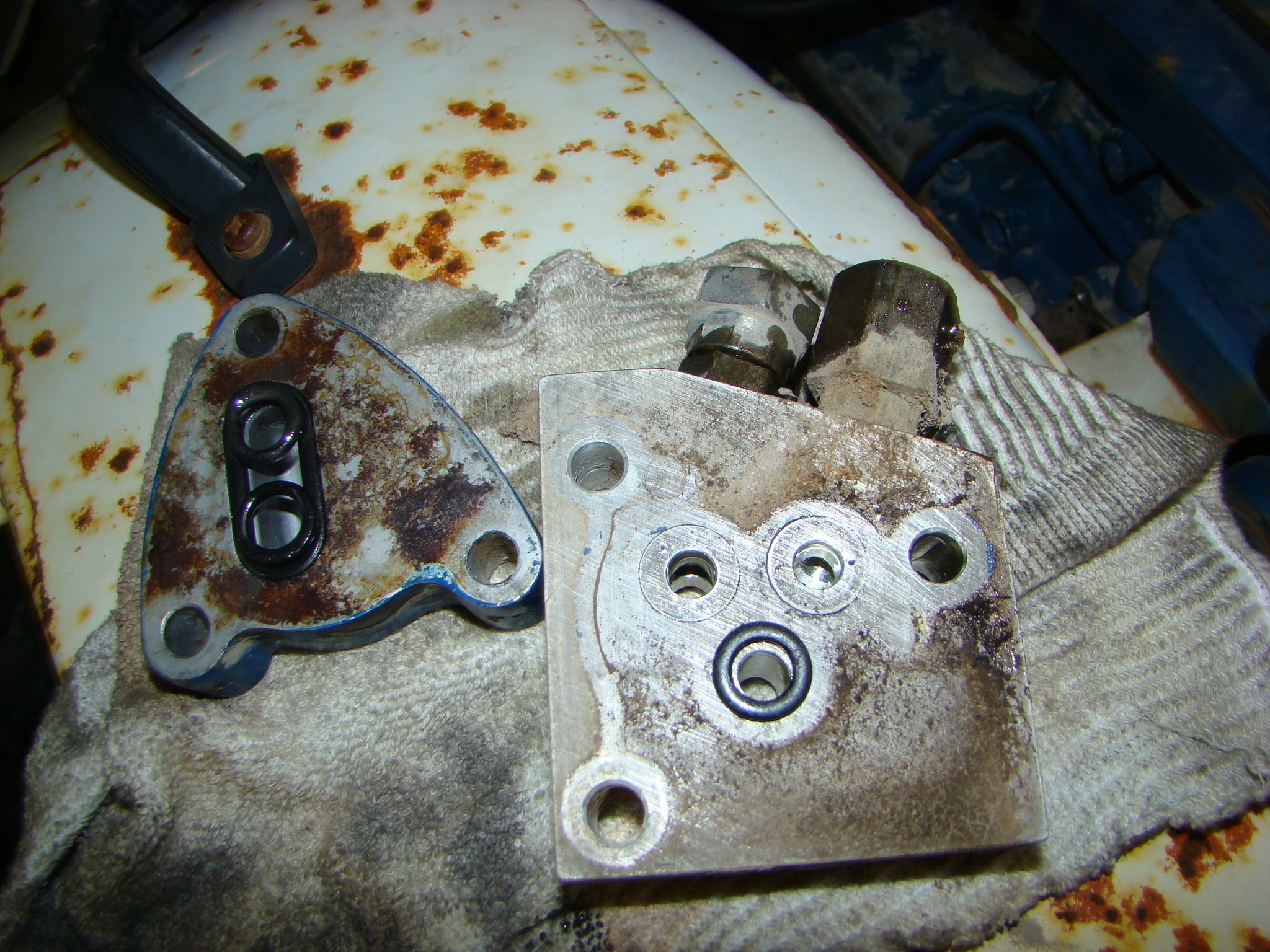

Attached are pictures of the adapter from an S373D for reference. The triangular piece on the left is the piece that would normally only be on the 3-pt hydraulic case.

I'm still lurking here from time to time, and now I have a new problem. Working on a FEL build for my Beaver, I was eyeballing that particular hydraulic port as just an attachment point to get hydraulic pressure to the three point system from the pump. What does the double O ring setup accomplish? Without having disassembled the connection, I had started making an adapter to bolt on there; only I had envisioned one O ring so cut a large O ring groove into the face of my adapter. Anyway, I haven't completed all the machining so if the part goes into the scrap bin it isn't too large a loss. So, can you explain what the double ports accomplish other than just transferring pressure from pump to three point system?
How much oil will leak from this connection when I remove the three bolts holding the assembly together? At some point, I suppose I'll have to remove those bolts and try to get dimensions for an adapter since what I have now probably won't work.
