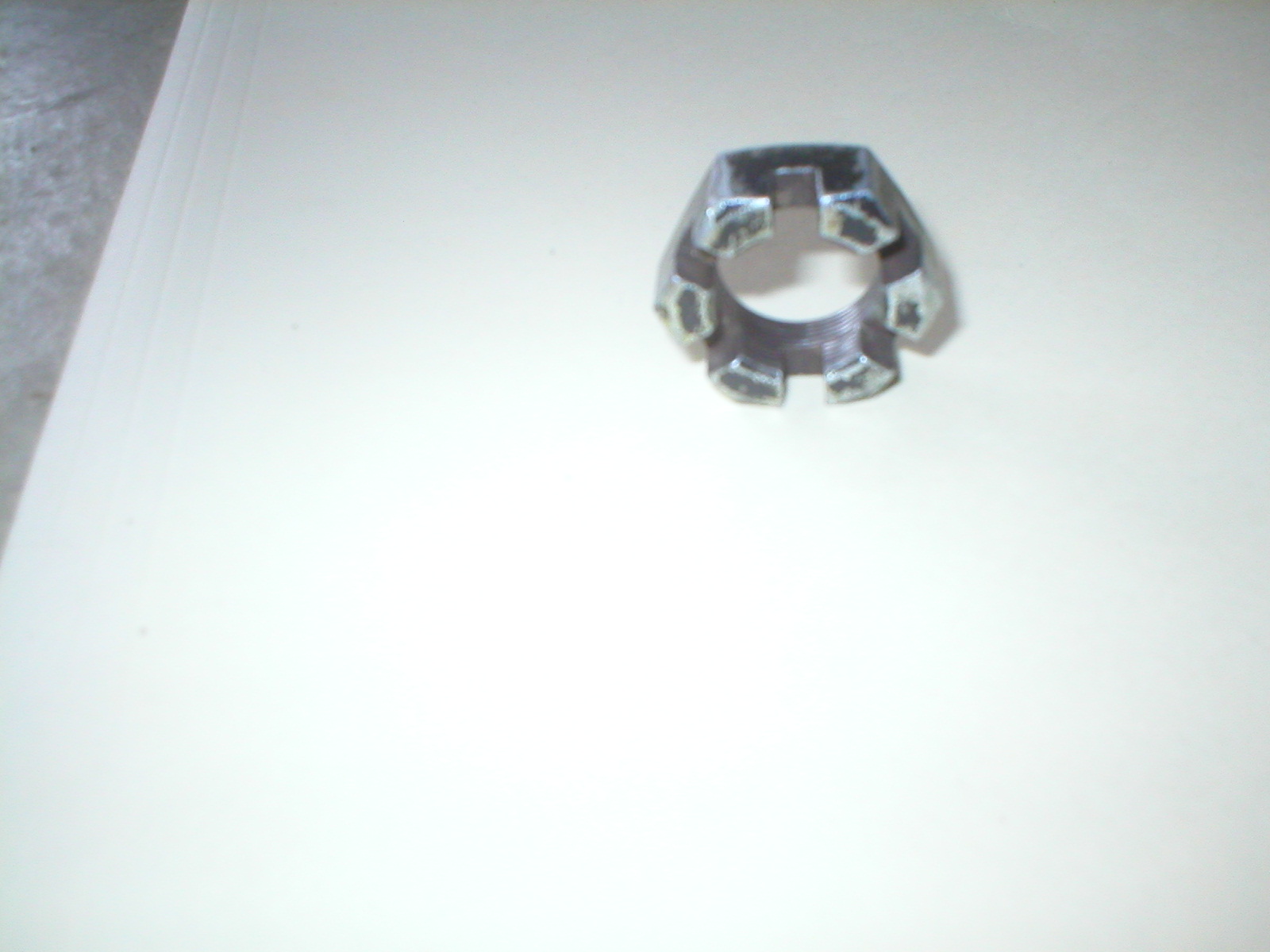

Does anyone have any information on where I might find a nut off 422 wheel motor other than power trac? It is a 3/4 castle nut 28 thread per inch. I have tried NAPA , hydraulic repair shops, fastenal, surplus center without any luck. Can get it from power trac but $50. minimum order. Thanks for any help.

The last time that this came up, I poked around the internet and found a couple of sources. Try searching on the thread size plus castle nut, but you might want to double check the size; Scotchers had it measured by someone else at 1"x20. (The way the TBN thread was left it was unclear what the correct size is.) You might want to PM Scotchers to see what he did.

I checked with Keith at power trac and he confirmed it is 3/4 castle nut , 28 thread per inch. I have called at least 50 different places and no luck. I guess I will order it from power trac. Thanks for input.

Just a question, but what happened to the original nut?

Scag mower uses a 3/4-28 castle nut on their mower. You might have a dealer in your area. If not try Mowpart.com or other online sources. Mowparts price is $9.42. Scag part # is 48679. Hope this helps.

The original nut came off while I was plowing snow. I found the nut about 100 yards from where the wheel fell off, the threads were ground down on the nut but are ok on the shaft it seems. I knew the key way on the hub was getting worn and I had ordered a new hub when I had my tram pump rebuilt by power trac back in the middle of November, but I just never got around to replacing it. Luckily the wheel fell of right in front of my garage and I just raised the front of the power off the ground with the snow blade and put it in the garage for repairs.Attached picture of nut not real clear.

Tried scag dealers none stock it. Called mowparts and they do not stock it or list it they said.

It is Mowpart.com, not mowparts. You can go there and type in 04027-02 or call 972-635.7225. Maybe this will get it.
