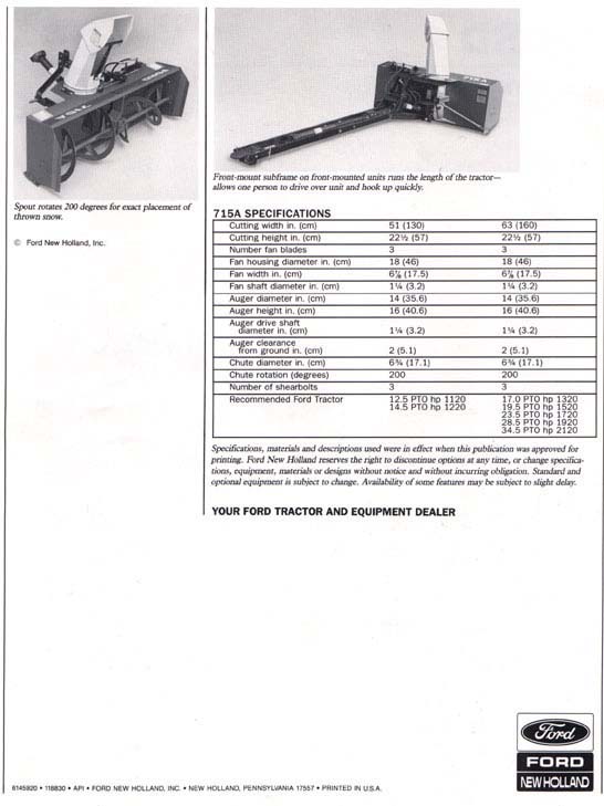

Im trying to fing out what model machine it came off of or what it fits,If you know please pass it on,Thanks in advance
   / need help identifing a 715B Ford N/H Snowblower #2
This snow blower would fit a variety of Ford or New Holland models depending on the mount kit that was used.
   / need help identifing a 715B Ford N/H Snowblower #3
Re: need help identifing a 715B Ford N/H Snowblowe
I wasn't able to see the picture. All of the 715 series are pretty much the same as far as I know. I'm trying to sell a 63" 715A 3pt hitch version. From the spec sheet the 51" fits the front or rear of the 1120 or 1220 and the 63" fits the front of the 1320, 1520, 1720 and 1920 and the rear of the 1320, 1520, 1720, 1920 and 2120. I think there are adapters for many of the TC models as well. The rear mounts will obviously work on almost any machine with a Cat 1 hitch. I have attached the spec sheet for the 715 series blowers. If you want to see one I have one in Woodstock Conn.

Page 2 of 715 Snowblower spec sheet

Spencer,
Is this adaptable to my TC18? Front or rear. I realize I may be a little underpowered...
Thanks!
