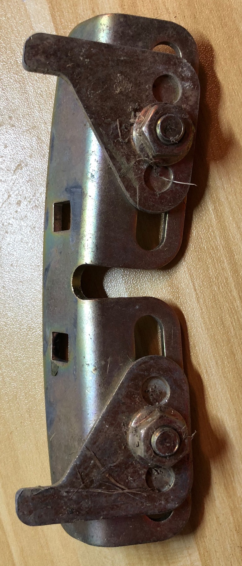

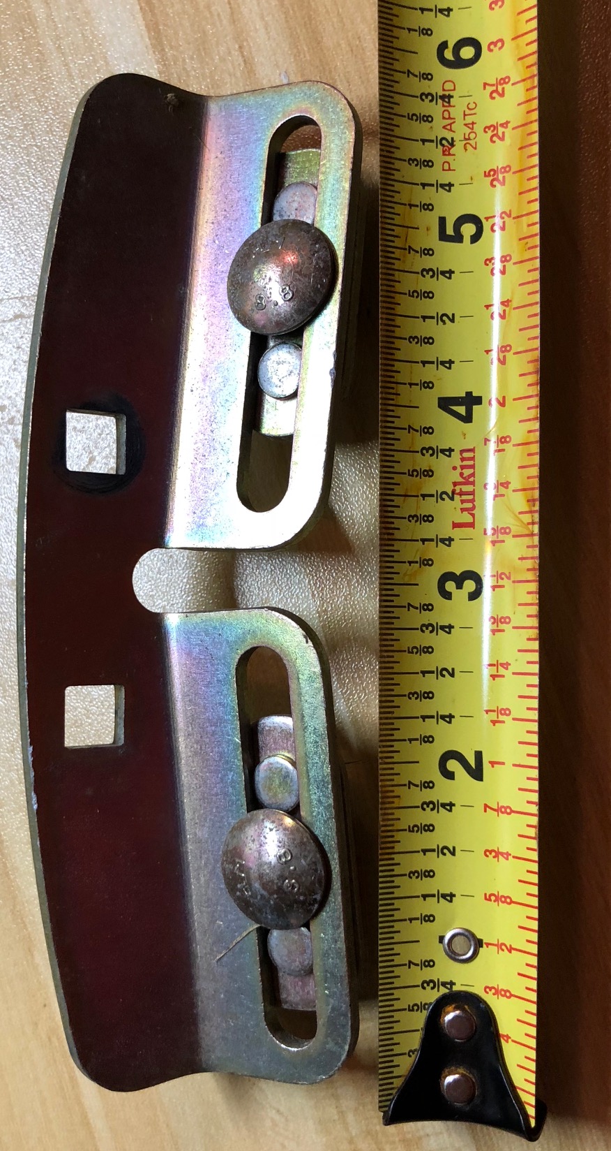

Hi all,
I was walking my property and found this part lying on the ground. I'm not sure what this part is, but I'm fairly sure the only piece of equipment I own that would have something like this is my Kubota BX2350.
I do not own any rear PTO attachments so it's not a part from an attachment. My Bota has a MMM and a FEL if that matters. I also have a BX5450 front-mount snowblower but where I found this part suggests that it's NOT from the snowblower.
Any ideas?
Thanks in advance everyone.

I own a BX 2350 but can't put my finger on what that would be. I'll try and take a look at mine tonight.
   / Need Help Identifying a Part #3
It looks like it is the end stops for something that moves in two directions like the 3pt lever or HST peddle????
   / Need Help Identifying a Part #4

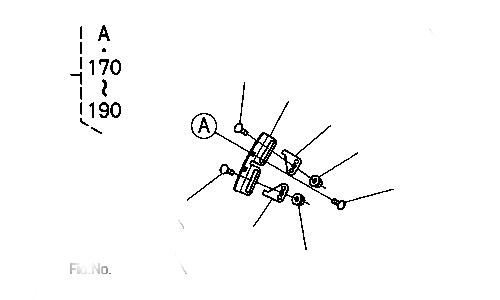

080 K2581-55230 STAY LEVER GUIDE
090 K2581-55240 STAY INCHING STOPPER
100 K1122-91310 BOLT SHORT
110 02751-50080 NUT FLANGE
120 K2581-55250 STOPPER INCHING UP
130 K2581-55260 STOPPER INCHING DOWN

AWESOME! Thank you so much. I really appreciate it
   / Need Help Identifying a Part #6
I would be looking around for the two bolts that are missing. Don't need some thing flying when you are mowing.
