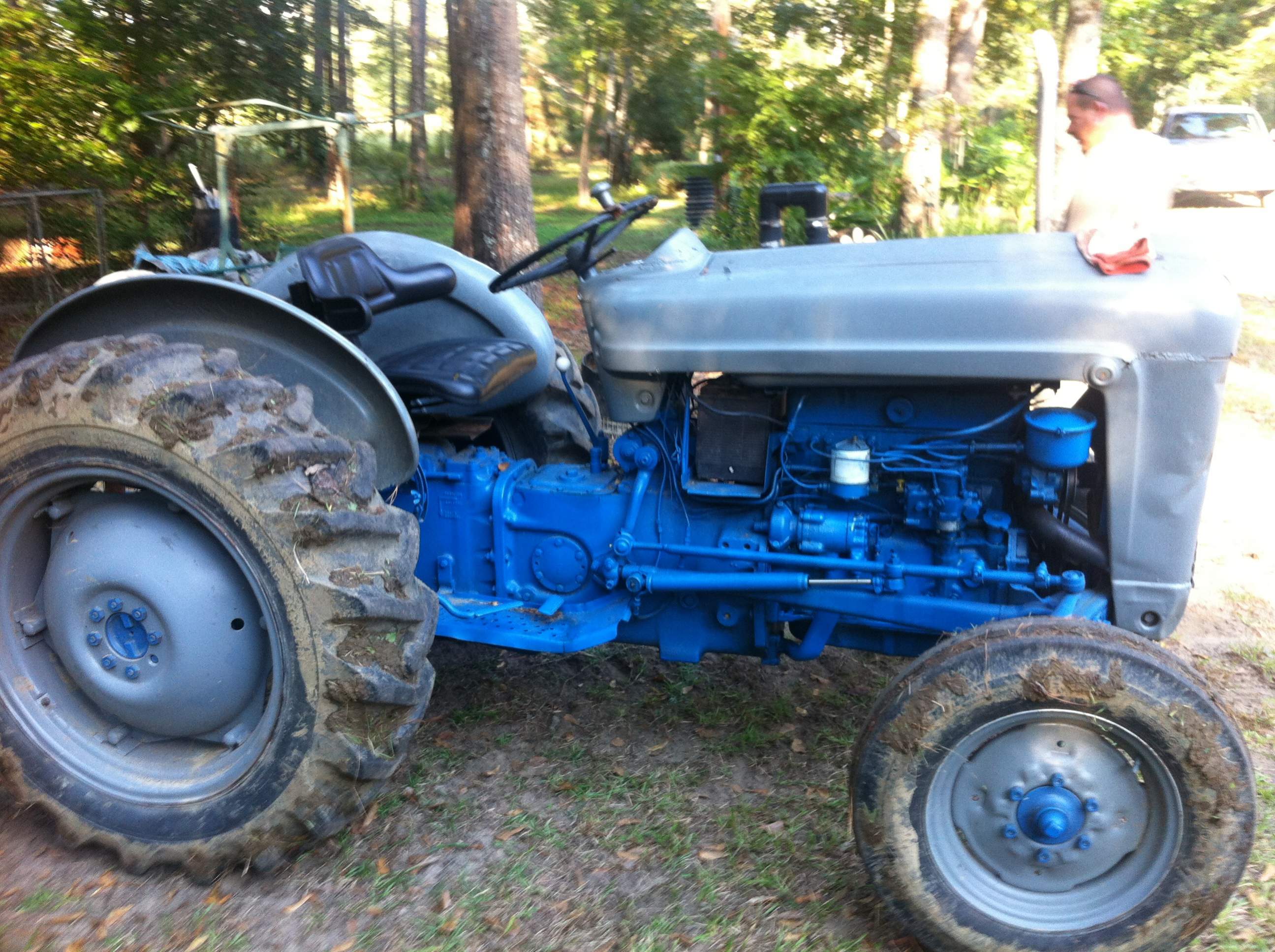

I have a buddy looking at buying an older used tractor. One his options is a ford 4000 or what is supposed to be a 4000. I thought it looked like an 861. Here is a photo
Serial number is hard to make out. Best we can tell it says 12023. It's diesel.
It has live pto with lever on left side to get it going. Has draft and position lever on right. Five speed transmission looks like this

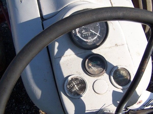

Gauges look like this
It has dry brakes. it appears to be in good condition.
Any ideas which model and year? I have looked all over the net and cannot find good answer.
Finally if in good shape what's it worth? Thx

if it is a 4000 ( reread the model ID ) can check engine block casting to see if it is a 172 or 134 etc.. )
in nay case.. 55-64 fords generally go for 2500-3500$ depending on area and condition.
I like 5 speeds.
if you find a 5spd in a 000 4 cyl and it is the oe tranny.. it SHOULD be a dual clutch.. so yeah.. a 4000 4 cyl 5spd is like an 861 with different tins
make sure it has the new tin on the front and not for a round nose emblem.. or it's at least older tin.
them rear hubs say 4000 to me...
ps if working is nice.

Last question. I assume this is the row crop version? Certainly looks like it to me. Not industrial, right?
   / Need help identifying ford model/year and possible price #4
DEFFINATELY NOT rowcrop.
rowcrop has a 1000% different front pedistal and drop gearboxes in back
front pedistal of a wide front rowcrop
http://photos.yesterdaystractors.com/gallery/uptest/a27706.jpg
rear drop boxes. notice axle profile to tire
http://photos.yesterdaystractors.com/gallery/uptest/a11791.jpg
front corner shot
http://photos.yesterdaystractors.com/gallery/uptest/a11790.jpg
front
http://photos.yesterdaystractors.com/gallery/uptest/a12882.jpg
side
http://photos.yesterdaystractors.com/gallery/uptest/a12881.jpg
these are my 63 4000 rowcrop.. some before some after..
a narrow front bolster would look like this
http://photos.yesterdaystractors.com/gallery/uptest/a9248.jpg
and another
http://photos.yesterdaystractors.com/gallery/uptest/a9252.jpg
that machine is my 740.. an older rowcrop.. but lets you see the dual narrow front old style single piece pedistal.
those are rowcrops.
you have an ag chassis.
if it had a hd front axle or NA hd front axle.. it would be an industrial.
