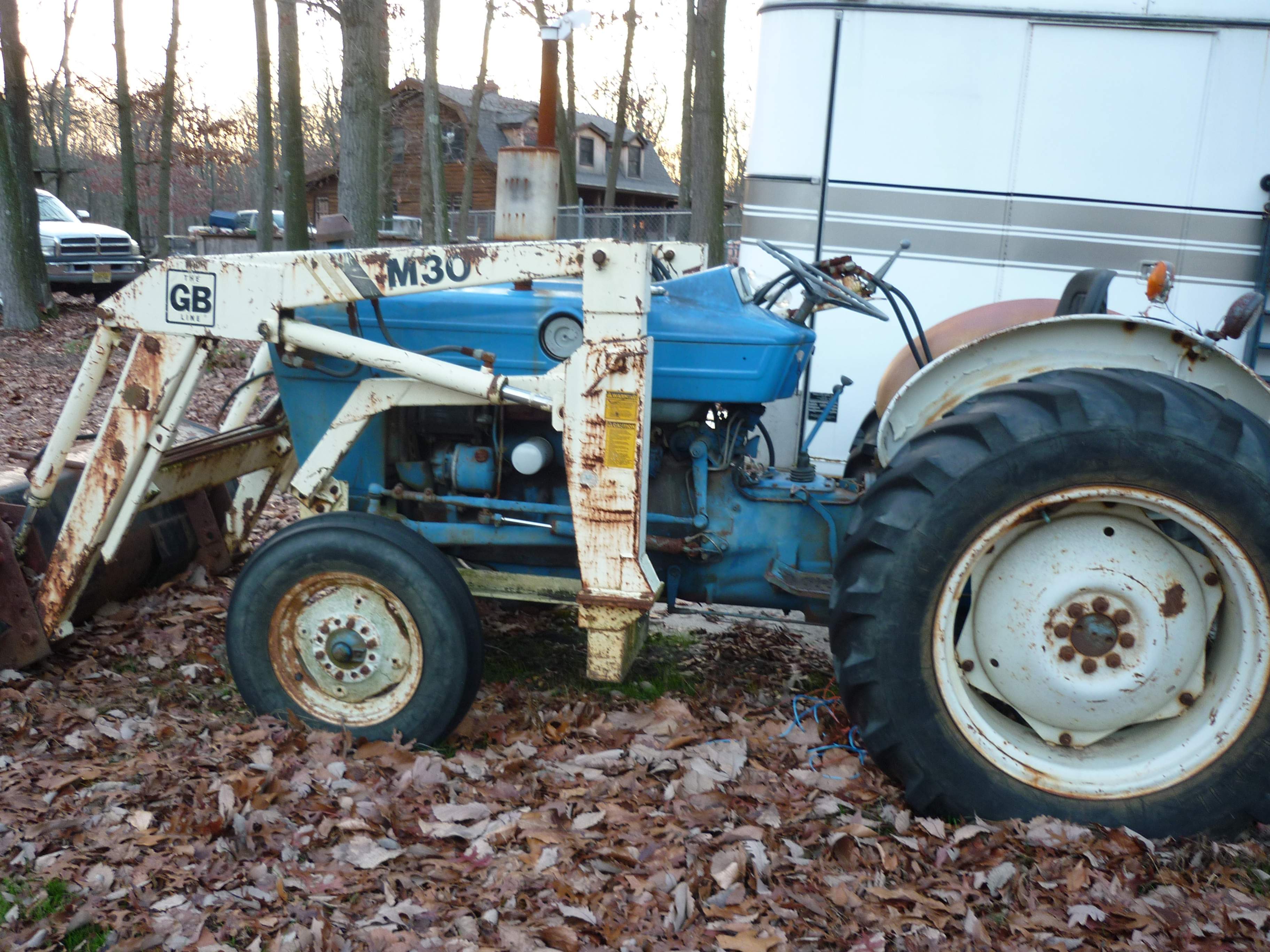

I just bought a Ford tractor today and am havin a time idin it,3 cyl,gas..No serial behind starter,I think its 68' to 75' or so..numbers on block are D2 NN 7006 A,on frame between motor and rear are DONN 6015 J,under seat are DD40A15 ,4C08B,,ill try to attach pic.email is cheeksrules@yahoo.com,,Got it tunin over,dist cap dirty etc,gettin gas .THANKYOU

Either a 2000 or 3000 built between Oct of 1968 and Dec of 1974. The serial number is on a data plate that may still be on the underside of the hinged half of the hood. Failing that, look closer to the horizontal surface of the bellhousing just aft of the starter. Serial number, unit code and model number are hand stamped there. Yes, those numbers are there.

I found C622322...the 50 yr old eyes..found it in my pic of larger letters.i think i can find model but any help is appreciated,thankyou,jim
