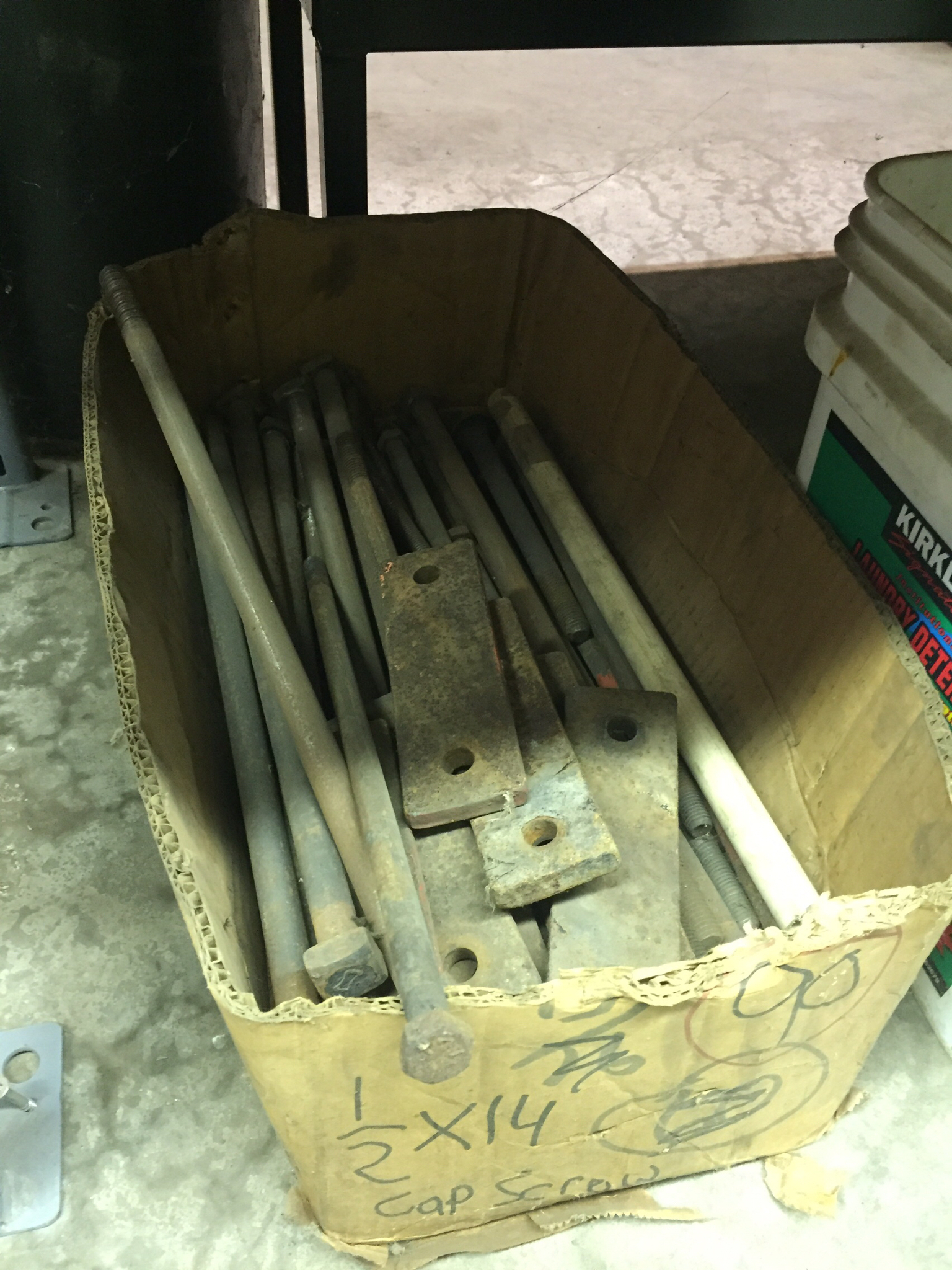

Good advice on the threaded bolts and I will go with the "I" beams. How thick are those plates for the threaded rod--maybe 1/2"?
   / Need help on building a flatbed stake bed #9
For an F600 I would go minimum 1/2" plates with 1/2" all thread with an eight foot long deck.
You COULD go 5/8" plate and bolts if you wished.
Too bad you're so far away. These have been in the shop for 30 years and you'd be welcome to them.

For a F600 I would go minimum 1/2" plates with 1/2" all thread with an eight foot long deck.
Terry
How many plates each side?
   / Need help on building a flatbed stake bed #11
3 sets each side should be adequate. Might have to do 4 depending on spacing and where your spring hangers are in relation to the length of the deck.

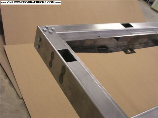

Big Barn--I thought about the rub rail down the length but it isn't historically true to the 1967 truck I have. Not that it needs to be but stake pockets in a flat metal floor would look better I think. What do you think? Take a look.
Here's an example off the net--but with a wood floor.
I've also discover what appears to be pre-made sides for building truck beds. Look at the photo below and it sure looks commercially made. That would make life easier?
Thoughts?
   / Need help on building a flatbed stake bed #14
I like the way you think. I'd go with the "historically correct". When we bought our F600 new in 1960 we built our deck with the enclosed stake pockets similar to your second photo.
We used 3/16" 3"x4" (I THINK) angle iron for the outer perimeter. The stake pockets weren't available commercially that we were aware of so we had them preformed to accept rectangular (steel)square tube.
