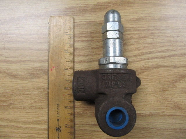

I have a older 75 terramite and am working on the hydraulics. My front end loader is strong but the backhoe is weak. I decided to check my pressure relief valve and found that the spring is broken(picture below) . I have searched the internet for days trying to find a replacement spring with no luck. The only info i can find on the control valve is that its a gresen 2702 (picture below). I tried calling parker and that couldn't help me without a part number. 2702 means nothing to them. Does anyone know what model this valve is? or where i can find a replacement spring??

yeah not to mention that i would have to buy two. I did find something on ebay that may work. (picture Below) I called parker and there were unable find the part pictured. they said 2818 didn't come up in their system. the relief valve looks the same and it is marked HP on the side which i assume means high pressure. the only issue is that there are three different types of valves sp spk and ssk. the spk and ssk use the same relief valve but the sp is different. I to me it is a 50-50 shot in the dark. vavle.JPG
