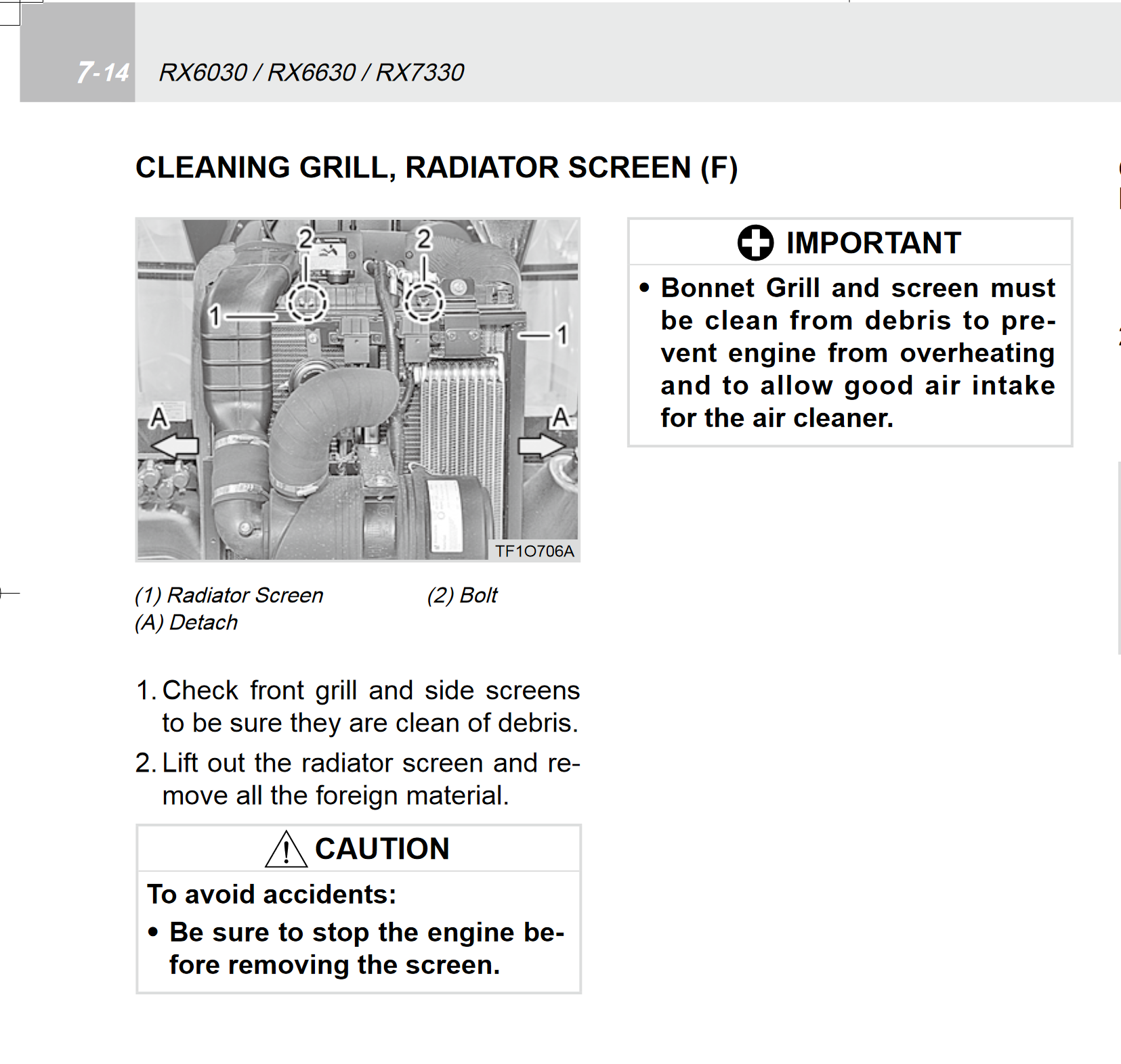

Recently the A/C in my 2020 Kioti RX7320 quit working. I returned it to the dealership for repair. They determined that an A/C line had ruptured and replaced it under warranty. But the root cause of the rupture was that the A/C condenser was clogged with debris, even though everything looked clean and even though I regularly washed the radiator front and rear. The mechanic said that he had to use a homemade compressed air line to slip between the radiator and A/C condenser to blow out the debris clogging the condenser. I ordered a similar air line from Amazon to use to clean out the condenser. Today I tried to remove the screens and other items covering the A/C condenser but could not figure out how to do so. Does anyone know where I can find a tutorial on what I need to remove (as well as how to remove) to gain access to the back of the A/C condenser?

On my little CK, there are 2 wing nuts on top of the radiator holding the screen in place. I have to remove those, then flip the air cleaner and air intake hose up and out of the way to pull the screens up and out.
If you bought the Radiator Genie wand set, just use the water hose one. Will clean better than the air with less chance of fin damage as Cougsfan mentioned.
Found a RX7330 manual. Chapter 7 http://demss.co.kr/dossfile/manualnew/OM/RX6030_6630_7330_181224.pdf
Looks to be the same way:
