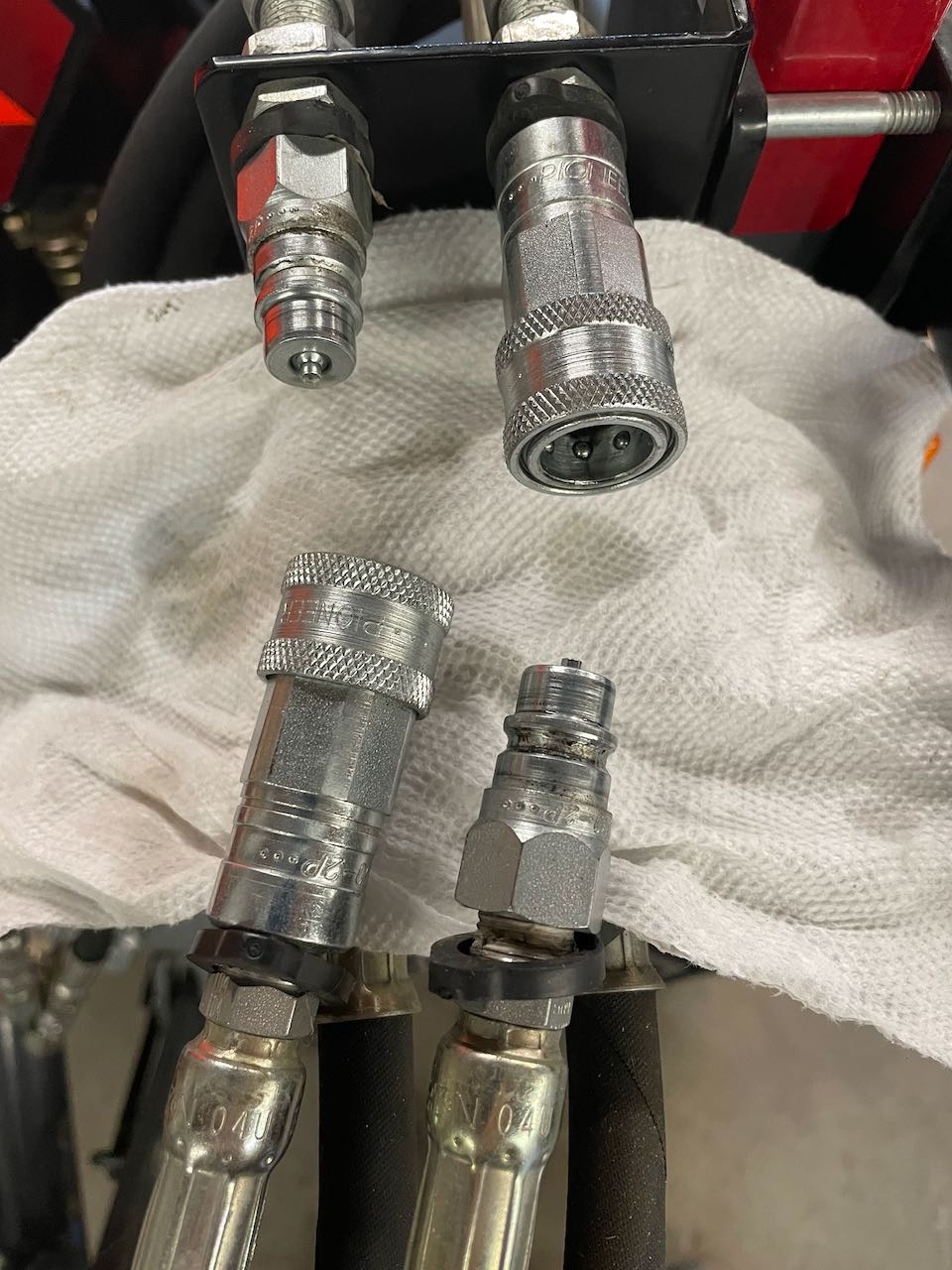

I have a Gearmore 3 spool hydraulic control valve for a top-n-tilt kit that the Kubota dealer installed installed when I bought my B2620 in 2008. I've only ever used 2 of the 3 remotes. Now I'm getting a flail mower with hydraulic side shift, so I'll be using the 3rd remote with it. The flail mower will come with the hydraulic hoses, but not the couplings, and I need to figure out what to order. Here's a picture of what I currently have, with one of in-use remotes uncoupled:
The seller says:
"Hose ends that connect to the tractor are fitted with 1/2-14 NPTF threads, you will have to provide the corresponding fittings to complete the connection to your tractor"
It looks like I currently have 1/4" couplings. The part numbers are Pioneer 4010-2P and 4050-2P. I can find these online, although the 4010-2P looks different so I'm not so sure it is compatible. Seems they changed the design since I bought mine. Also they are 1/4", and the hoses connectors are 1/2", so I assume this means I need a 1/2" to 1/4" adapter. If that is correct, I'm having trouble locating the part.
Thanks for any help you can offer!

One other thought. If I can't find compatible couplings, couldn't I remove the quick connect plug from the valve bracket and attach it to the hose, so it can pair up with the socket still attached to the valve bracket. Then I can buy pretty much any 1/4 coupling for the hookup of the second hose.

All the information you need to know might be on the slide ring/body of the female couplers....Should be manufactures name and part number... From little bit I can see the couplers look like they may be "Pioneer"...
Yes, they are Pioneer 4010-2P and 4050-2P.

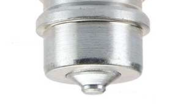

I pointed out the my 4010-2P looked different than pictures I see when vendors sell this item. Here's what I mean. First pic is mine:
Second pic is from a vendor:
These just don't look the same to me, but maybe it's ok.
