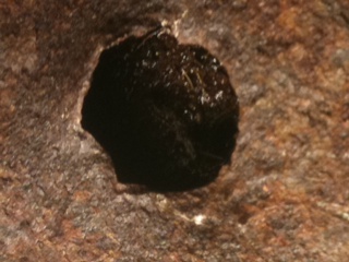

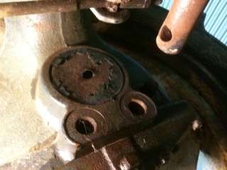

I have a D2350 with a leaking rear axle oil seal. I have the seal but am having trouble getting the cover off of the back side of the housing to access the nut and lock ring to remove the axle. It's pressed in with no lip to pry under for removal. I don't want to destroy it if I can help it.
Anybody done this before? It has the same setup as the S630 Bull, D2300 and the D2050 and maybe others. Any help is appreciated.

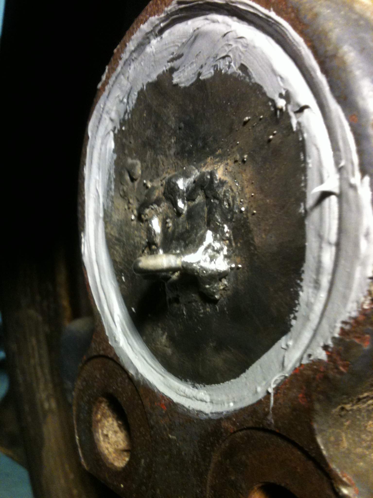

I have a service manual but the only help it gives is "remove the rubber cap". It also says to remove the rear axle housing which I don't have the equipment to do.
The plug is a little bigger than 3" in diameter and made of thin sheet metal. It seems to have an inner and outer cover as there is a small hole about 3/8" in the middle of the outer cover and there is another cover on the inside. I've sprayed some PB Blaster around the outer and maybe I can use the hole to pry the plug out. However the outer cover has a lot of rust due to the small hole and doesn't appear to be very rigid.
If that doesn't work I'll probably use your suggestion and drill a hole near the edge, insert a sheet metal screw and try to use that to pry the cover off. I'm trying to get this cover off without tearing it up too much but it's got to come off, destroyed or not.

OK, I took some pictures but I'm not too good with this stuff. May take a few tries.
Thanks
These were taken lying on my back under the tractor so it's maybe a kinda screwy angle.

Is that hole in the center supposed to be there? A trick that might work is to first find a round bar that fits that hole pretty close but still goes in easy, a ratchet extension might work. Then get your grease gun and fill the cavity under the cover full up with grease. Full, ... the more the better. Then take the round bar and place it in the hole that is now full of grease and whack it with a hammer. The pressure might force the cap off. Kind of messy though. This trick works on removing throwout bearings. It also assumes the space behind the cap is "fillable".

The hole isn't supposed to be there. What you can see through the hole appears to be the back side of the cover-double wall. I'll keep the "grease" trick in mind for future use.
