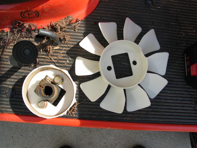

Thanks for the picture. Somehow, I managed to loose on blade of the plastic impeller / fan that cools the hydro. I still haven't replaced it. Don't figure that it will overheat in the winter months. In fact, I am not certain that one missing blade will make much of a difference. I assume that replacing the boot and replacing the fan are just about the same amount of work??

   / Need Help Removeing Bx Driveshaft #8
I've taken out my fan three times while bush hogging. I know the sound of the blade shearing off well. When you've done this a few times you can perform this surgery in 10 minutes.
Unbolt the driveshaft and reposition as far forward and sideways as it will go. Loosen the pinch bolt on the fan/driveshaft flange and slide it off. Unbolt and replace the fan blade. You will have to flex the fan blade a little bit to slide it back on the splined shaft.
Buy two fans while you are there and you will probably never need another one. I haven't broken one since I had a spare on hand.
Rich

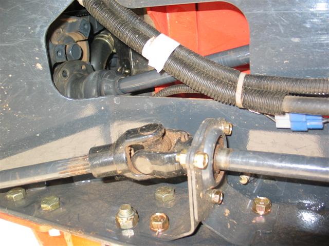

   / Need Help Removeing Bx Driveshaft #9
Here is the rear of the shaft moved to the side with the fan already removed from the splined transmission input shaft.
   / Need Help Removeing Bx Driveshaft #10
Here is a shot of the front of the driveshaft unbolted and moved to the side. These pictures represent the position to have the driveshaft in when you remove the fan/flange assembly.
