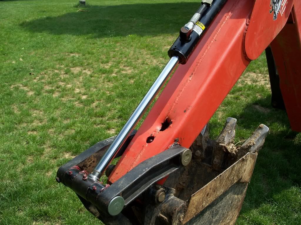

Sorry for not posting photos back when I had this problem, but here's an update. Sorry I didn't photo the rebuild; I was a little stressed and pressed for time that weekend.
After tapping the packing gland (the threaded end that the rod passes through) in as Dirthog suggested, I was able to get the retaining ring out, and pull out the entire rod/piston assembly. I cleaned the cylinder, assembled the new rod with the new piston and seals, lubed it up and reassembled the cylinder. It works great with no leaks, and I finally got rid of the stump.
In the first photo you can see the hole that was punched into the dipperstick when the rod snapped (this is after the repair).

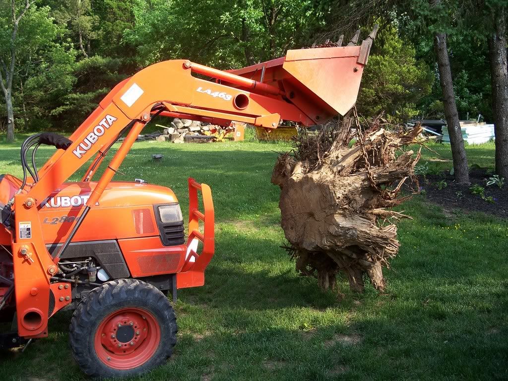

Next, rotating the stump to get a chain on it (this is before the rod broke - I think you can actually see it bowing here).

   / Need help repairing Bush Hog cylinder! #9
Wow, that's quite a hole in your dipper. Most of these CUT
backhoe attachments use only 3/16" steel for the dipper sticks.
