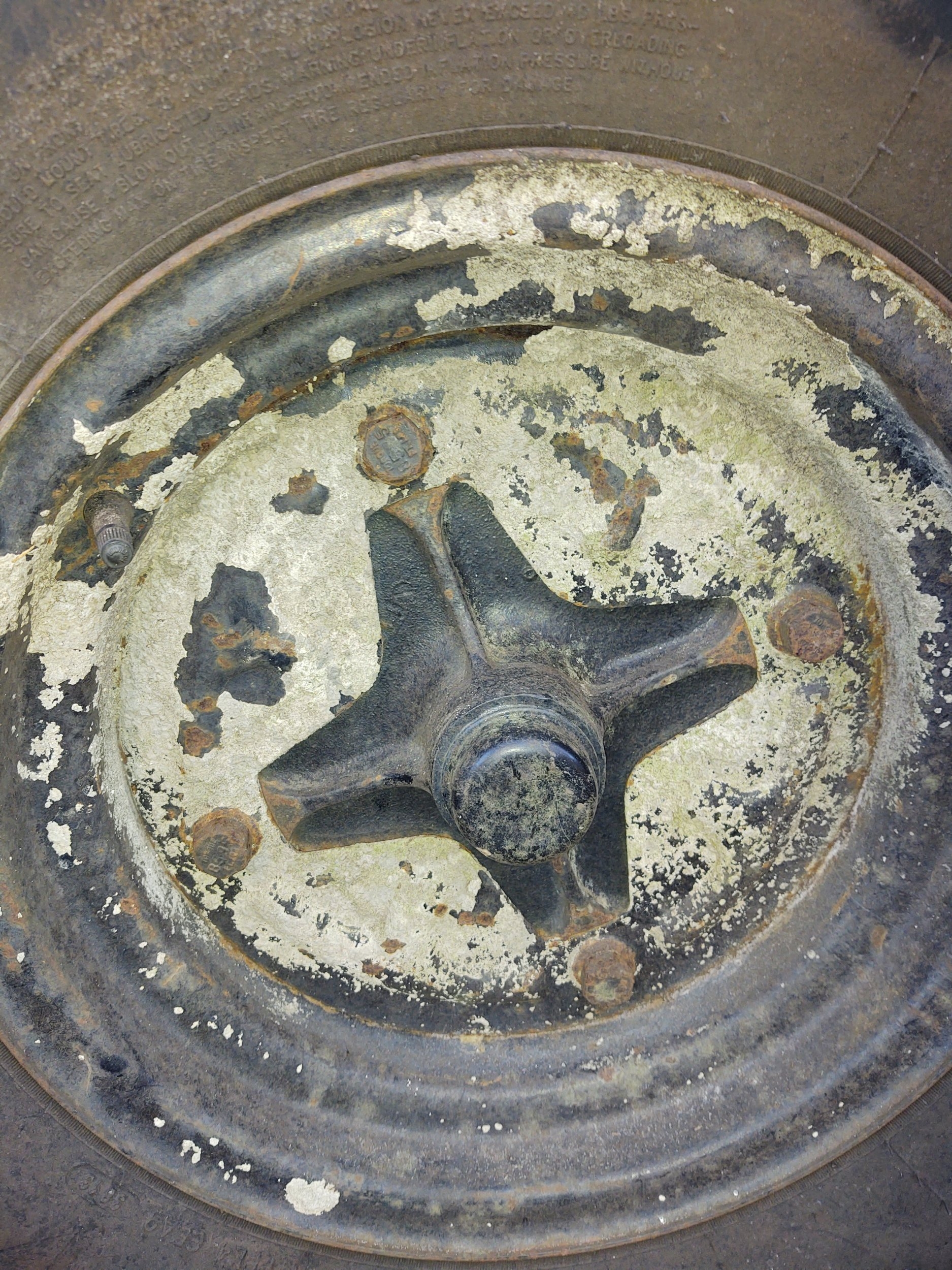

I have no idea what type of wheel/rim this is. I am told the fabricator of this trailer used it to haul a skidsteer around. My problem is it now a tire has a slow leak and I would like to replace it. I have a HF tire change station but I'm pretty sure I can't clamp it down. I could try my tire tools but I'm at a loss what to do if I can't get it off or back on.
What is the name of this wheel assembly?
Would a garden variety tire shop be able to handle it?
If not, who would be familiar with this?
Thanks for any help or guidance offered
   / Need help to ID trailer wheel... #2
Any tire shop should be able to handle it. IIRC, these were used on early travel trailers. Tire size is probably 7-14.5. Can't tell from the pics.
   / Need help to ID trailer wheel... #3
It's a Dexstar rim
