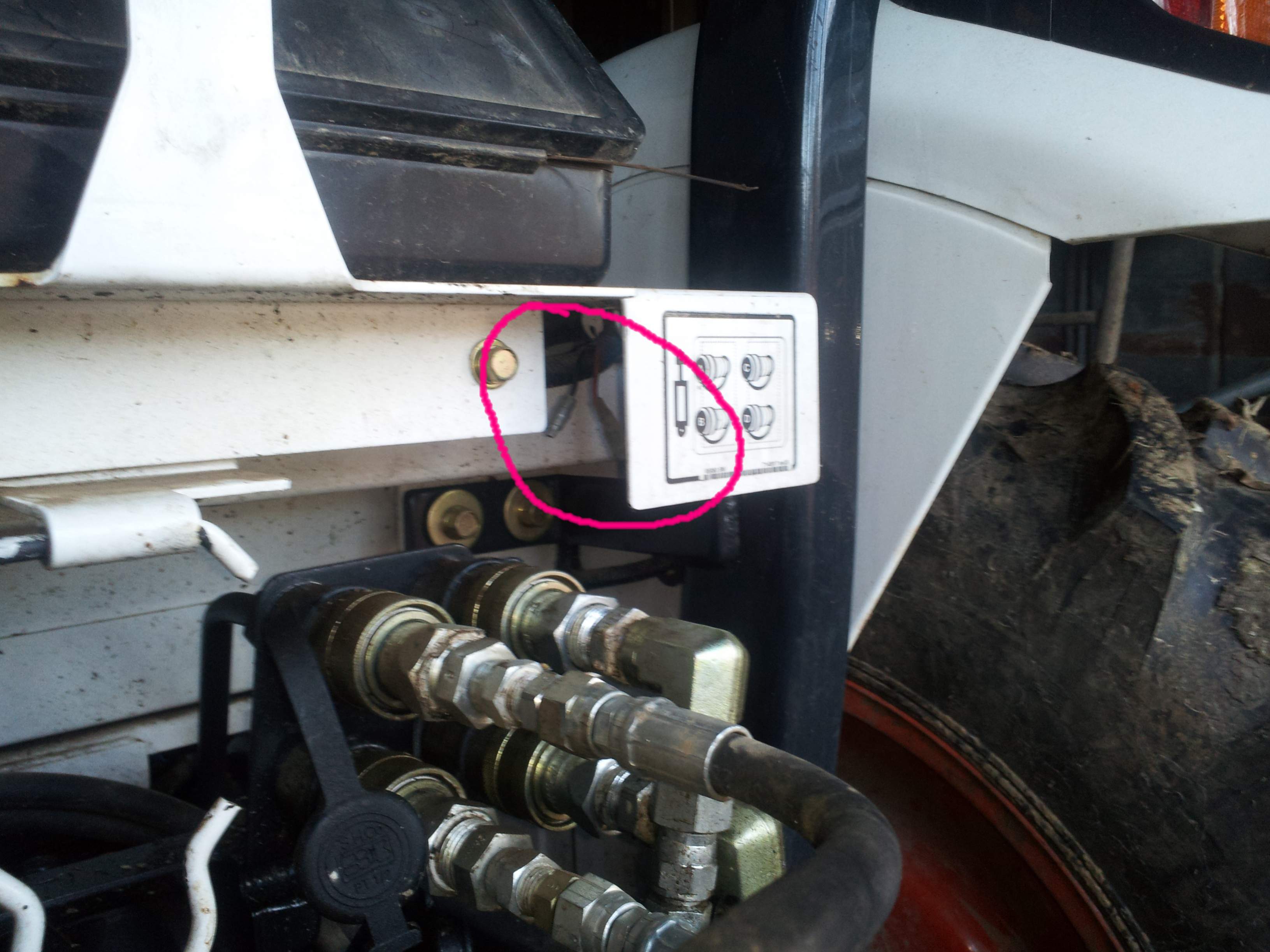

as anyone wire rear aux light? i see there is a fuse for one, is there a wire ran under seat perhaps or somewhere else or should i just use one of the spare fuse slots and run my own wire? thanks in advance for any help and merry christmas to all.
   / need help wiring aux lights #2
if there's a fuse there's probably a wire...somewhere.
On Kubota's the wire is under the fender by the tail lights and comes on with the key so the light needs a switch.
   / need help wiring aux lights #3
There is a power and ground wire wired in already. Look at right rear corner just below the tool box shelf, there are 2 wires with round "bullet" style plug connectors for rear work lights. Wire is hot, no switch, so you need to add a switch with the lights.

i have them wired and have plowed a couple times, works great thanks for the help.

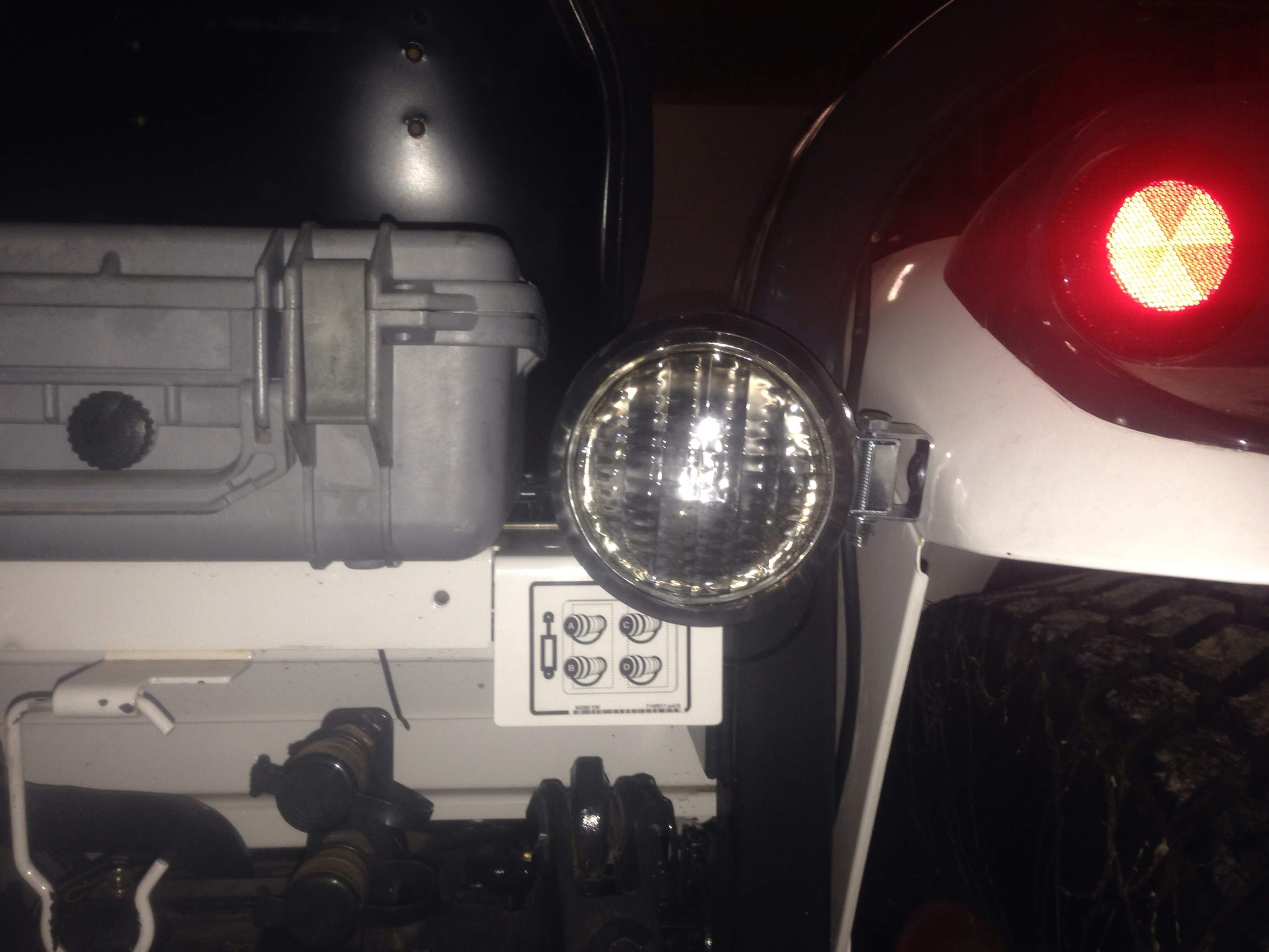

just a el cheapo from tsc but it gets the job doneimage.jpgimage.jpg.. not sure if this will work i am trying to do this from my iphone and im having trouble.
   / need help wiring aux lights #9
Looking good. Thanks for pictures. You just used some heat shrink butt connectors?
there were already butt connectors there so i greased then used them.
