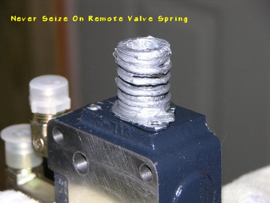

We followed Jim's lead, pulled the covers on all 3 rear remotes and painted them with a heavy coat of Never Seize. It's a thick grease with a graphite base that prevents galling and rusting on machinery.
If your remotes are even remotely close (pun) in construction to the Class IIIs you may want to consider the grease after cleaning them up some.
