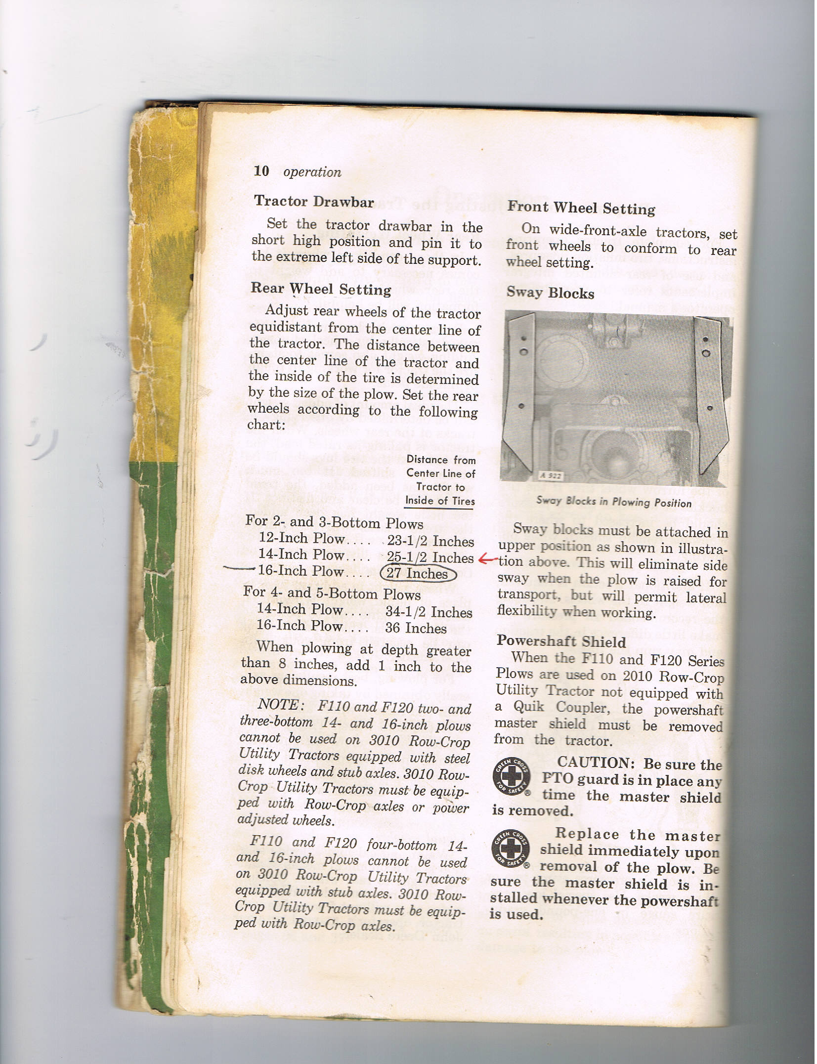

If it is a 12 inch plow, you need to set your tractor up first. You need to have 23 1/2 inches from the center of your tractor draw bar to the edge of the right rear tire. More or less a inch or so may be compensated on the cross draw bar adjustment. If you are not close to these figures, you are going to be in for headaches when trying to plow with the big cat 2 tractor. Ken Sweet

Inside edge. Ken Sweet
   / Need help with Dearborn 10-152 plow #7
Interested in information provided by Ken, regarding inches required between drawbar to inside of rear tire. Is there a guide/table showing this data? Reason I am asking is that I have JD4700, and an old plow I need information on, to set up correctly.
   / Need help with Dearborn 10-152 plow #8
The 23 1/2 inches is because it's a 2-bottom 12 inch plow. Two 12 inch bottoms = approx. 24 inches. To get your right wheel in the furrow, you want the second share to be plowing up to the inside of that right tire. Easiest way to set it up is to measure from the center of the drawbar (on the plow).
   / Need help with Dearborn 10-152 plow #9
Here is the page from the John Deere Series F110 and F120 plow manual. All plows need the tractor set the same way. No matter the brand plow or tractor. Ken Sweet
