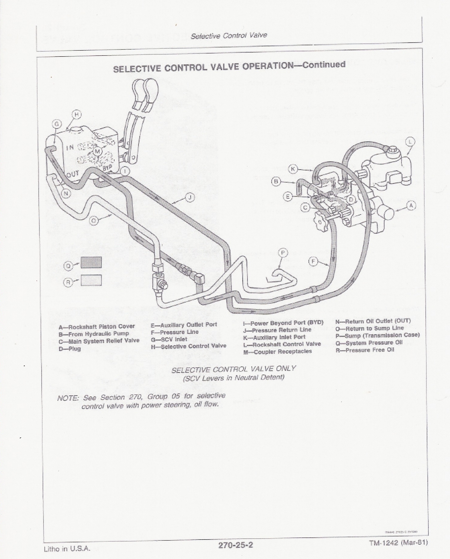

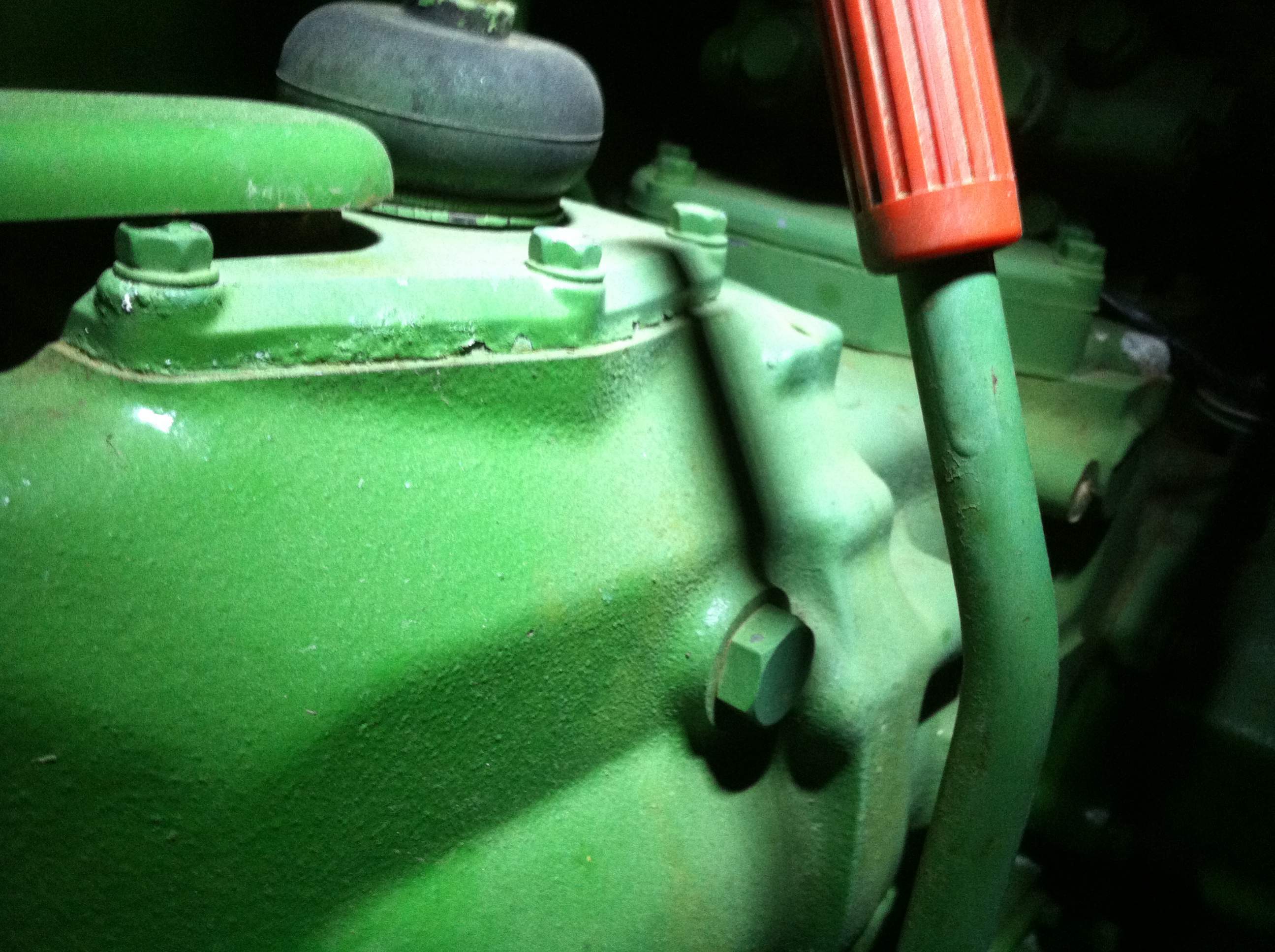

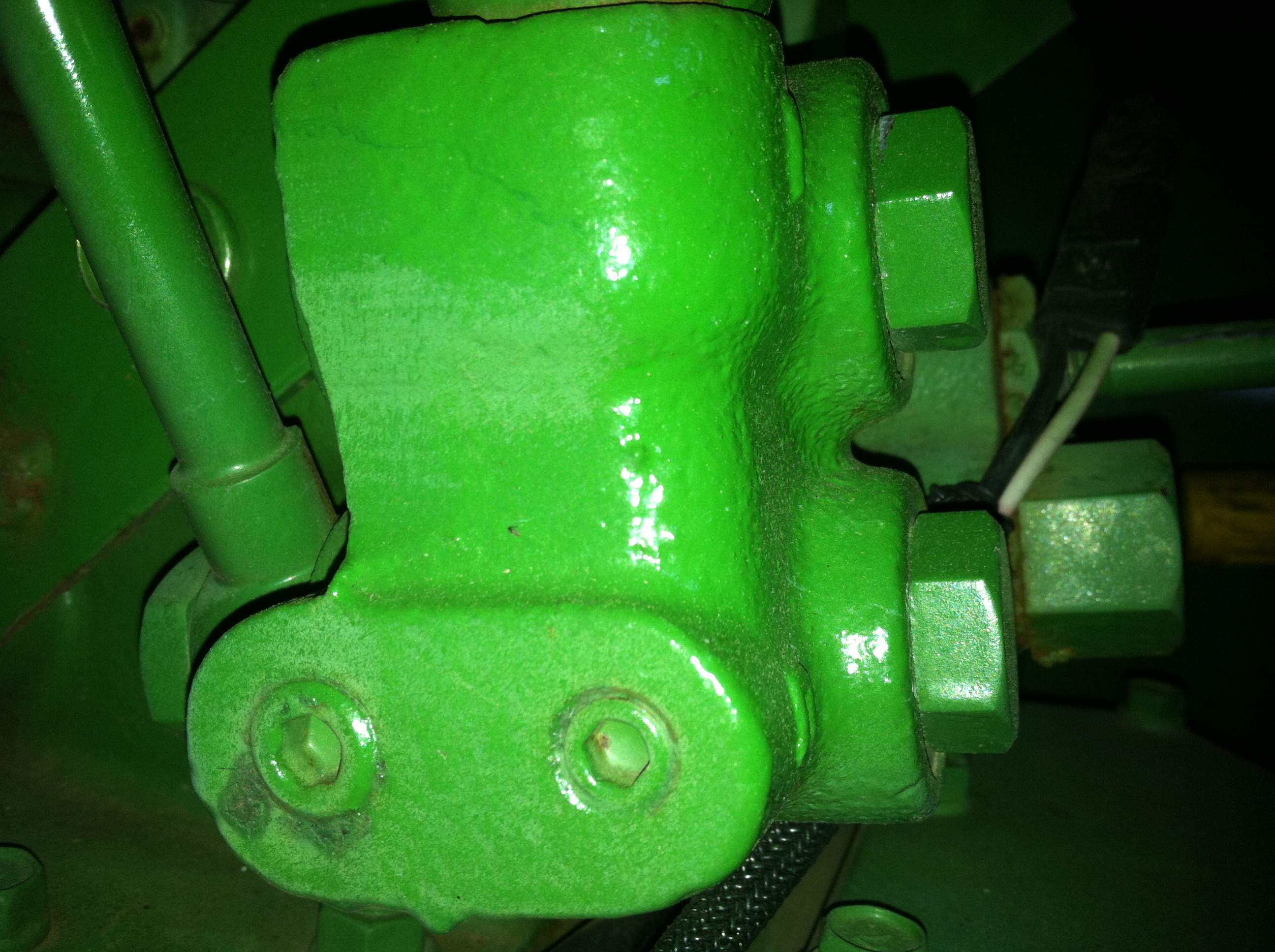

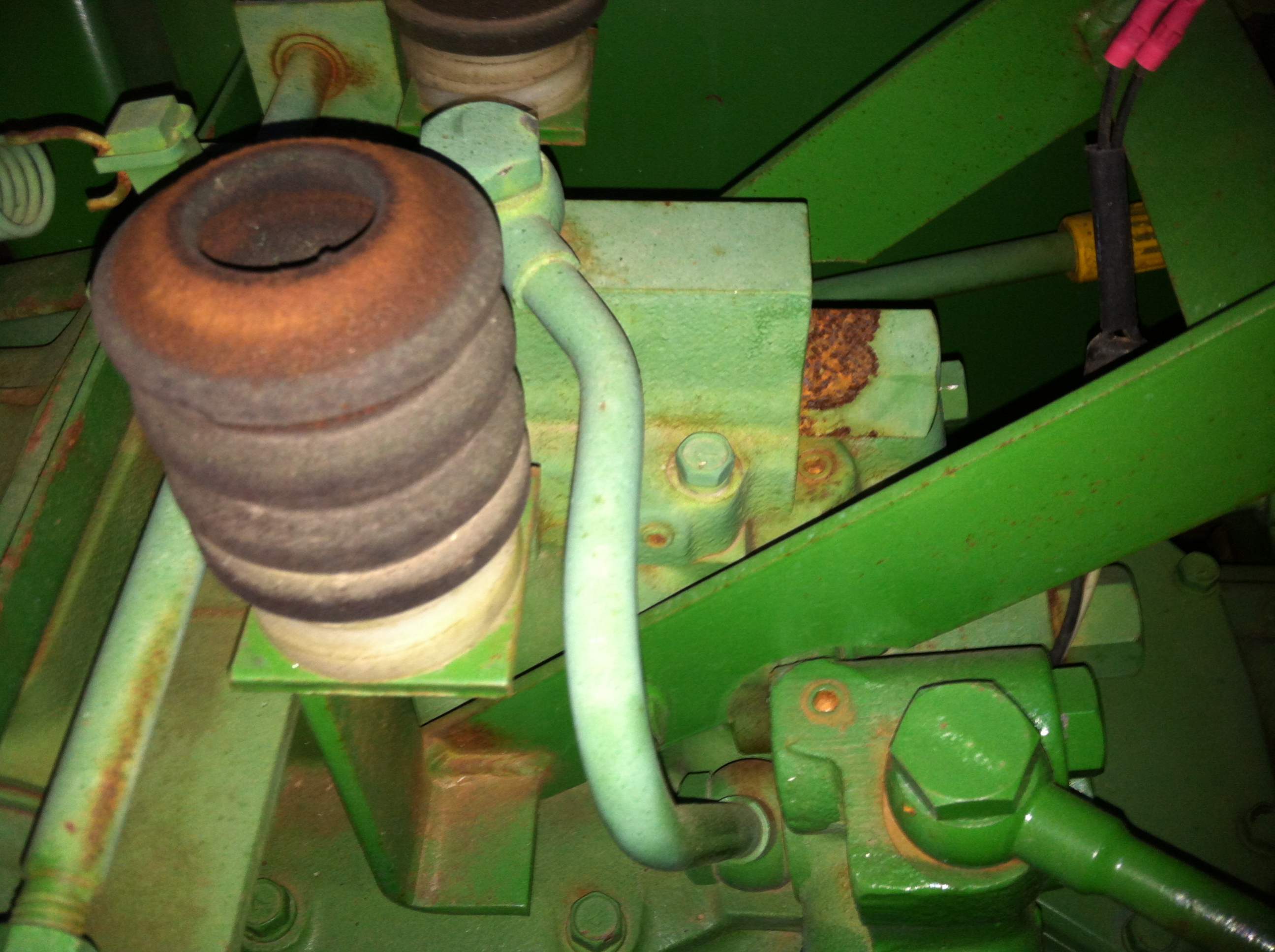

Here are some pictures,as well as the John Deere tech manual illustration.Maybe this gets us closer.

From what John DeereHere posted, your loader valve must have three ports for hydraulic lines. IN, OUT and POWER BEYOUND.
IN the next picture it shows two HEX PLUGS to the right of the vertical steel line. Top hex plug is labeled "I" Bottom hex plug is labeled "O"
From the hex plug labeled "O" go to IN port on the loader valve.
From the hex plug labeled "I" go to the POWER BEYOND port on the loader valve.
From the OUT port of the loader valve you need to find a place to return the hydraulic oil to the transmission case (sump). There must be a plug for that on the side or top of the transmission case some where.
