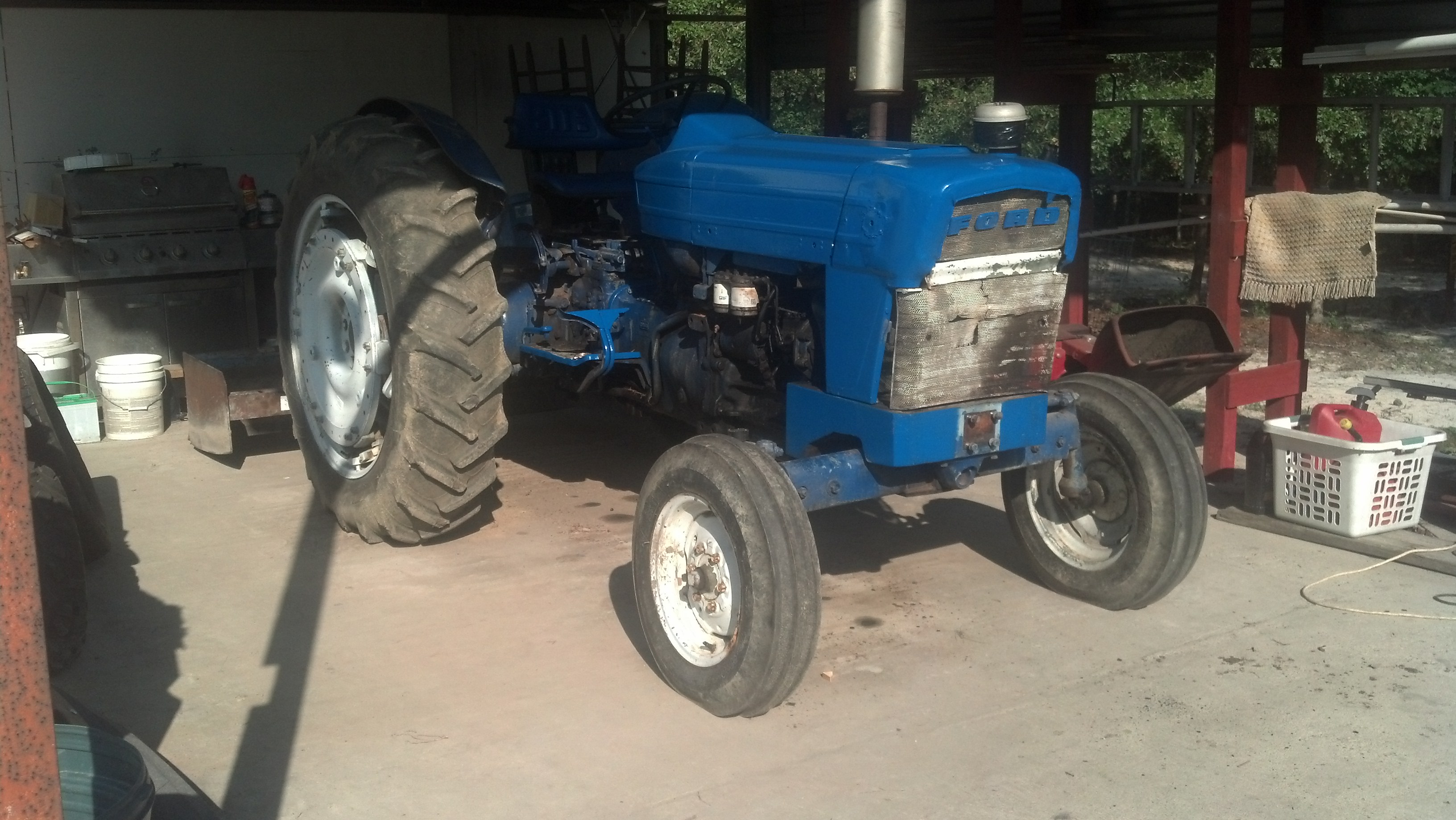

Hey Guy's,
I'm new to the site and desperately need help identifying an old Ford tractor I just purchased. When I bought the tractor the seller told me it was a Ford 3000. It was only after locating a Front Loader and driving 500 miles round trip to recognize I don't think I have a 3000. I bought a Ford 730 loader that was removed from a 3000, when I arrived in Tn and noticed the considerable difference in size of the sellers tractor from mine I knew something was wrong. Got the loader back home and realized it is going to need some serious modifications to fit. It's about a foot or so too short to reach my rear axle to mount the frame. It looks like 6" or so comes from the extended block of steel on the front that protrudes from below the radiator. My tractor is much taller/longer than the 3000 in Tn. Someone told me they thought I had a 4000 Row Crop, due to the tall tires on the tractor. The right side engine (behind the starter) has these numbers stamped:
5D30B
3 and 4 stamped on top (over) each other, then 1012C
10823551 16
It is a 3Cyl. Diesel
Any help would be Greatly appreciated!

Here's a web page for deciphering Ford model codes:
FORD CODES and SERIAL NUMBERS
However, your numbers are still puzzling to me. The 5D30B looks like a date code for Day Shift on April 30, 1965. The 3 over 4 is the puzzle. The 1012C looks to me like the model code (diesel engine, transmission PTO,8 speed), except it should start with a letter (C for 3000, D for 4000), e.g D1012C. Hopefully someone with more Ford knowledge will chime in.

Post photos of that tractor--otherwise we're just guessing.

I hope that you can see these pics well. Thanks guys. Any help would be greatly appreciated.

Looks like a mid 60's Ford 4000. Should have the 201 3 cylinder.

Its not a row crop , its the utility model , should be a tag under the hood over the battery.
   / Need help with Identification of old Ford Tractor #9
Put it on and take some pictures! It doesn't have the loovered hood so its a late 68 or 1969(or later) 4000 series with a standard front end, "If" thats the original sheet metal. There are bolts in your axle for adjustment, the industrial front axles are solid cast iron. The 4000 is a better tractor all the way around compaired to the 3000 you thought you were getting. (got one of them too). I would check the steering & everything else over really good before you install the loader, you won't be able to sevice much with it on. I'm sure you already know, Be careful when welding the loader frame, it doubles as the oil tank.
