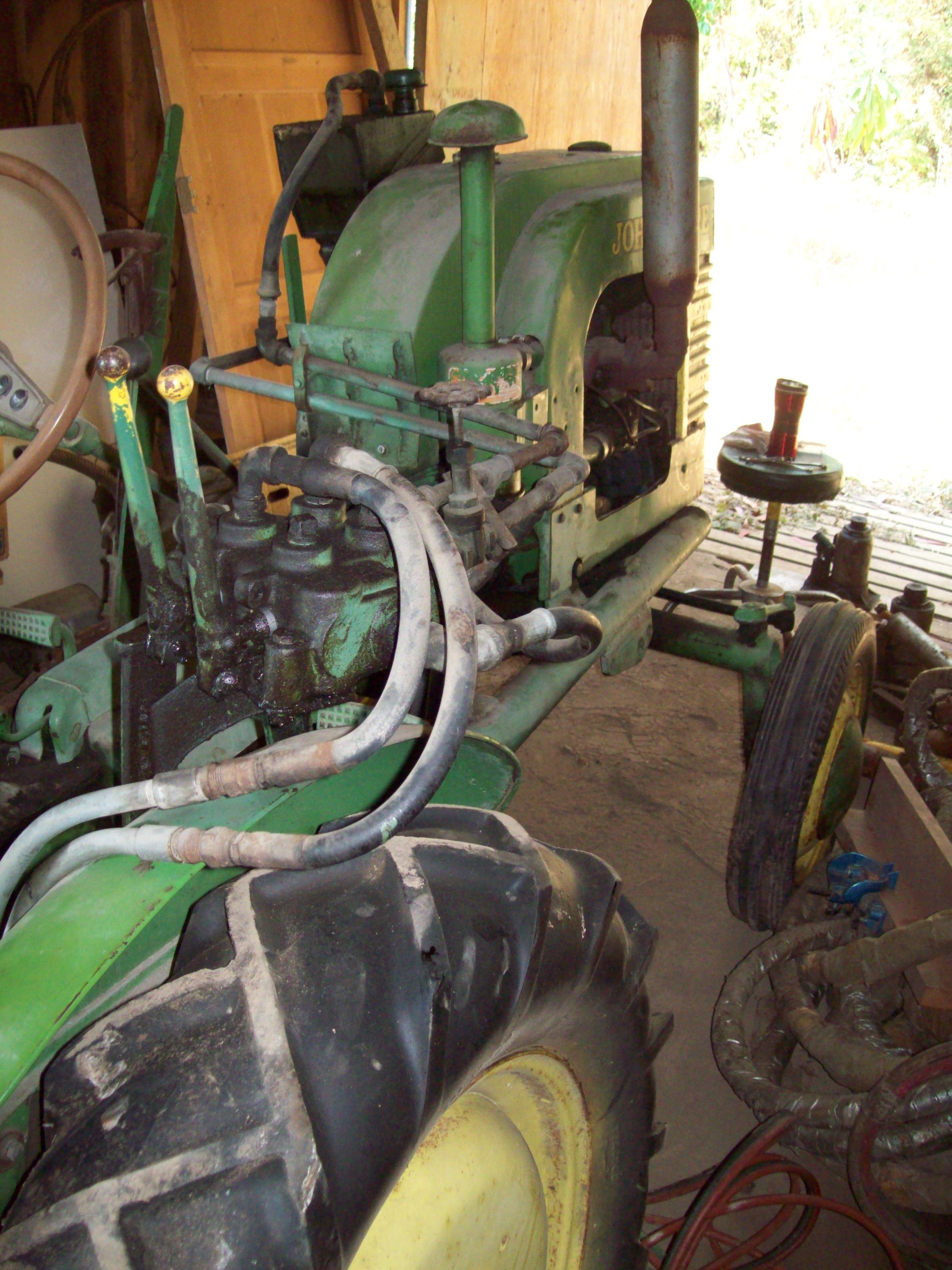

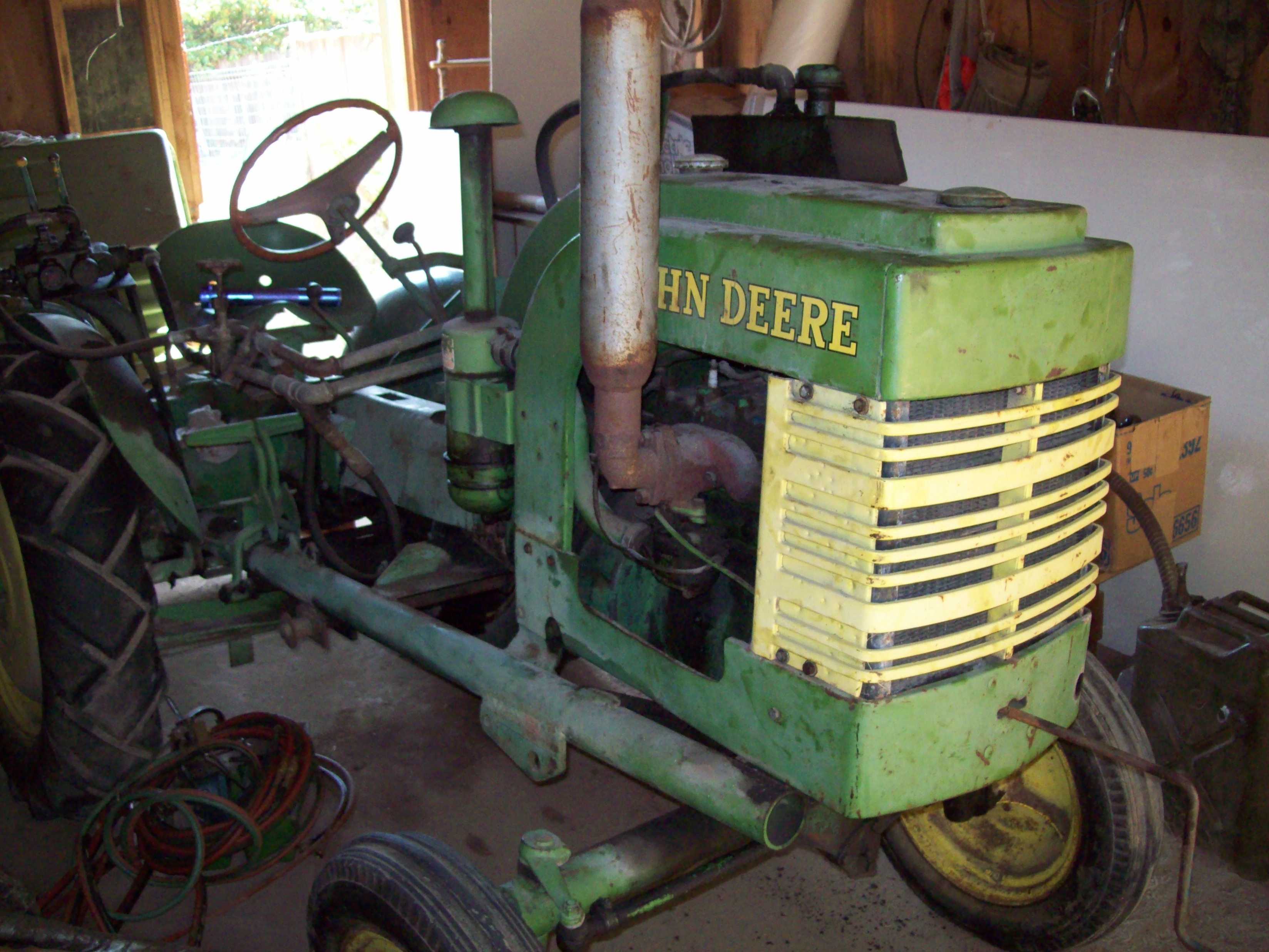

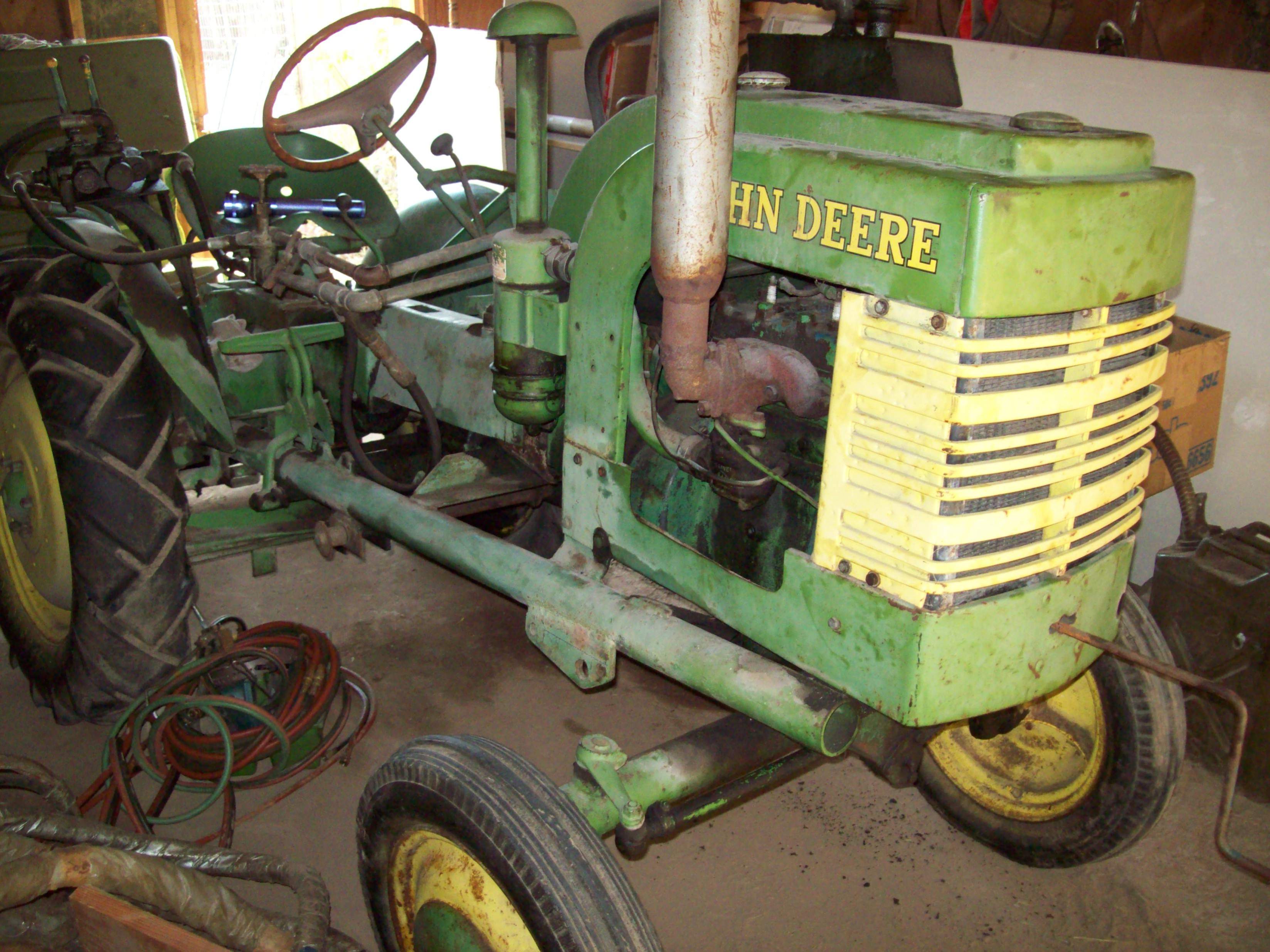

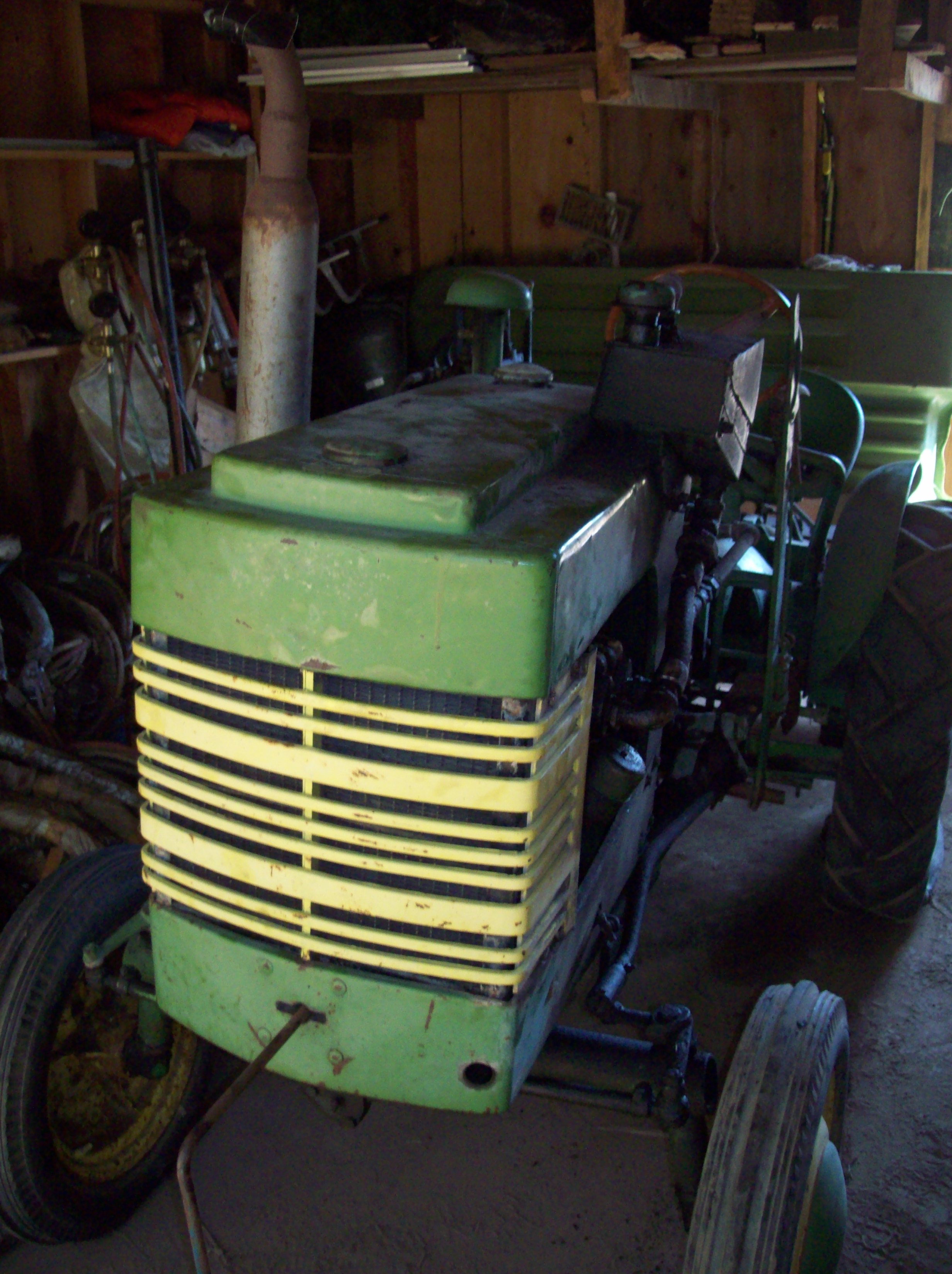

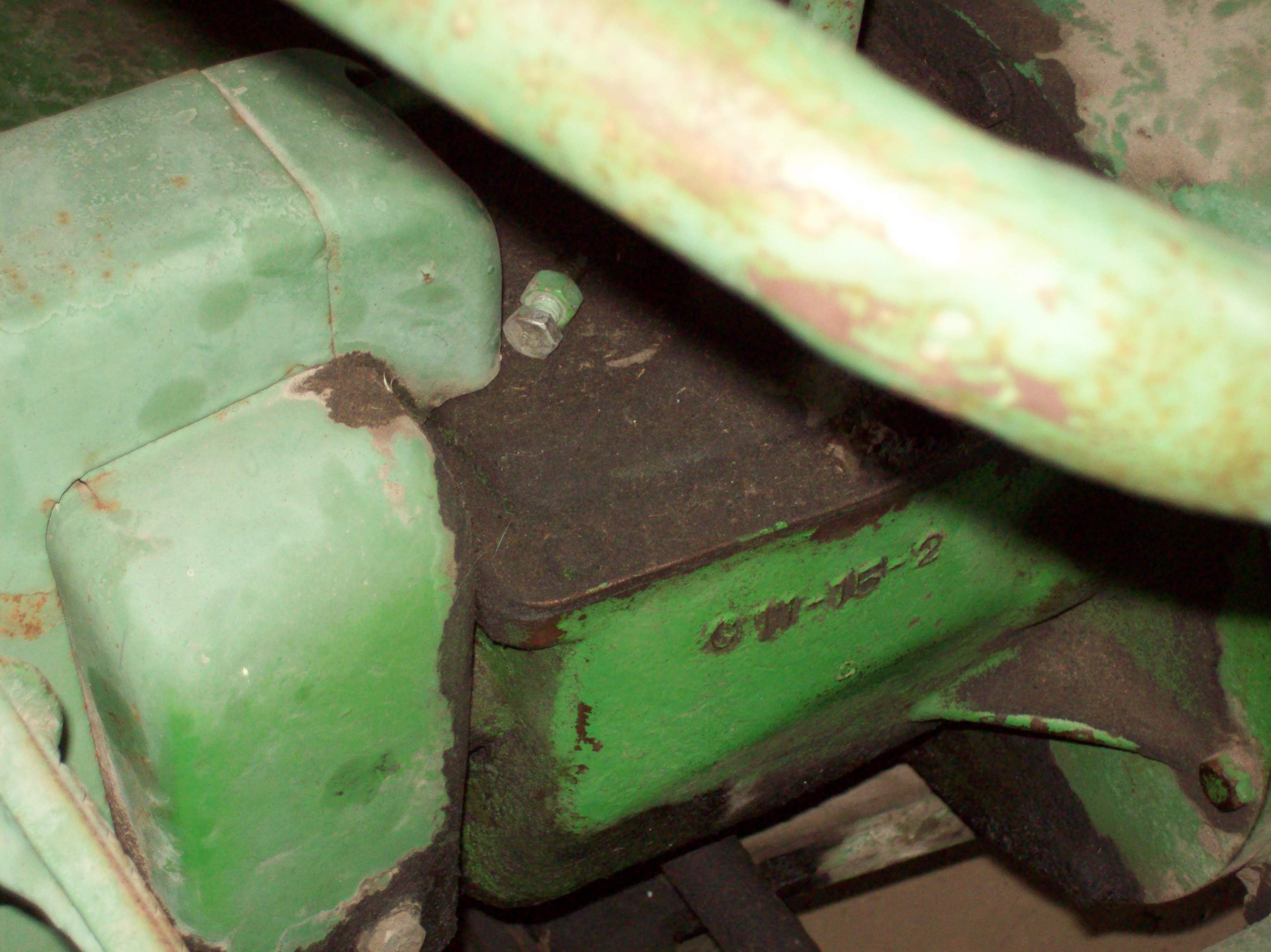

As stated yesterday, here are a few photos of the Johnny Popper. Found more
numbers this morning. On transmission housing left side C or G 11-15-2, on top of
cylinder head is L42347 and on rear right side of rear housing is AL-2092D. :confused2:

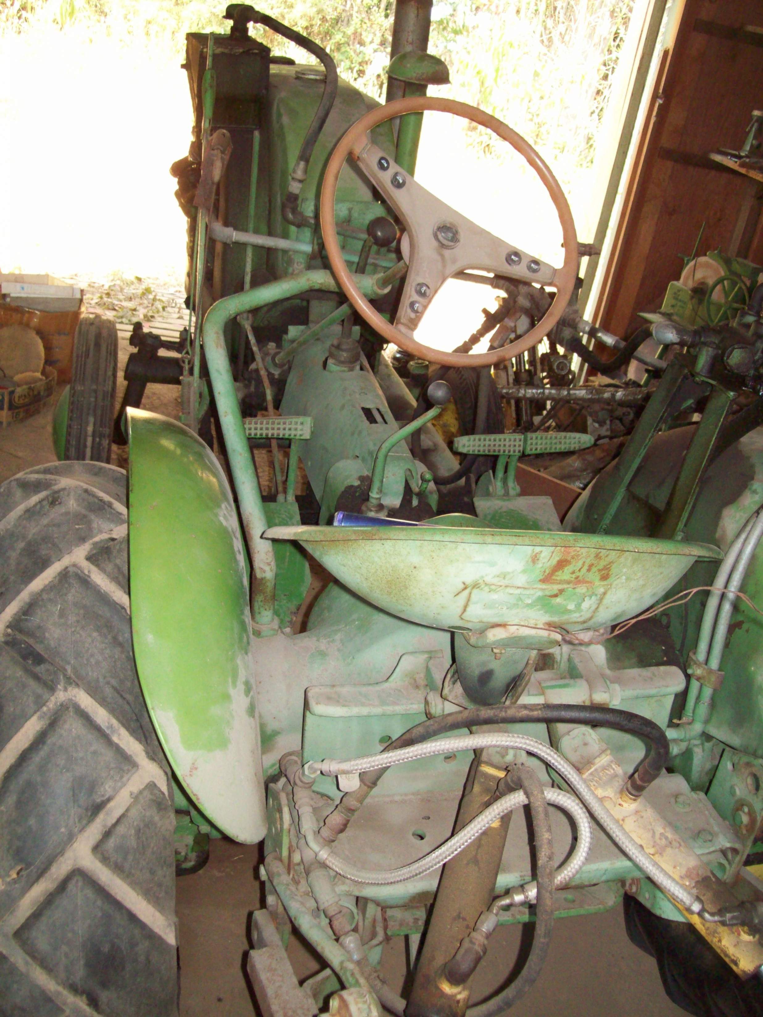

Here are a few more pictures. By the way it has 2 cylinders and uses gasoline
for fuel.:confused2:

   / Need help with identification #6
Looks like you have a L-Model. I don't know a whole lot about them, but I believe they are kind of rare and desirable.
I would check with the JD boys at Johnnypopper.com
They will probably know a lot more about them and help you quicker than we could here.
You should also be able to find some more specs listed on the L-Model over there.
Keep us posted.
Bill
   / Need help with identification #7
Here is some info I found on a quick search over there:
John Deere Model L
General Specification:
Years Produced: 1937-1946

I can't tell from photos but besides a model "L" it could be a "LA". If SN tag is still present it will be on the rear axle trumpet.

Well, Mom passed and don't really have use for nor have room or facilities to rebuild so
I guess that leaves with 1 option, sell it. What is it worth,from one site from 500 to 3500
bucks, but still don't know. I'm located on West Coast of Calif. place called Fort Bragg (no military here)
It is inside now, it was under cover (shed roof) for years. Has hand crank start and some mods that my dad did
( bolt on hydraulic pump and remote as you can see from photos). Any reasonable offer will not be refused as I
trucked it down from Washington state (1000 miles). I have a 2010 Kubota B3200 and don't really need this.
