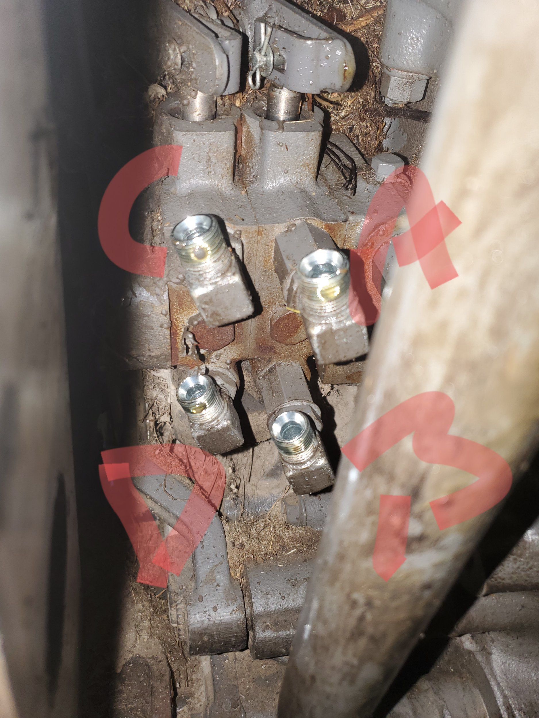

Busted hose under tractor between pump and quick connects for ladder
does anyone know if this lines up right with A - D at quick connects? Thanks

Not sure if I understand your question, but A and B are a pair, and C and D make the other pair. One pair does the curl/dump functions. The other does the lift/lower function.
   / Need help with MF 1736 hoses #4
Sections of the valve typicaly go to the same pair of ports/cylinder. So like PSTG said A/B is a pair and C/D is a pair. You wouldnt typicaly cross baby bodies on the same cylinder.

Thanks for replies. Was able to get hoses replaced and everything working properly.
