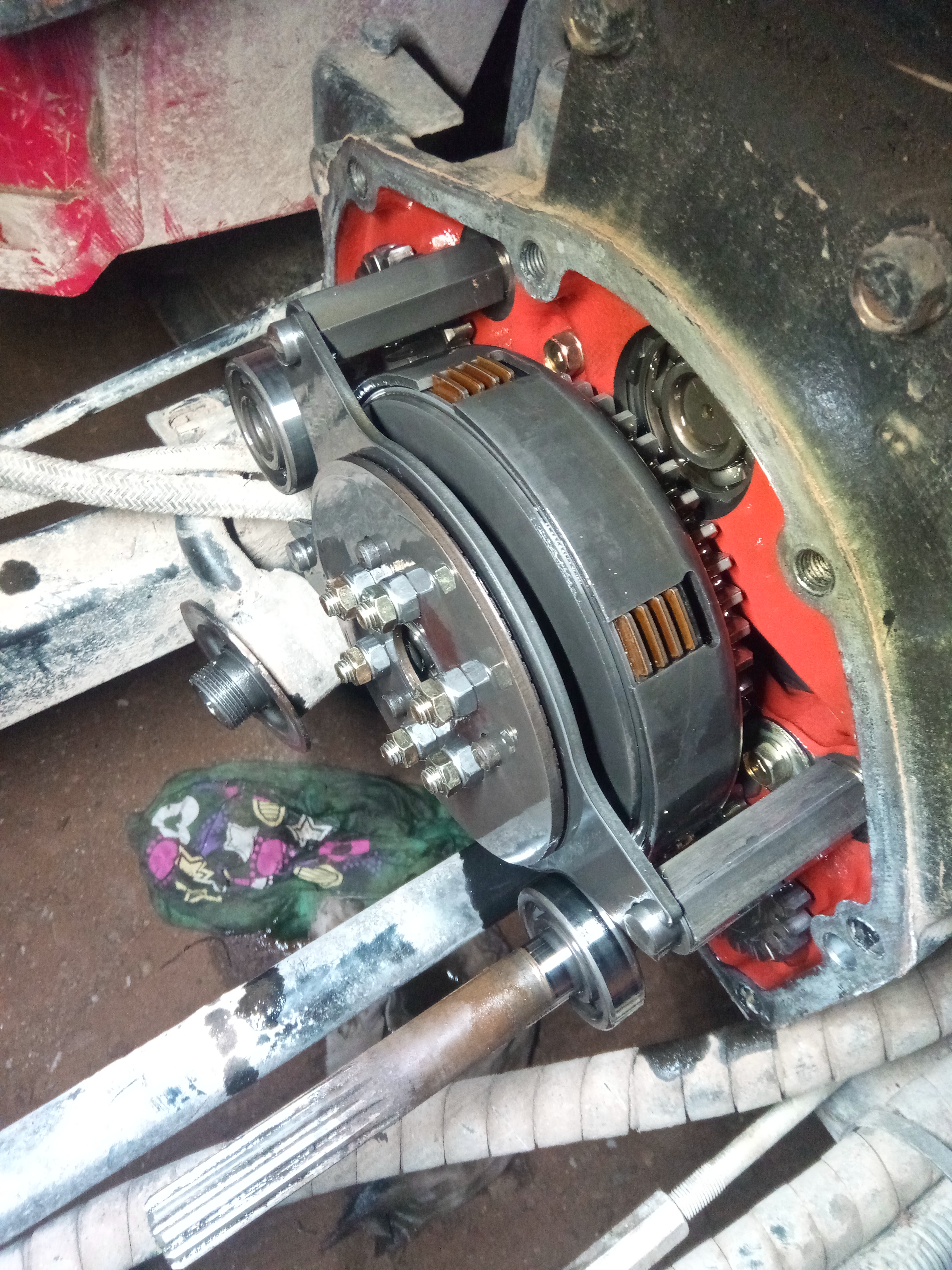

My MT 185 wet clutch will not disengage . I have adjusted the clutch rod as far as I can but cannot get it to disengage! Any ideas!! Oh this is a wet clutch!
Thanks
   / Need Help with mitsubishi MT 185 wet clutch. #2
From the parts book it is hard to tell how it works. I think you will probably have to split the tractor. I would suspect an internal problem.
   / Need Help with mitsubishi MT 185 wet clutch. #3
Hello, did you manage to solve the issue with MT185 wet clutch? I have problem with Mitsubishi MTX225 wet clutch. Do you have any advice how to adjust and disengage the clutch?
