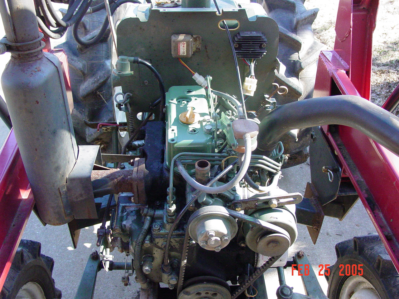

Well, I'd follow tractorernie's advice, just take the old one to NAPA and buy a replacement. You have to install the belt before you can put the lower hose back on. Other than that, there's no secret way, it just slips over the fan blade, onto the pulleys and tighten her up. Don't remember for sure what size, but it will have metric fasteners on the alternator adjustment, seems like the bottom one was 17mm (wrench size), but like I said, I don't remember for sure.
Nothing wrong with letting Stan know, but I'd go ahead and get her fixed now - this is an easy one to do...........In this pic you can just see the lower mounting bolt at the bottom of the alt, it does look to be 17mm. BTW, the belt you see in this pic is not the right one, it's too big and sits too high in the grooves on the pulleys. Get the right size by taking your old one with you. This is on my 1602D, which I'd guess is the same setup you'd have........
