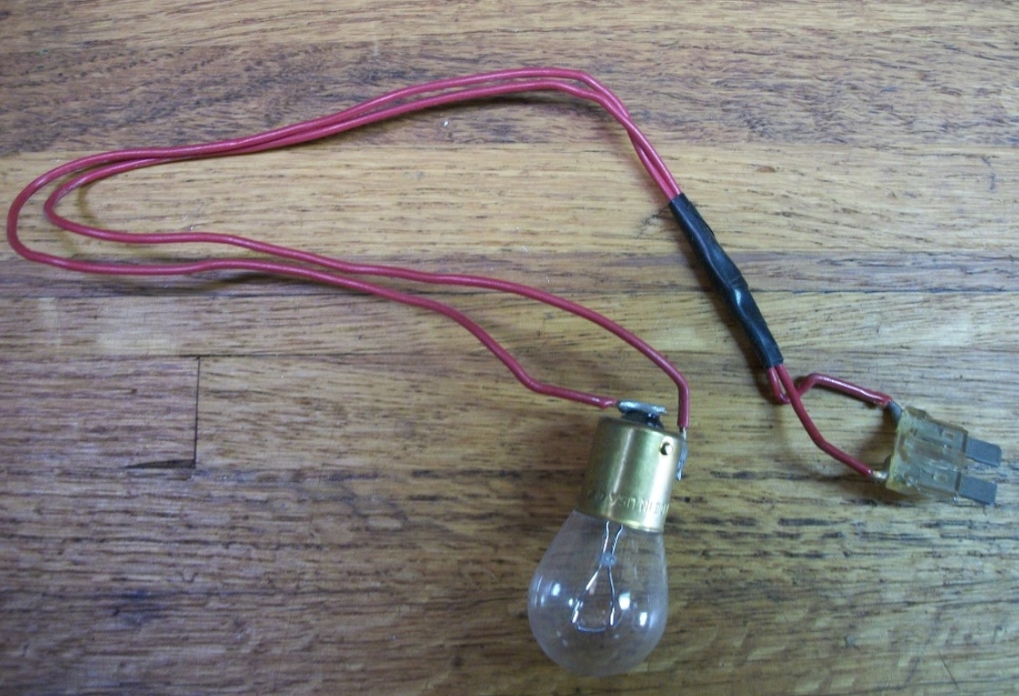

Fix up a 12v light bulb to a blown fuse and insert into the slot. If short, then the bulb will be lit and stay lit until you find the cause of the short. Methodically disconnect wires, and/or move them around to get the bulb to go off.

I've inspected most of the cables and noticed that one of them had a damaged coating and most of the conductor wires were also damaged. This particular cable is situated near the rear PTO, which the previous owner had removed when I purchased the mower. The wire adjacent to it also displayed some signs of damage, with a slightly crumpled insulation layer. It's likely that I hit something there, or perhaps some critter had a little too much fun.
I dealt with the problem by cutting off the defective sections of both wires and then reconnecting them, twisting the wire ends together, and sealing it off with electrical tape (img link) Admittedly, this is a temporary and somewhat crude fix, but it did the job. The motor managed to start up without a hitch twice yesterday and twice again today.
However, I'm not entirely confident that this was the root cause of the issue - it could just be a coincidence. Given that I've had starting troubles for most of last year and fuse issues this year, I'm going to stay vigilant. The other issue I discovered were a couple of wires under the seat that were being pressed against some metal by a plastic tie. I've loosened that tie - the insulation looked more or less intact, but it was extremely tight, so perhaps that was contributing to the problem.
