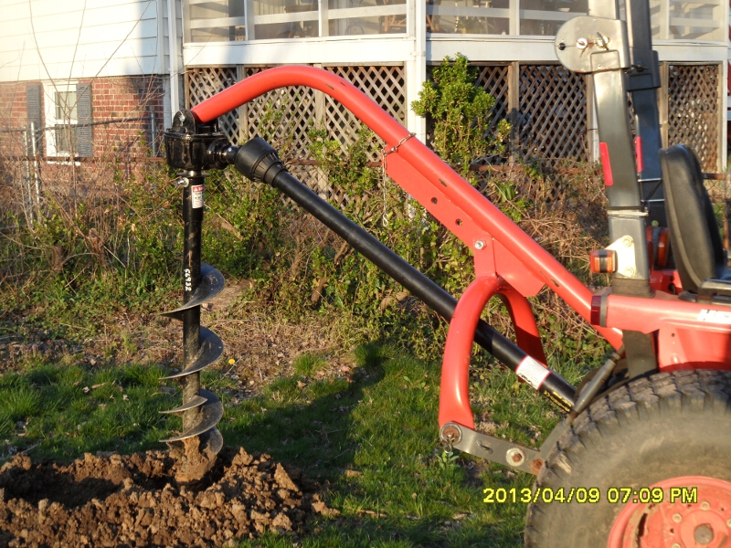

Quality - The metal looks good, heavy. The paint job is less than adequate. It's like an afterthought. Big drips, bolts painted solid. Almost reminds me of a rattle can paint job.

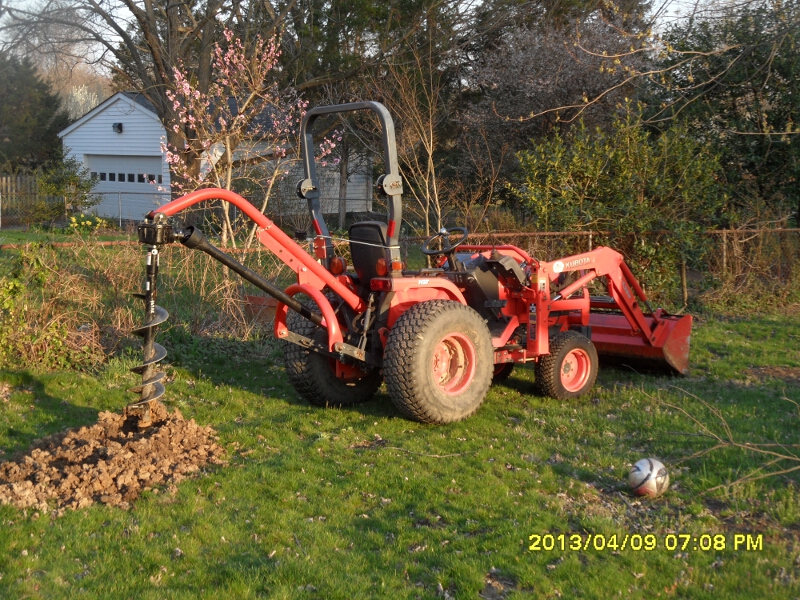

So I put it together and found that everything fit and with my 3 PT raised to the max I had about two or three inches of clearance for the point of the auger to miss the ground
Drilled several hole in fairly soft soil. Seems to work well and a good bang for the buck.
I've only used it a few times and it has done fine.
