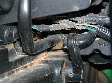

OK, I took a look at the back of the tractor trying to find where to access the hydraulics. There is a hard hydraulic line across the top of the rearend that runs from the loader valve to the other side of the rear end where it ties into a fitting.
Would I be correct to say that where the pipe connects to the loader valve is a pressurized power beyond port and the other end of the pipe is the return?
If so, I assume that I can tie into the PB port and run that to the "in" port on the new valve for the remotes. The return line would run from the "out" port to the return port on the rearend of the tractor.
Does this sound right? If it isn't right, I guess I still need someone to tell me where to tap into the hydraulic system.
Thanks!
Steve

   / Need help with rear remote setup on a JD 4300
picture of the left side of the hydraulic pipe (return?) facing the back of the tractor

There is a discussion somewhere on this site about that hydraulic line, as it has a screen in it that could plug and there is a Deere upgrade for older set-ups. My dealer said mine wasn't a problem. I'm not sure, but there is a schematic I think on here somewhere. If I find it, I will post it.
