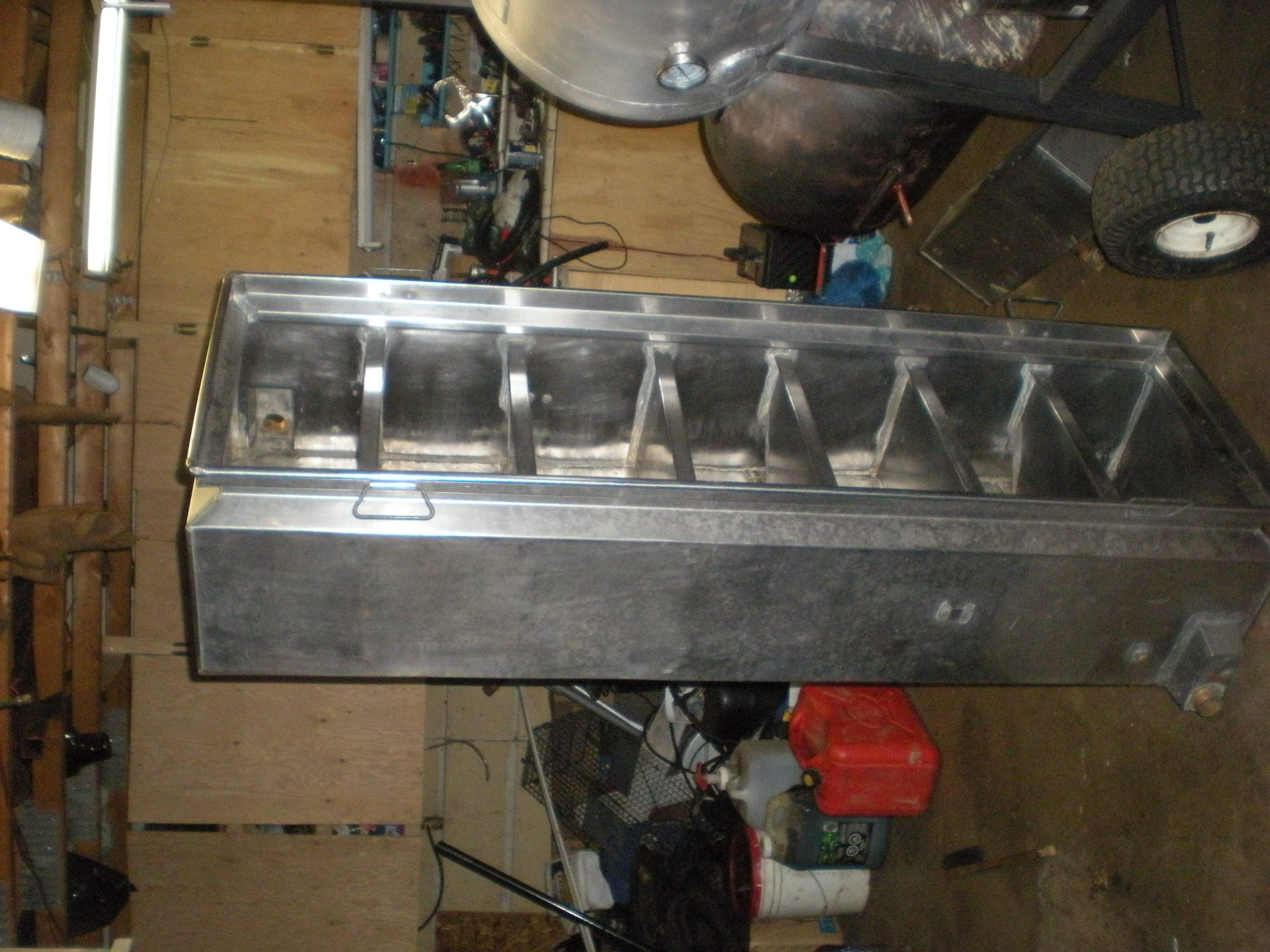

finally got to post a pic...what do you guys think

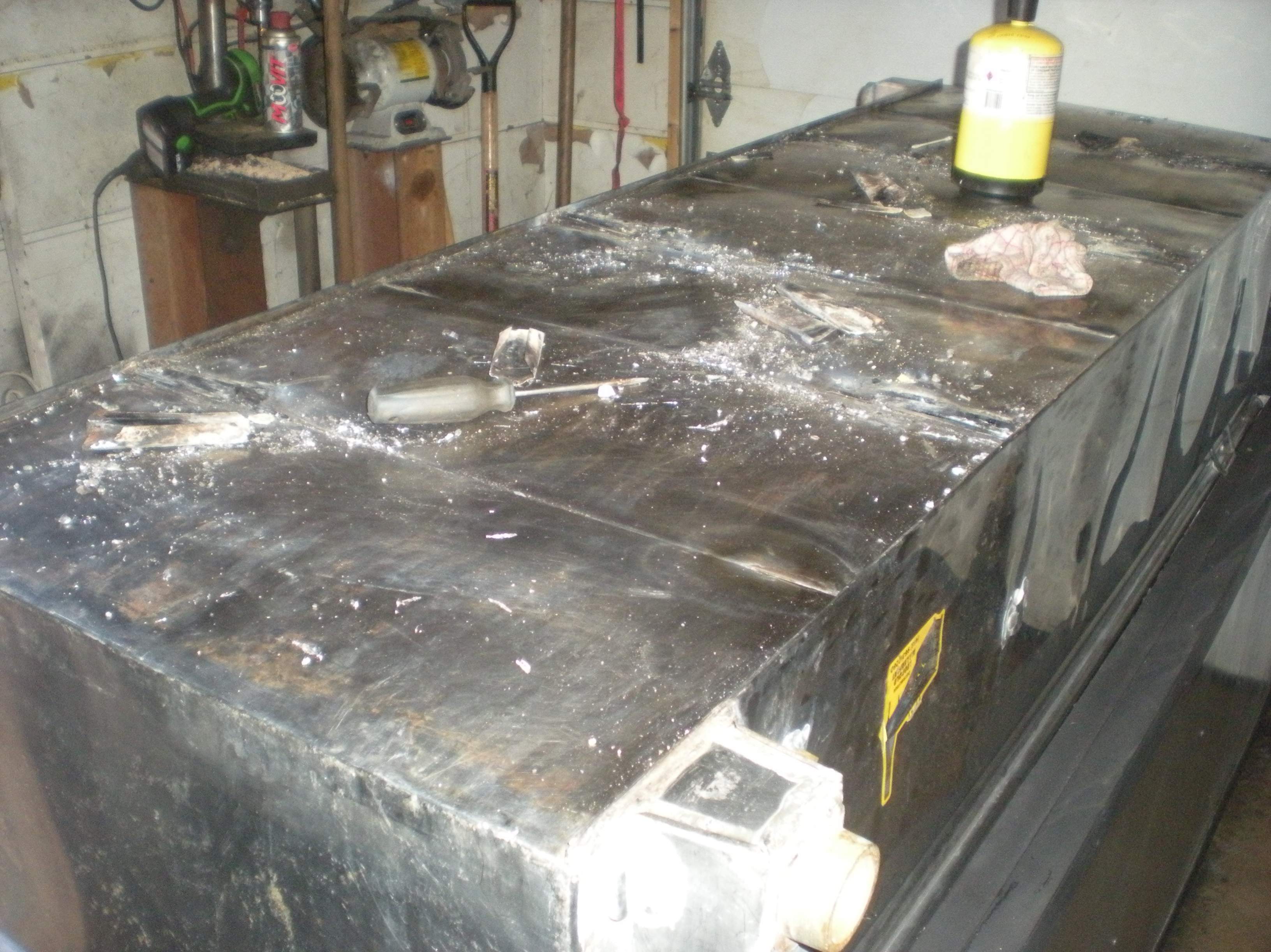

another one ..this is me taking out the old solder

$1500 isn't a rip off price...
Stainless isn't cheap, isn't easy to work, requires experience to prevent burning the nickle out of the metal, then allowing it to rust.
Since some s/s is acid resistant, and the lead isn't, I would look at hydracloric acid is eat out the lead, but beware the fumes are going to be extremely harmful. Extreme amounts of ventilation and skin/eye protection. (guess that scared you off!!). If you have a business nearby that does galvanizing or uses acid tanks, you might get the tank dumped for a six pack or small bribe.

Hey people..I bought a used maple syrup evaporator...Problem is i only noticed when I got it home its soldered together with 50/50 lead solder...What can I do to get this solder out and either resolder with lead free solder or tig weld it...Cant make or sell maple syrup with lead in pans and 1000.00 to 1500.00 for new ones

sorry I was talking about the welding shop that wanted to charge me 5500.00 to build me pans..The pans I have are at a good friends fab shop that builds ss range hoods as we speak for 100.00..good deal

Or unless his friend is just burning out the solder and and re-welding. But still, for $100 and the size of that pan....
Theres a good 4 hours of TIG-ing just re-welding all the seams. Nevermind burning out the solder:confused2:

yes he's a really good friend..He was my best man at my wedding...he's only charging for material..I had to burn out the solder and he's welding it up...he's also building me a hood for 200.00 and i'll hang a preheater....its great to have good friends
