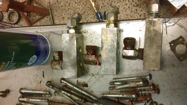

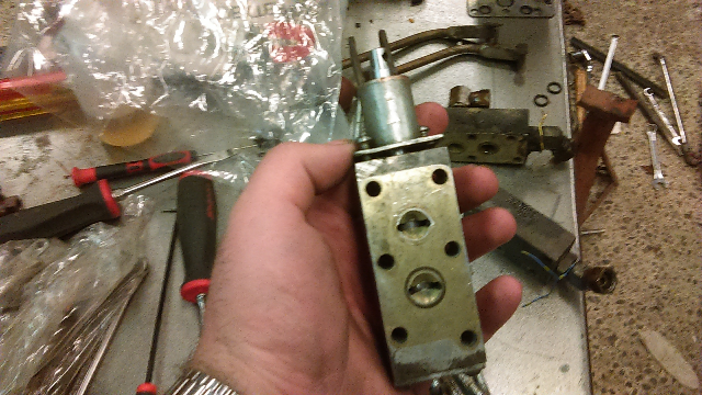

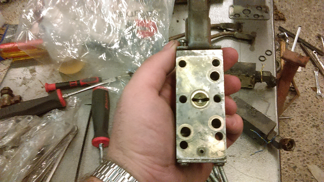

Hey guys, I'm trying to locate a replacement remote valve for my 3500, but I don't see any manufacturer makings on it and the parts manual doesn't have this type. Does anyone recognize these? They are in a bank of three mounted on a manifold mounted on the top cover of the rear end.

Those are Gannon Gold Seal valves, originally called McGee valves made for the top and tilt with hydraulic ripper box scraper. Woods Equipment bought Gannon and sells the parts for them. Popular on the West Coast, but should be able to purchase through any Woods dealer.
I have included the Messicks parts link from their online parts book as it shows the kits for the orings that were are not in the original book.
Valves Gold Seal | Messick's

THANK YOU!!!! I seriously owe you a case for that. And another case for your help with this thing two years ago when I joined this forum. That is exactly what I was after. Out of the three valves, the only one that would return was the one that the cover was loose on and puking oil all over. Loosen the screws and they felt good, tighten them and they bound up. It's like the cover with the handle attachment is not bored perpendicular to the mount surface or the stem on the spool is bent. The hydraulic guy got two to work, but the spools are in 90 degrees off, and said the one that I found the broken snap ring on is cracked. I'm getting really tired of everything being broken/ worn out/ neglected beyond belief in this tractor.
